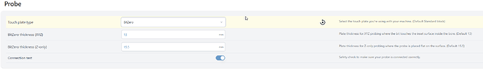

Good day. This question may have been answered on the forum here already but I’m missing it apparently. I am using gSender with my carbide 3D machine and was wondering if there is a macro available from Sienci Labs that will allow me to use my bit zero version two when I am using the gSender software?
Welcome to the group @Jerry!
I’m not positive but this might be what your looking for. I did a quick read of the macro and it looks like what you’d need but I’ve been wrong before! Calling @NeilFerreri, come in Neil. He wrote those macros so I’m betting he knows for sure.
gSender was started from CNCjs so as far as I know the syntax of those macros is correct for gSender.

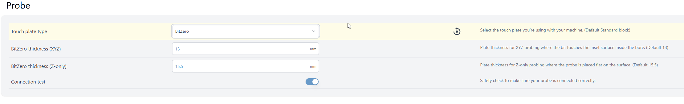

Even better news, in Edge-5 and soon 1.6.0, the bitzero routine is available within gSender.
