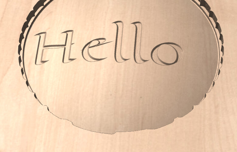

What CAM software are you using? Vectric vCarve will let you create a toolpath that is projected on a model surface.

That makes it easy then. Simply select the “Project toolpath onto 3D model” option when you create the toolpath for your text.
@tiermanc The advice that @Chucky_ott provided is correct provided that you either created or imported a 3D model into VCarve. How did you create the curved surface that you want to carve into?

@tiermanc In order for VCarvePro to carve on that curve, it needs to “know” what the curve is. Since you have vcarvepro, you cannot create a 3D model. You may, however, be able to use one of the clipart bowls if the arc of the bowl is the same as the arc of the page holder. If that works, you simply create a toolpath for the “bowl”. You don’t carve it. It’s just there so that vcarve knows the arc of the piece,that you want to carve the text into. That’s what “project onto the 3D model” does.
