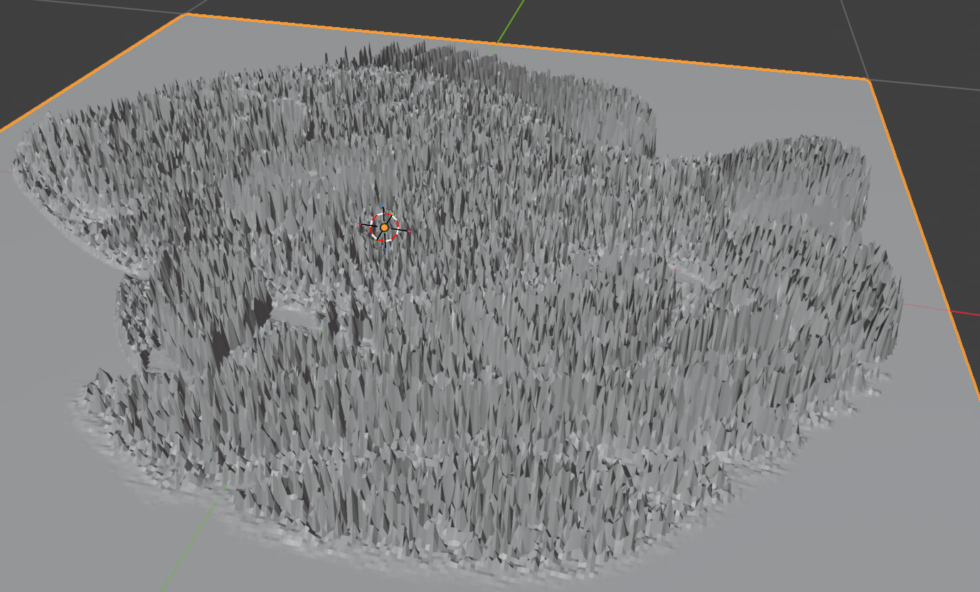

Is it possible to use ChatGPT for generating relief images for CNC? I know if doesn’t create STL files and gCode directly so I was following some tutorials and using Blender to attempt to convert greyscale height map image to a mesh that can then be imported into Fusion 360.. but in Blender it appears the images ChatGPT creates are not correct.. here is what I get in Blender:
I think this is because the image generated has speckles of different grays mixed throughout the picture:
Is there any solution for this?

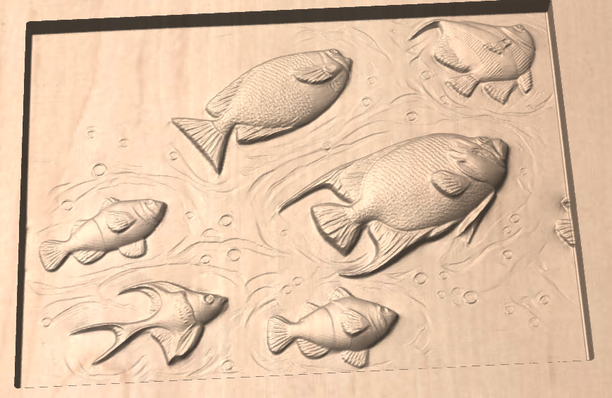

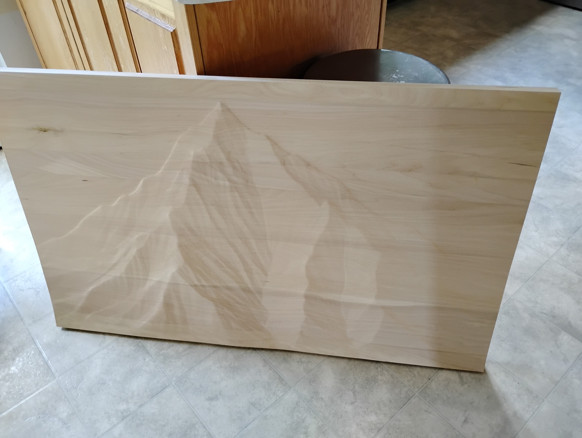

@DavidB Yes, I used both. For True Depth, you need to start with a picture and if that has too much detail, True Depth may not give the results you want.
Easy Create is much simpler. You can use a photo or just give it a text description of what you want.

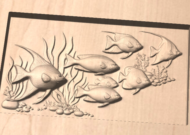

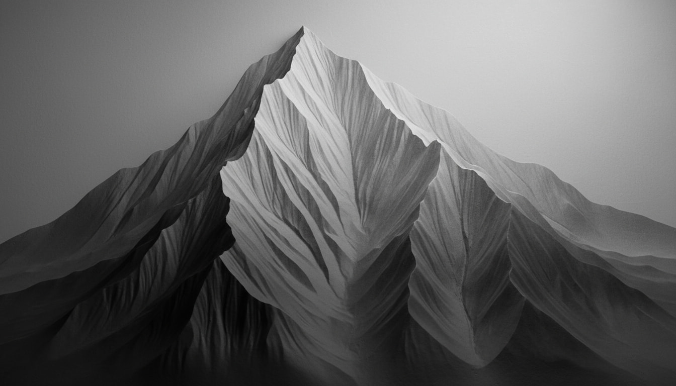

Here’s the mountain it did from my text request for “a mountain peak with good relief but not too much fine detail”
And two fish models it did but which I didn’t actually carve.

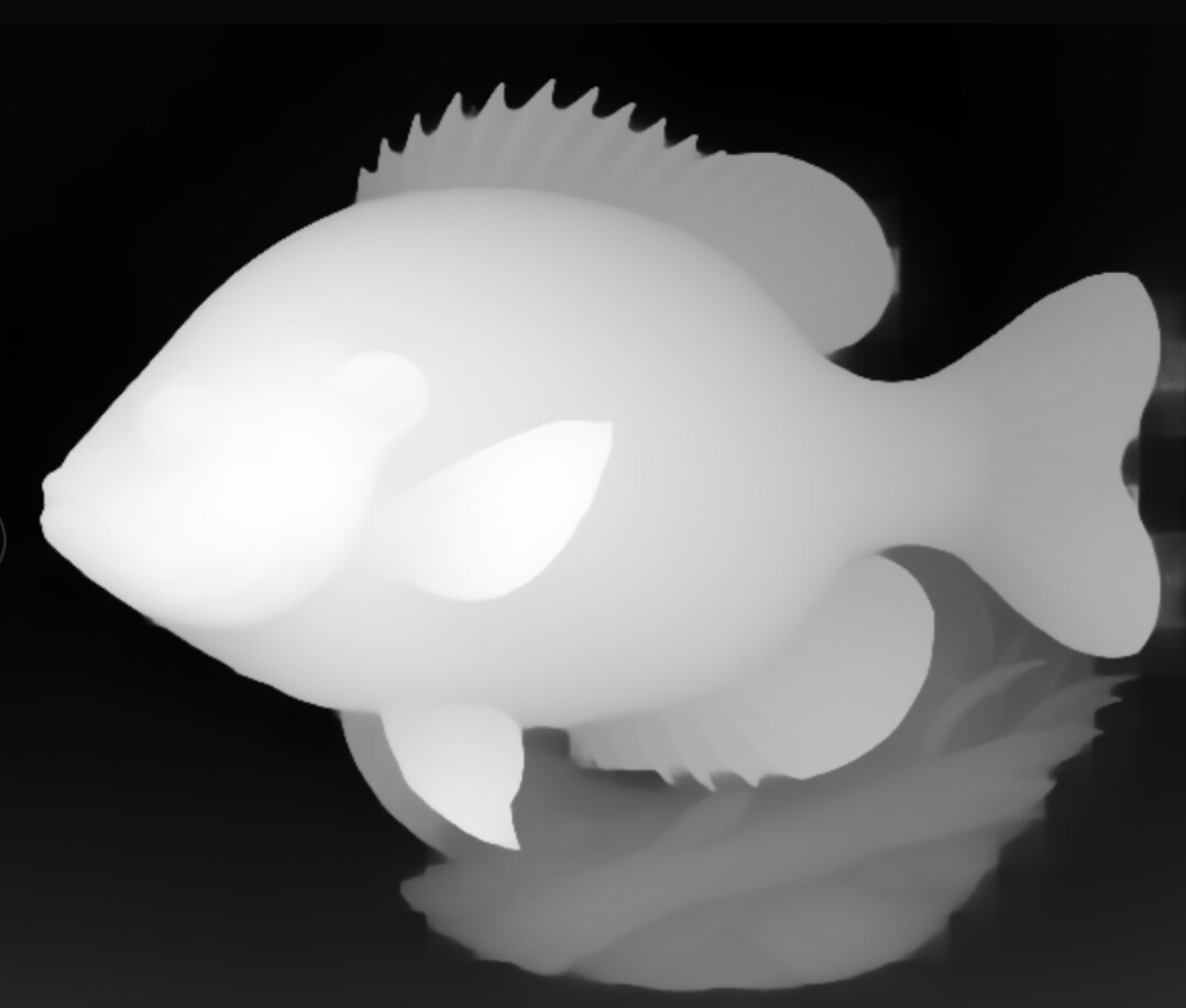

I have a dark brown suspicion that your grey scale image isn’t a dedicated grey scale depth map. It would not look this detailed but more along the line of the example beneath.
I used a free online tool for this one and have no idea how good or bad it is. I used beta versions in the early days that were kinda crap, but good enough for my purpose.
Just make sure gtp understands that you don’t need a grey scale picture, but a grey scale depth map. If yer lucky you might even b able to have it generate a stl file right of the bat.
I tried indicating that even specifying greyscale color space but it is still generating RGB images. I’m going to try the Easy Create route to see how it is unless someone can actually produce a fish that is true gray scale depth map using ChatGPT. It can not produce STL directly.

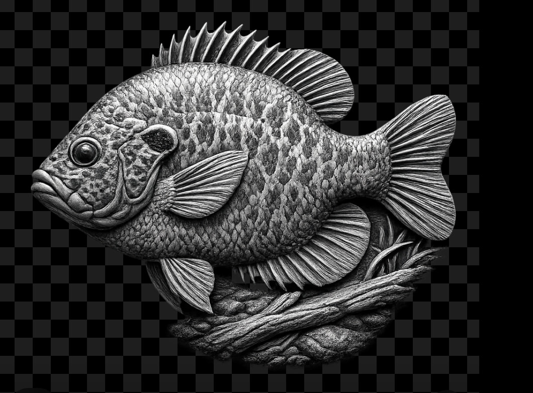

Thanks! My ChatGPT fish above was just a sunfish. Am curious if it creates the correct fish and how much detail it includes.

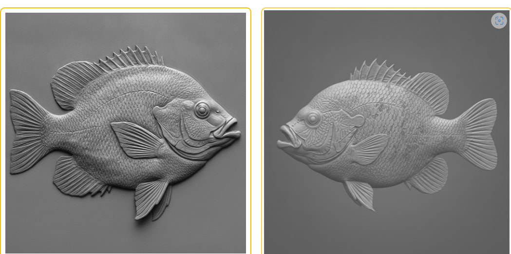

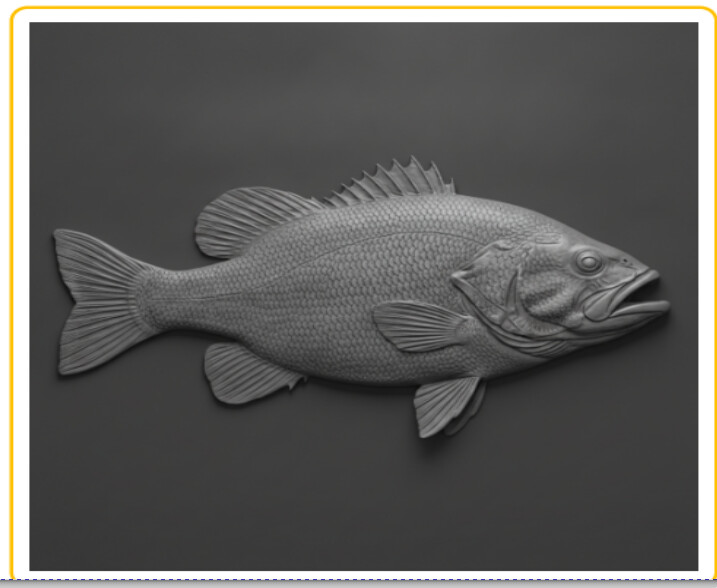

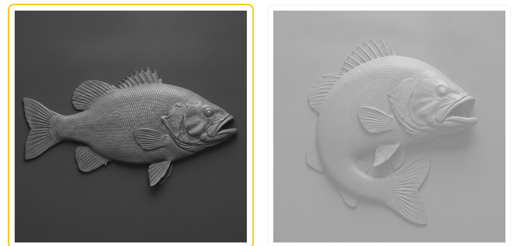

@DavidB Sunfish encompasses a lot of different species so I asked it to do a Warmouth Sunfish. It came up with these two options. One is brighter because it has the focus on my computer.

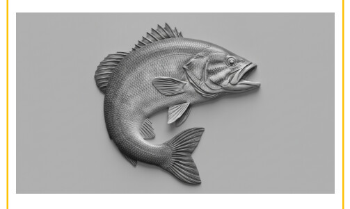

I then asked it to do a Smallmouth Bass and here are the results.
Based on google images, they seem reasonably accurate but both appear to be a bit stout. And the scale coloration is not obvious.
So I did a third try with a 16:9 ratio (instead of 1:1, and also asked it to make it less stout and it did this
Of course, if it does seem too stout, you could stretch the model in the x direction. This is the first smallmouth bass stretched a bit (1.25:1 ?)

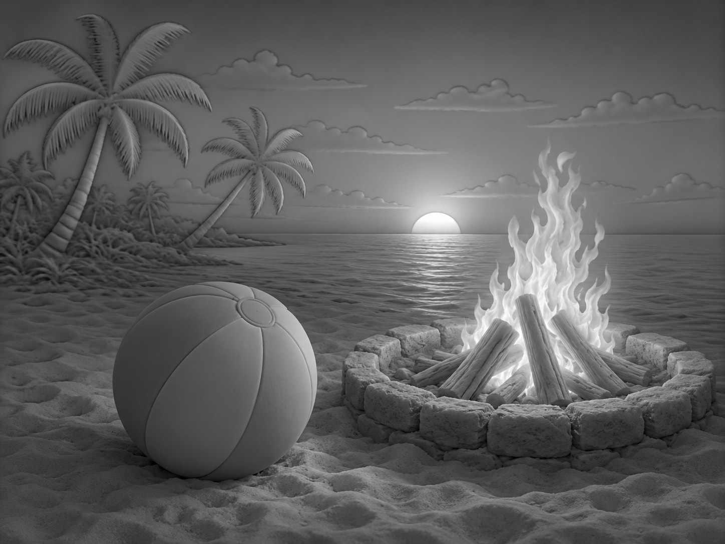

i have used it to create greyscale depth map images and has worked good. i usually save them as a .png format that you can import to easy create or vista sculpt. you can then save the image in a .v3m or .tiff or .stl format to import into Vectric software.
Mark
here is the prompt i used to create the image…

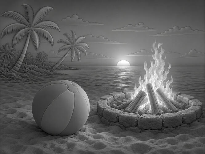

create a 3d grey scale depth map image in .png format suitable for conversion to a file that easy create can convert and use for v-carving, of a beach ball on a sandy beach next to a roaring fire in a firepit with palm trees and a sunset in the background.
Okay.. I tried the above text in chatGPT and it still doesn’t seem like it is quite right? Note the sun reflecting on the water and the fire light. Wouldn’t this cause issues without further processing? Maybe EasyCreate “fixes” it?

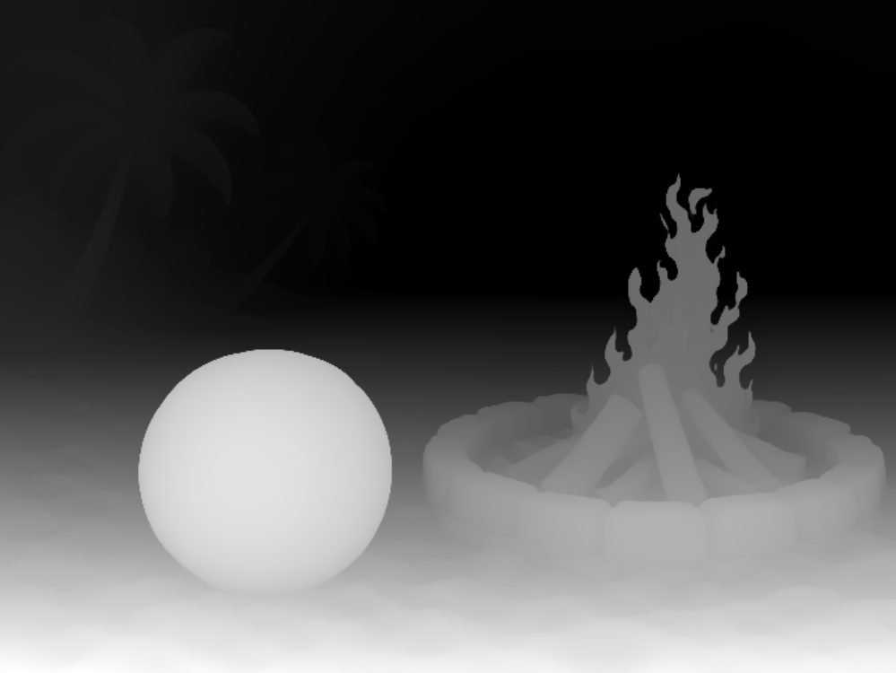

If you want a gray scale picture to be useable to carve a relief, the grays should represent a hight vallue. The ball at the front, for example should be a lighter gray than anything in the background and most certainly not have two such distinct grays in it. This ailien created picture will not create a relief, this is created looking like one.
A depthmap would look more like this:
Created with this online tool:
