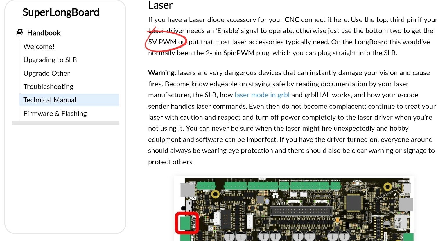

I ordered a new Laser Tree LT-80W-AA Pro. I am confused on how to go about installing the laser to my SLB from Sienci Labs. Is there a video or has anyone else ever installed the same laser to their SLB? I have ordered an extra plug 3-pin 3.81mm pitch Pluggable to plug in the SLB and I was thinking of using telephone wire to connect from the laser driver to the SLB. Do you think the telephone wire is a good idea? I’m open to suggestions.

I have not looked deep into compatibility of the slb with the laser tree controller board, but I thought I saw the lt controller wants 12 or 24v pwm controll? That might you needing a stepup adapter between the slb and the controller. Again, I only swept the manual of the laser so I could be wrong here. Will take a look after posting and might be back soon.
Neah your good! I clearly only registered the 12 and not the 3-12V range. I.. think?

OK, thank you for the info. The only other question that I would have is what kind of cable should I use to connect my driver to the SLB. That is why I asked if telephone wire could be used. I have a MK1 30 x 48 so I need about 8’ of cable.
Going with the setup of my own laser. The pwm signal does not carry much power, only signal. On my setup, the laser controller is right at the longboard and is connected with two lose wires that to me are pretty heavy duty. I thinnnnk you can get away with telephone wire allthough it seems you need to run it all the way up the machine.. that’s what.. 3 meters in length? This might be a wee problematic, static wise.
I would go with at least some more copper and a shielding to prevent (future) problems that have no clear cause. Static can be a pain to pinpoint.
I am still unclear on the pwm voltage compatibility and have asked Chris and Kevin to chime in.
They will have a definitive answer in that regard.
@Allan I have the lasertree 20 v2. Looking at the adaptor board, it seems to be the same one that you have. What may be very different is our configuration. I have a LM Mk2 30 x 30. The lasertree adaptor board and my SLB sit right next to each other on my table. So the cable connecting them is the one that came with the laser. It is less than 12" long. The long cable connects the adaptor board to the laser module. That one is very long as it runs in the drag chain. An electrical engineer on this forum recommended that I run minimum 14 gauge wire. Smaller will result in current loss. So, I am running 3 conductor14 gauge, stranded silicone wire. It’s super flexible and works very well. I can’t see telephone wire working very well at all.
Sorry for delay, but was verifying with engineers since lasers aren’t really my knowledge base - they agree with Grant and Eddie in that the board will work, but you should look at alternative wiring options if possible.

When I ordered my laser tree from Amazon, I did not realize it would be such a challenge. First of all the Laser Tree that I ordered did not come with a power pack, cable to connect from the laser to the SLB, and a mount to attach the laser to the cnc.
With all of that being said, I wrote to sienci labs and they suggested that I buy 3.81mm/0.15inch Pitch Circuit Board Connector.
This plug is used to plug into the SLB and at the other end I was able to find another type of plug that comes from Amazon. Connector 2.54mm Pitch 3pin Female Connector Plug. That is plugged into the 3 pin on the driver adapter.
For the mount, I was able to make one out of .25 plexi which turned out perfectly. And I had to buy a 12 - 24 volt adapter from Amazon.
