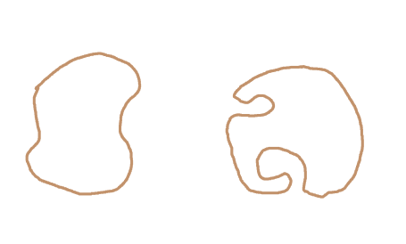

Fusion is a excellent program but isn’t free for commercial use. If that matters to you FreeCAD has a loft function. Shapes with ‘occluded concave parts?’ won’t work for a loft. Not sure about the terminology so here’s a pic with a shape I think is okay on the left and one on the right that I think would cause problems with a loft.
The actual process will vary with the 3D program but in general you’d want to export your profiles as svg files and import them into the 3D program. You want the inner shape to be above the outer shape by the thickness of your stock minus the 1/16" you want to leave. Then you create a loft from the outside shape to the inside shape, export that as an stl file then import and position that in Vectric to create the 3D toolpath.
Thanks, yes I struggled with how to describe it! Been trying to find a picture of something similar, but can’t find that either. haha.

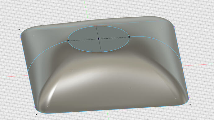

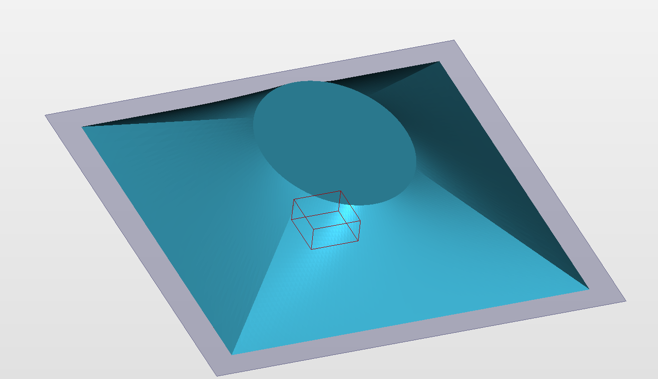

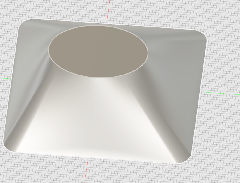

@gabo Sort of like this? Model done in Fusion with Loft

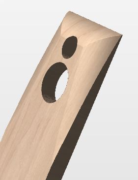

Thanks. That’s more of a chamfer, which I have pretty much figured out. Actually for this one I’m using the moulding toolpath in Vcarve, so I get a curve instead of a straight chamfer.
But I would still like to get the hard diagonal lines between the X and Y directions smoothed over and I would like to get it curved more at the bottom end such that the edge contours to zero all the way down.
@gabo I think the only way to get rid of those diagonal lines is for your square to have a fillet at the corners
Ah, so I could make another toolpath that clips that off. That’s something for me to figure out. Actually I’m sort of liking the look of what I have. I will have to wait for the machine, then cut a prototype, mount my speakers in there and do a bunch of testing to see how it performs. It might be ok.

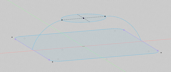

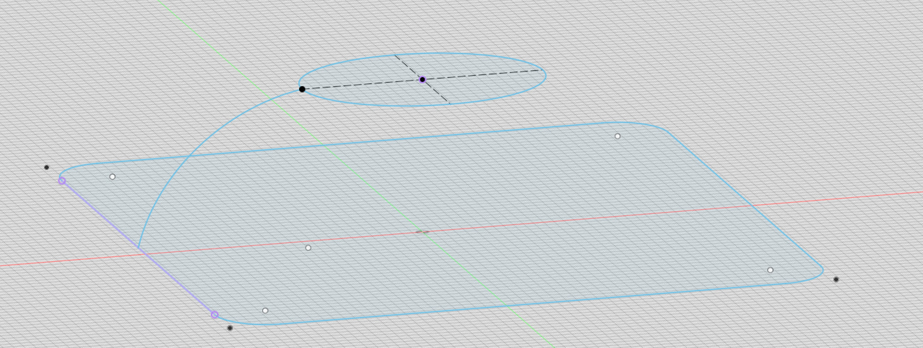

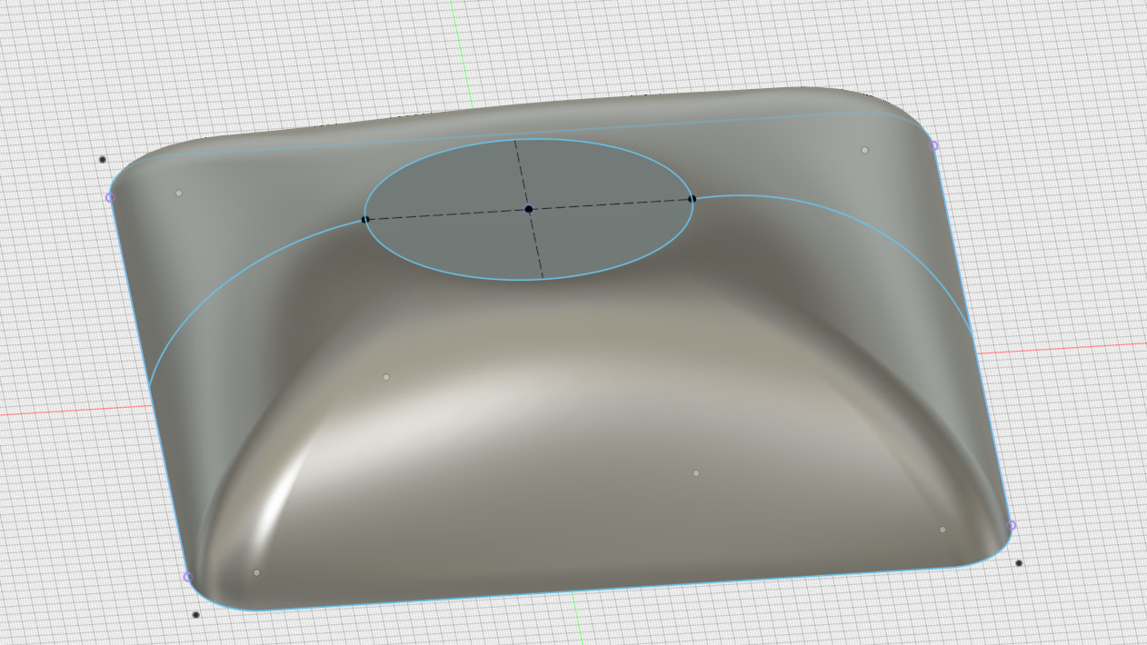

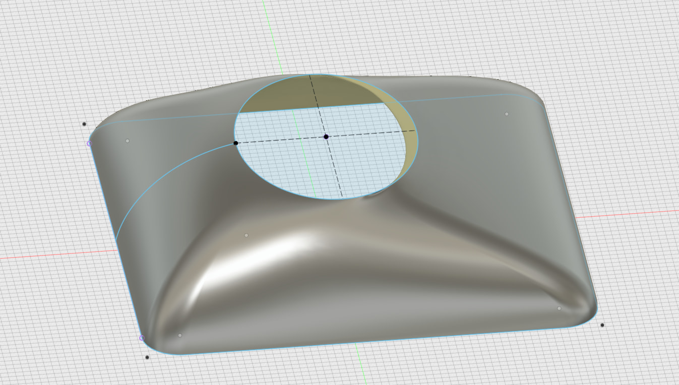

@gabo Also, by adding a “rail” to your Fusion “skeleton”, the loft surfaces can follow a specific path. In this case, I added an arc between the square and the oval. and made the loft follow that arc.

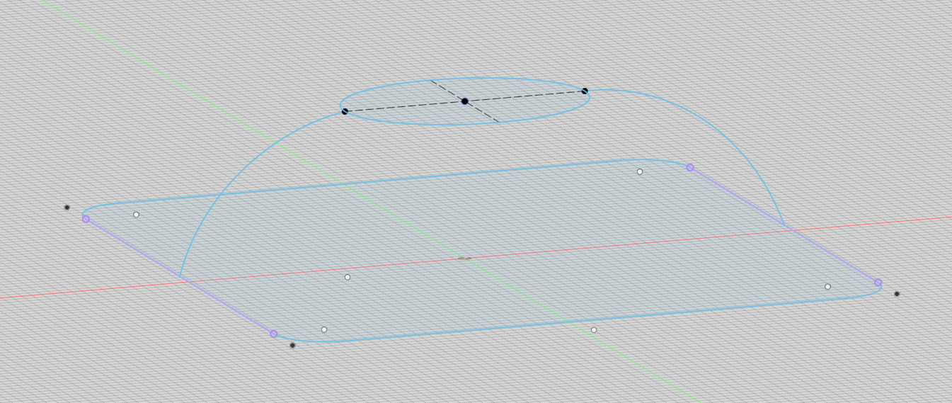

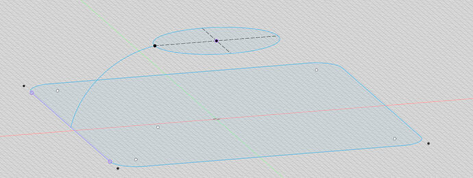

@gabo Same thing with two rails
Ah, that’s getting there, very cool. I don’t see a way to do those types of things in Vcarve. But no worries, I need to go learn some things in Fusion and Freecad anyway. I realized before I purchased the machine that this is not really about the machine, it’s about being able to create things in the CAD/CAM packages. If you can do that, the machine will do what it’s told to do!

@gabo BTW, in the example above, I show two sketches, each on a different plane, and two arcs to join them together. These are then used when using the loft command. But I could also have done it with three sketches on three different planes and not use any arcs. Fusion then decides how best to create a surface that passes through each sketch. Sometimes, the results get interesting.
