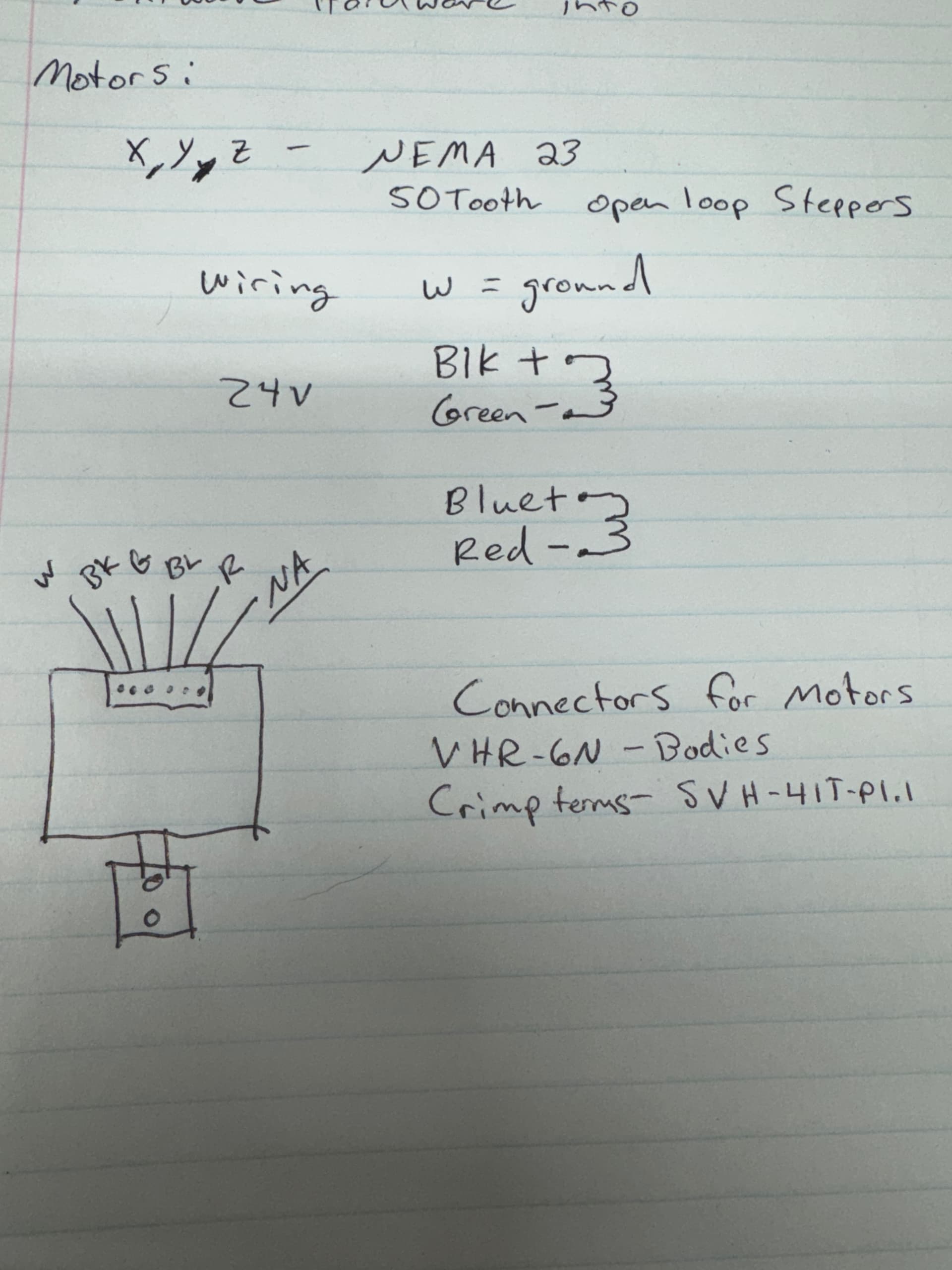

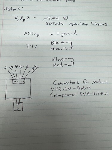

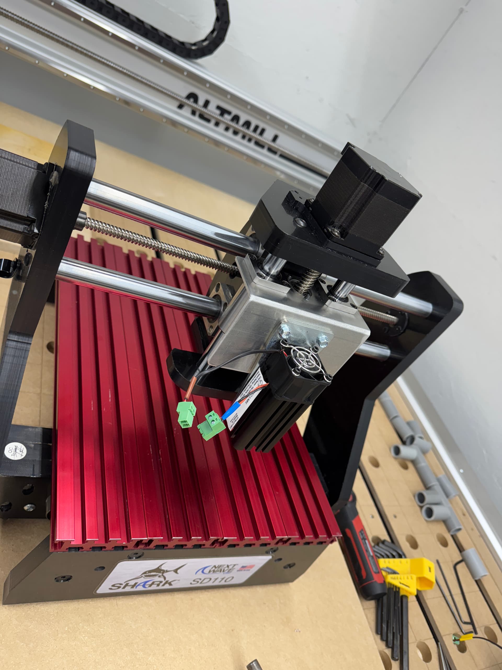

The thread referenced above was mine. I hated that I had no control over accel/decel and top speeds with the Nextwave system. I bought a Altmill over a year ago and love how it operates and what it can do compared to my little SD110.

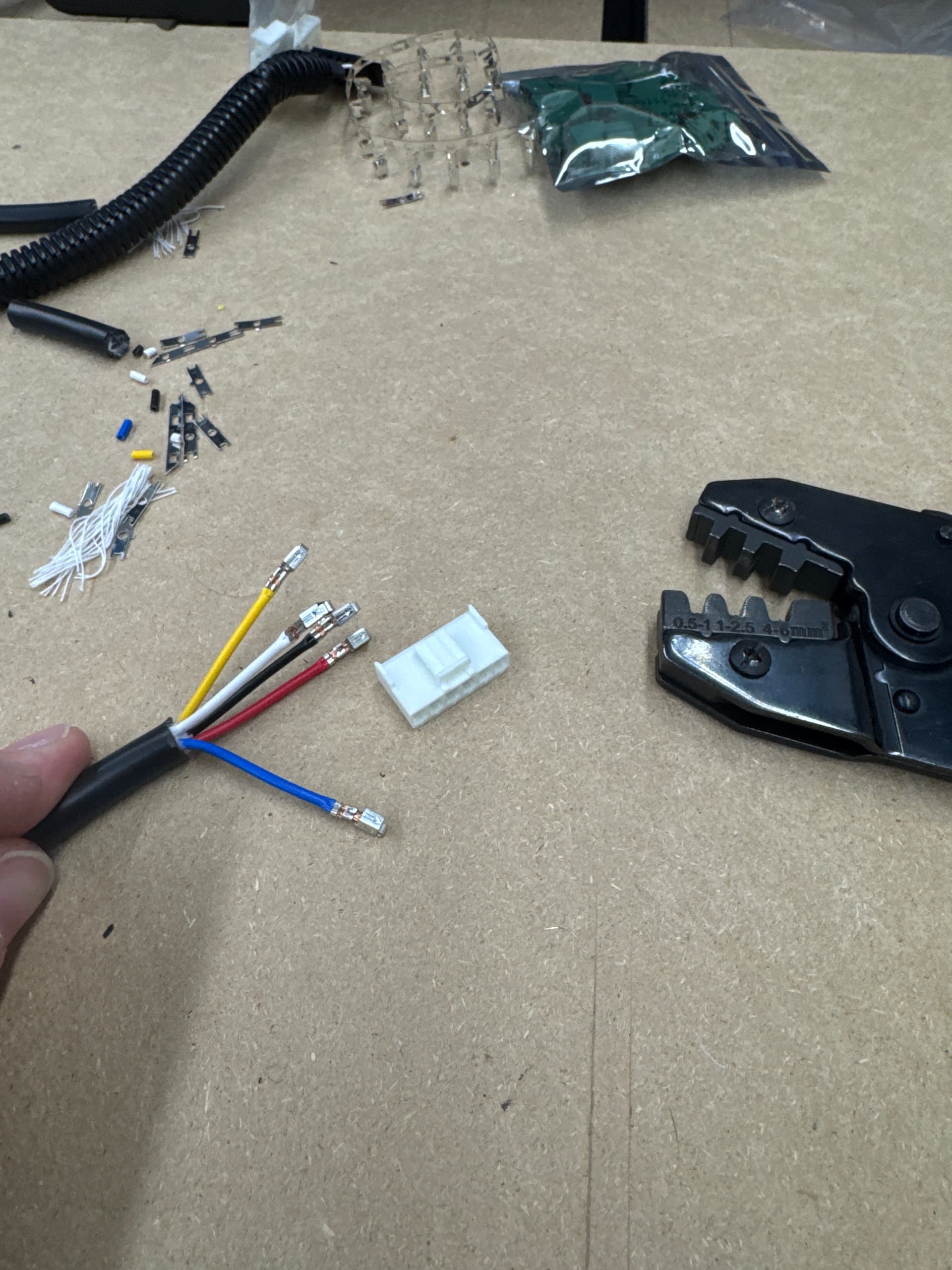

I bought an SLB and stripped all of the Nextwave controller and wire harness off leaving just the motors. I then ran new wires for the motors and installed new connectors on those cables to plug straight into the motors. I added limit switches so I could run homing sequences and have hard and soft limits too. No more getting to the end of travel and listening to the motors skip and make that awful noise.
My SD110 is now used only for laser purposes. Let’s face it, the SD series machines aren’t that capable and have a ton of flex in the Z axis plate where the router gets clamped to. Running a laser job now with my new accel/decel rates and higher travel speeds, which are all tunable with gSender, takes 1/3 the time it used to with the old Nextwave control.
I would make the conversion 1000 times over again without hesitation. As an added benefit, if I have a laser job too big to fit on my SD110, I just un-mount the laser and driver, move it to my Altmill and run the exact file on that machine. No need for different cut files made with different PP for each machine anymore.
If you have questions or want part numbers for the connectors and pinouts just let me know. I’ll help however I can.
