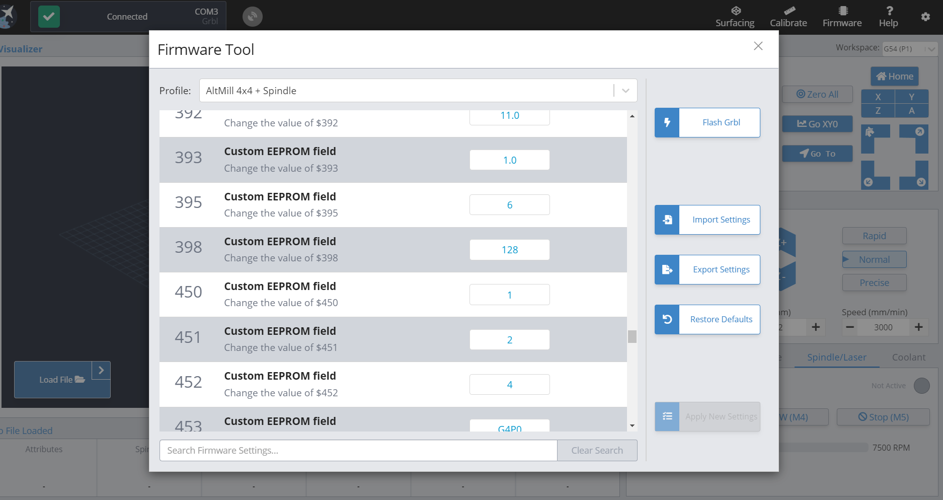

  2. In the video tutorials, G-Sender’s firmware tool has descriptive names for all the $ settings (at least the ones they show in the video). But when I tried to change my default spindle, my $395 setting, and all the $ settings after 133 are all just called “Custom EEPROM field”. I did select Altmill 4x4 + Spindle as my profile. Could this be a bug? The spindle works but I’d like to really get to know this software and how it works.

You need to connect using the grblHAL firmware, not grbl. I can see in your screenshot you are using the wrong controller. That is why you don’t have proper descriptions. It’s not a bug, just user error.
Perfect! Thanks for your help
