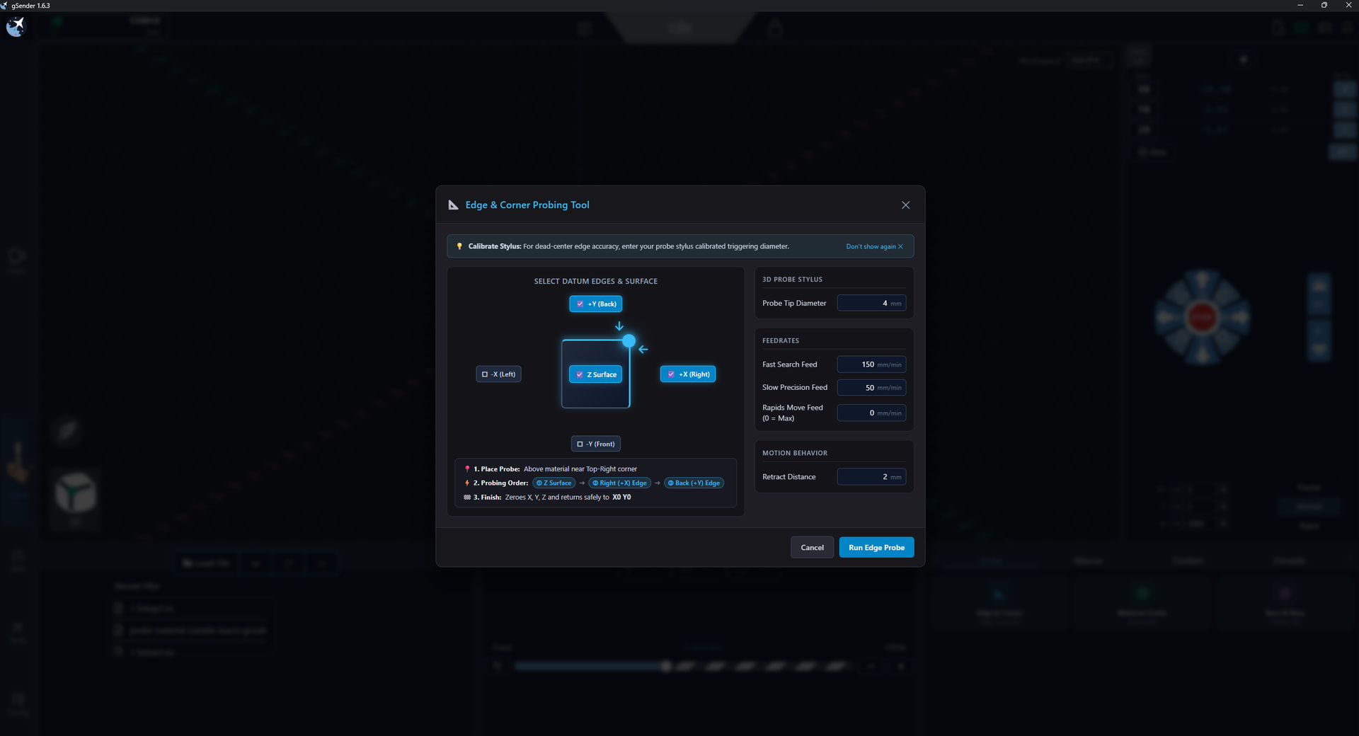

you guys have removed the ability to chose what corner i want to probe and only left as default front-left, so i made my own probing logic, with clear visuals on what corner or edge will be probed and instructions
my only hope is that you like my approach and accept my pull request
video demonstrating this in the next days.
also added feed field for rapids
this idea was made based on posts on this forum
this update will be pushed on git after i have tested everything

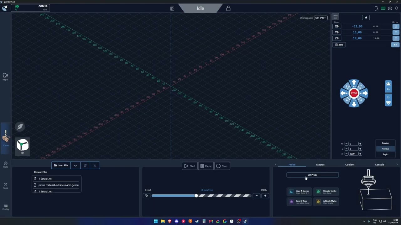

updated complete 3d probing suite demo, haven’t tested it yet, but will soon. let me know what you think
@iuliancalin Very well done, Julian. I can’t see it well, but does it allow for the verification that there is a complete circuit before running?
oh a very good point, so i updated the probing button to only be active and can be clicked after connectivity/function of the probe is confirmed, unless the probe is set to NC , of course this will be only necessary if the connectivity test is checked in the settings
also, make sure you set the video to 1080p :slight_smile:
give me more feedback :rofl:
also, i did a test and made a plugin for the 1.7 edge, but, probing should be an integrated feature in the software, so no, i do not consider making a plugin for it, its not safe
forgot to mention, it is made intentional for the probing window to not be closed while the probing is running, the start button turns into a stop button.
