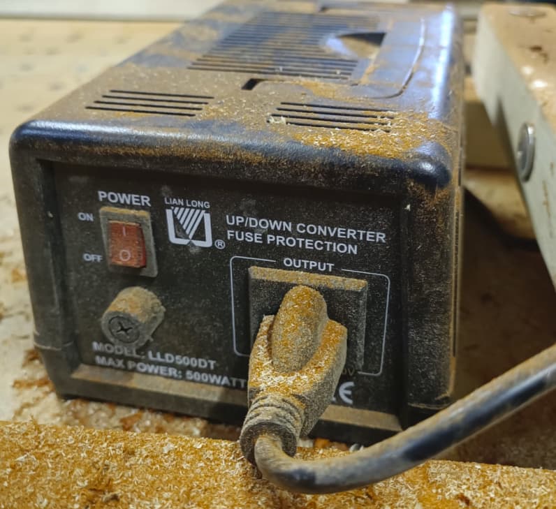

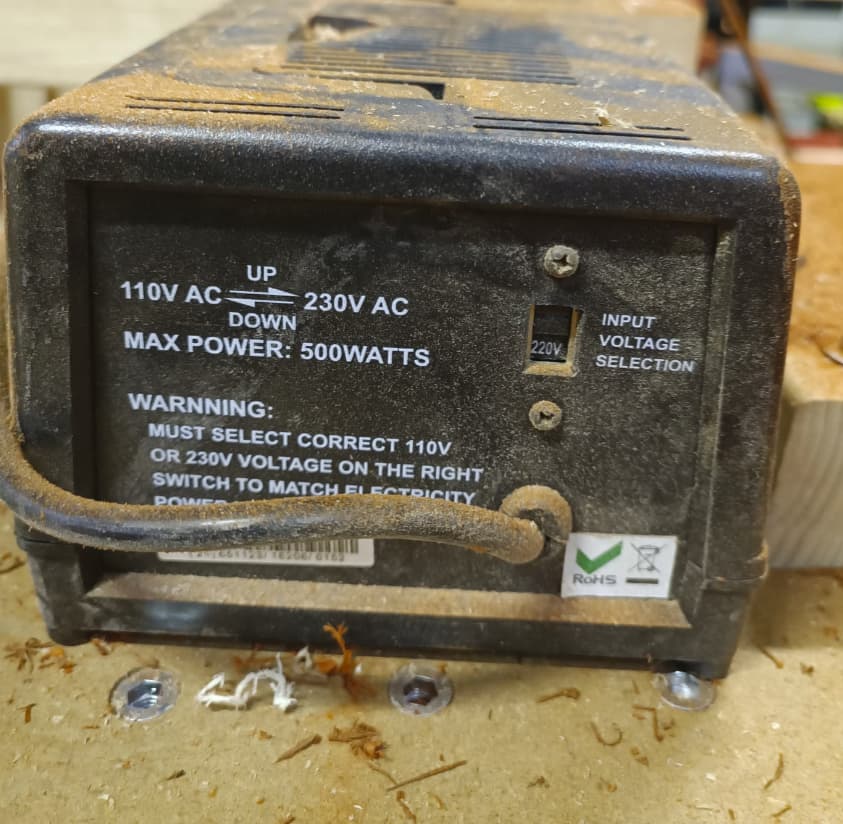

I do however own a machine that runs on Childrens power too. Though it’s a Longmill, a simple 500W 240to120V tranformer works well for me. You might want a slightly more powerfull unit for the specs of the Altmill says it runs on 500Watt max power without a spindle, so it might be cutting it close using a 500W max convertor. But nothing fancyer than a simple transformer is needed, and It shouldn’t cost ya more than €150,-
