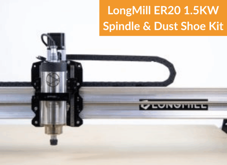

Snookered! Sienci tells me that their upgraded spindles are too heavy for the LM, hence not recommended. They have offered (thank you) to send me a replacement Mak router. No choice but to try it, and experiment… Have looked at DW router - better collet, but SL dust collection boot not compatible. pwnCNC spindle looks promising, however, over $1K, and the no one supports a ā€œcustomā€ setup. All advice welcome.

Admittedly, if it were me I would target something in the ER11 or ER16 at 65mm for lower weight as you won’t really be able to make proper use of mills larger than 1/4ā€ anyway. Probably air cooled too as those are typically lighter and have less additional points of failure.
To that point though. Internally we try to limit forces on anything riding on v-wheels to not more than around 15-20lb and that eats a lot of it on top of momentum issues.

Spindle for LM not available in Canada due to ā€œcertification issuesā€. They are working on finding a solution, however, are not able to provide a timeframe. This is the preferred approach.
