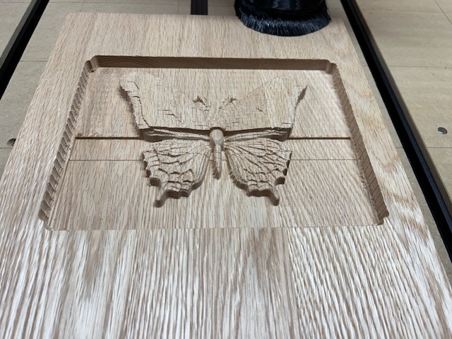

Received new Makita router from Sienci (cannot say enough about their support). Also new collet/nut, of course, and bought a new cutter (same 1/4” tapered BN). Set up same butterfly job, in same material. Roughing no problem. Finishing, same issue as before.
Cutter rated at 150 ipm. I started at 130, and when I saw the cut deepening, I backed off to 100, however, no visible improvement. Cutter rated at 0.7” max DOC - my model under 0.5”. Stopped job part way through and verified slipping cutter when XYZ back to zeros. Am contemplating next steps - probably will try to restart job at about 1/4” DOC to skim off the top of the model as a first pass, and then second pass at prescribed depth. All when I have the time/inclination. Comments/suggestions most welcome.

Let me provide more information: I am using the Sienci 1/4” D1/16”, Tapered Ball Nose End Mill for finishing a 2.5D model of a butterfly. Feeds, Speeds from Sienci Web site, for hardwood for that mill. Roughing the model is at 0.4598” max depth. Finishing at 0.4998, and there is no slippage on the “flat” part of the project. The model protrudes from the base by a bit less that .5”, but I am using this dimension as approximate. The slipping starts when the mill encounters the (less that .5”) sidewall of the model. At that instant, as the mill moves vertically, I believe the engagement of the mill is pretty close to 0.5” with the wood, but I stand to be corrected. I believe it was you, in the early stages of this post, who suggested that since the mill is upcut, cutting puts pressure on the mill to pull it out of the collet, and the evidence seems to support this. Someone else suggested several passes, so I am thinking about setting the Z “0”, at about 1/4” above the actual material.

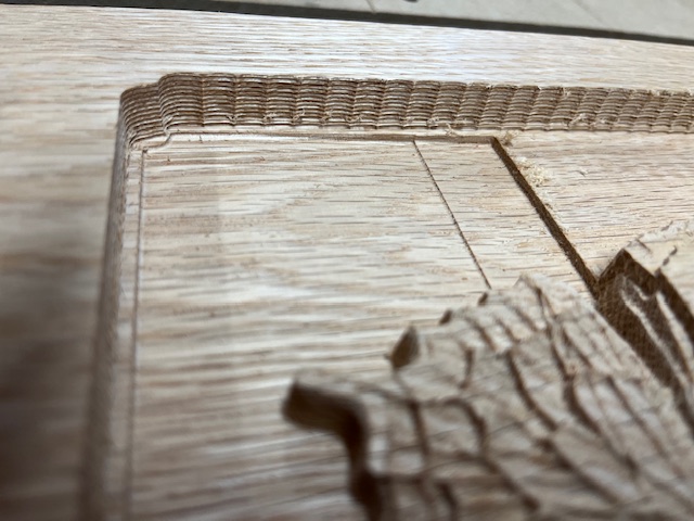

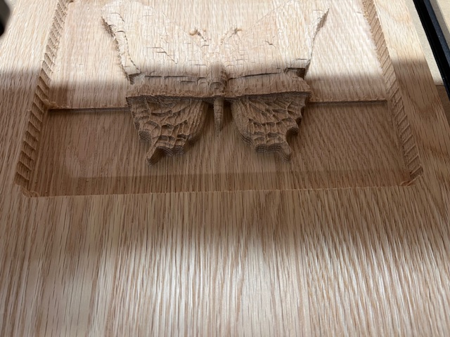

Pics best. STL file. Boundary of cuts from inside vector. Outer edges of wing and inner body are the 1/2” “walls” I was referring to. Side pic where can see the deepening of the finishing cut once body of butterfly is contacted.
Had some time, so tried the sharpie mark on the mill suggestion and confirmed mill slippage - result in pic’s.

After the above, ran a 1/8” roughing mill, and as expected, far more detail than the 1/4” mill, especially in the tight spaces such as the antennae, however, the vertical “walls” of the model did not change.

The picture in post 11: Cutter slipping from collet - #11 by Retiree , who did that? It shows a similar bevel of the bottom plane. Could it be the model you are using? How much slippage did your Sharpie test indicate (although a measurement would have been more accurate) ?
