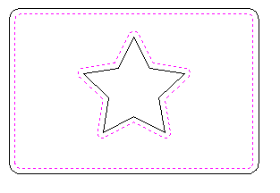

Without seeing your vcarve model, I may be way off base…
Could you break the pocket/roughing/finishing toolpath into multiple toolpaths set up so that each toolpath avoids the problem?
My first (naive?) idea would be to make small offset closed shapes inward from the outer wall, and outward from the inner butterfly, and then create a series of crafted ā€œsafeā€ toolpaths that mimic the different bit and F&S choices that Vectric makes for you when setting up an ā€œautomaticā€ pocket-with-roughing-passes:
(rough drawing of what I’m thinking, with the offsets in red)
Toolpath 1: rough out the black line pocket between the butterfly and walls - From your comments above, this doesn’t seem to be the source of your problem
Toolpath 2: finish the inner red line pocket - will take a long time with a small TRO bit, but should never run into the ā€œfull wall engagementā€ bit slip problem because of the red offset distance
Toolpath 3: a multi-pass ā€œinside the outer black lineā€ profile finishing pass with pass depth (or feed…) set to eliminate the slip problem
Toolpath 4: a multi-pass ā€œoutside the inner butterfly black outlineā€ finishing pass … ditto…
Trying to think inside a different box…
-John
