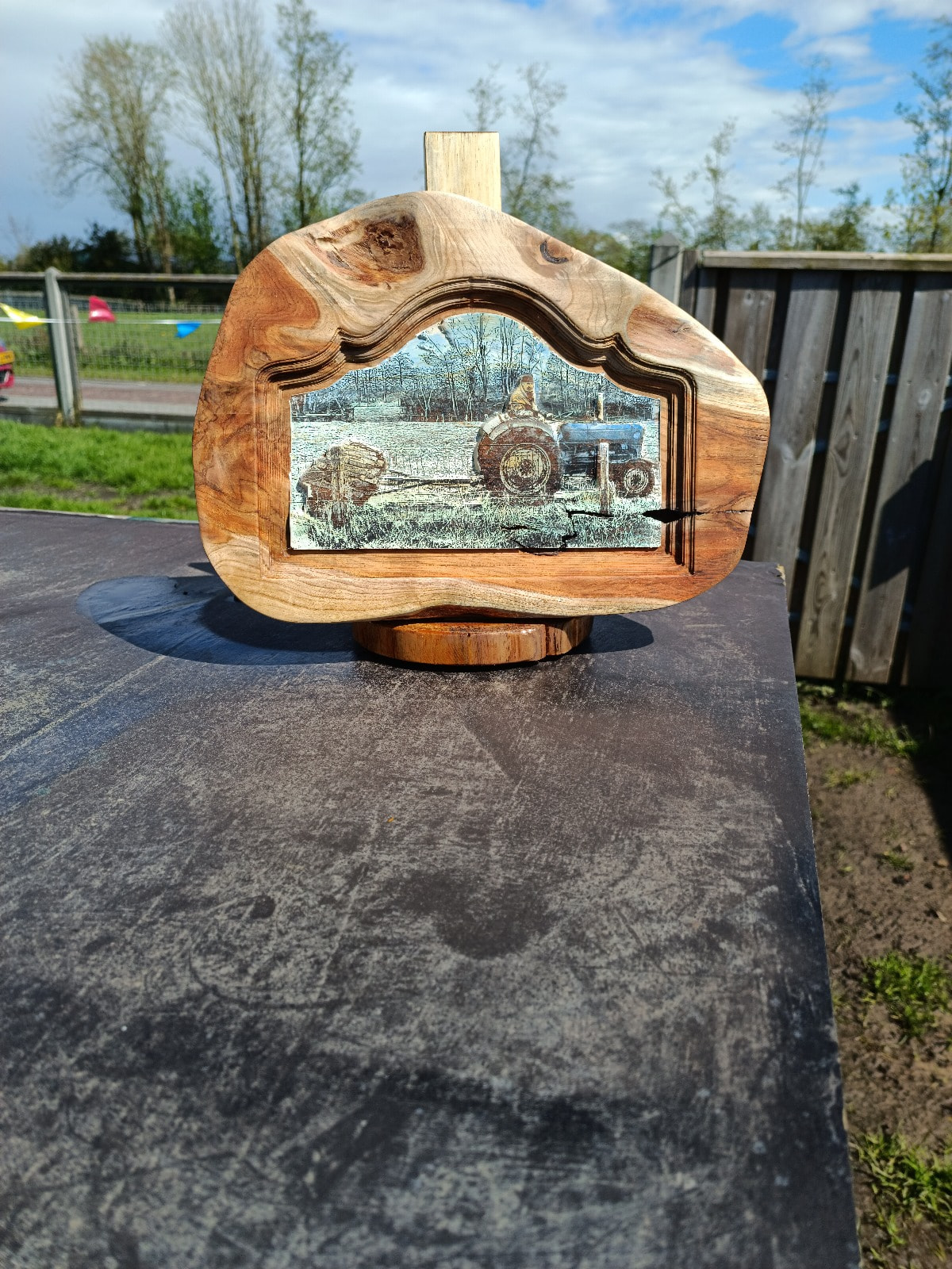

To be able to determine the centre of a realy impossible irregular stock, I use a calibrated camera to take a picture inside lightburn that adds a grid. Importing this picture inside my cad software gives me a good referense to design within the stocks dimensions.
Tip: When using centre zero, after zeroing xy, move a known distance x or y outside the stock/design dimensions, and carve a dimple with a vcarve bit on the spoil board or outside the cutout dimension to be able to refind your centre zero. Don’t rely on brain to store that distance! I write it next to the dimple and cross it when no longer valid if on spoilboard.
When, not if, you lose your zero, just install the same vcarvebit and fit it back into the dimple you made, move up the z axis enought to not hit the stock - sounds silly but trust me, it is easy to forget (before the mistake. After the mistake, it will hunt you for ever.)- and move the known distance back to where the centre was. Zero the xy (this is essential, trust me on this one too.) And you are good to go again.
No way I could’ve made this one any other way than with a centre xy0.
(Without the camera I would’ve not be able to fit the design within the irregularities of the plaque either. But centre xy0 is key with this sorth of projects.)
