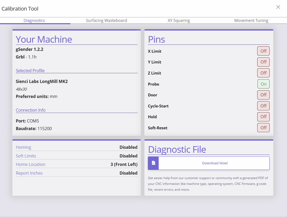

Forgive me if this is already asked - how can I use a GCode command to move the spindle down until a probe touches the worktable, to see if it level? I tried G38.2 which was not recognised. Did somebody already do this?

It involves using a standard touch block, a not too fragile straight endmill, the calibration tool within g-sender, some paper, an ink reservoir, and a good old fashioned goose feather, freshly sharpened.
The probing is done fully manually. You move the spindle to the desired spot you want to measure, put the touch block beneath it and manualy sjogging down until your probe pin in the calibration tool is activated.
The first time, zero your z on this point, pull up z a few mm, and move to the next measuring spot. Sneak down onto the block again untill probe pin activates but this time dip your freshly sharpened feather into the ink and write down the z vallue. After this repeat as many times as you like.
