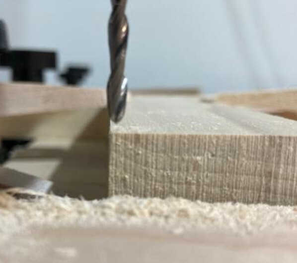

this is where auto zero is putting the bit. 1/4” downcut endmill

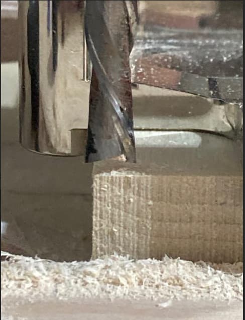

1/8” ballnose
definetely right of center of the bit. Am I wrong?

I am completely confused. The pics show that you are setting XY0 to a corner of the material.
However, in your description, I thought that you were saying that your XY0 was set to the centre of the material.
In re-reading your posts, I see where I may have gone wrong. You are not setting XY0 to the centre. Your vectors are centred on the material. Correct?

yes, my vectors are centered my xy zero is lower left corner

@Shellshock For your ball nose, you may want to try using “tip”, as the touchplate documentation sets out.
It is setting the zero xy on the centerline of the bit. It looks like the end mill and ball nose are in the same position based on a guess at centerlines in the picture. If when you flip the board and you use a different corner of the wood to set 0xy it might make difference.
@kimsey.pollard FWIW, the pic of the end mill does not look to me to have the centre of the mill at the corner of the material. It may just be the pic, though.
