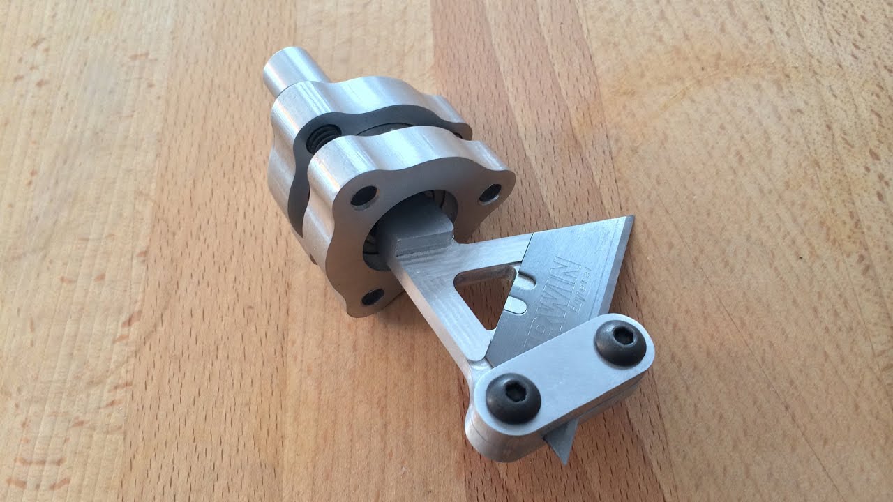

Fellows: I was trying to understand if the cutter turns freely at the spindle bearings or at that triangular housing, half way up?
I can’t figure out what that housing is for?
Sorry for my ignorance, but I’m really enthused about this thing. My girls would be thrilled if I would help them with their craft ideas.
@Hansi @BillKorn
Hanis: The cutter turns freely in the bearings. The housings do not rotate. You can look at minute 8:48 here
to see it in action.
What Bill was saying is that the Makita router spindle spins so freely that the entire knife assembly is turning in the router. That being the case, Bill and I are going to try one without the bearings and the bearing cup assemblies. It will just be the blade holder and a shaft glued into it. If it works, it will be of a much simpler and lighter design.

Grant, I simplified and shortened the frame, added a threaded hole in the top, and edited the thickness for your 1/2" Corian. Fusion did a miserable job creating the dxf but I attached it anyway. If V-Carve imports STLs, IGES, OBJ, or STEP files I can send you one that is much better.
When you are establishing the cut depths for each section note that the blade has to be dead center side to side under the pivot point or it will not track correctly. The frame positions the cutting edge of the blade behind the pivot so it follows the pivot. The original frame is 0.375" thick so I added 0.0625" on both top and bottom.

@jwoody18 Jeff: I just cut a new one this afternoon in 1/2" corian. I did one yesterday, but somehow broke it while threading for the 1/4" bolt/shaft. Stupid! If this works, it will simply be a scaffold for the knife. There will be no bearings. We are trying this because Bill found that, in testing his bearing model, the knife rotated on the router rather than on the bearings. So, I suggested that we just get rid of the bearings. Keep in mind that I have absolutely no idea what I am talking about, but I have corian scraps so I have nothing lose but time.
In reply to your direct question, you need to tap two holes 10-24 for the screws that hold the blade clamp. If you don’t have a tap, you can simply drill the body of the knife to the same size as the clamp and use nuts and bolts. For the shaft that connects the knife to the router, I am using a 1/4" bolt with the head cut off. I chose to drill and tap the body of the knife with a 1/4 x 20 tap and then coat the threads of a 1/4 x 20 bolt with epoxy and screw it in. If you don’t have a 1/4 x 20 tap, you could just drill a 1/4" hole and glue the bolt in. Then, just cut off the head of the bolt so that the shaft fits into the 1/4" collet of your router.
Bill has been my mentor on this. The plans that we bought were for 3/8" material. Since I am using 1/2" material, the cutting depths need to change. Bill told me that. It would have been better if he had told me BEFORE I cut the first one, but you get the advice you pay for. :grinning::grinning:
I hasten to add that I have not made one that works yet. Bill has. I hope, tomorrow to test the one that I cut today. There are a couple of critical dimensions. The first is that the cutting edge of the knife must be offset from centre. This is built into the plans. The second, is the blade must be precisely on centre front to back. That’s where I made my mistake, not compensating for the thicker material. (In hindsight, I may have been smarter if I had sanded/planed the corian to 3/8". )
All that said, I hope to know tomorrow is this bearing-less idea works.
Jeff, the original was not a hard project, and machining all the aluminum was a good exercise. But as Grant said, it turns out that the chuck in the router spins a lot easier than the bearings in the drag knife, so after a couple back-and-forths Grant tried the simplified design. It has a couple things in its favor - it requires less machining, fewer parts, no bearings, and puts the router and the blade closer together, which reduces the moment arm and should make the whole thing a little stiffer and therefore a little sturdier. The router is designed to handle substantial side loads so no issue there.
The frame, now the only piece besides the blade clamp, can be make from any reasonably tough material - acrylic, aluminum, maybe HDPE, and as Grant can attest, Corian. I don’t think MDF or a soft wood would work long term, but a hard wood might.
If Grant agrees, I think we may have changed the design significantly enough to make the drawings and pics available.

@jwoody18 An update, Jeff, the bearing-less version did not work for me. I tried a couple of things last evening and the common problem was that the knife did not rotate as required. I guess that it’s safe to say that there is a reason that every design of a drag knife that I have seen included bearings.
That said, Bill may have better results.
The experiment continues.
Jeff, Grant and I almost have a simpler modified bearingless version to try. Preliminary tests on previous versions weren’t too promising, but fingers crossed this one will work better.
