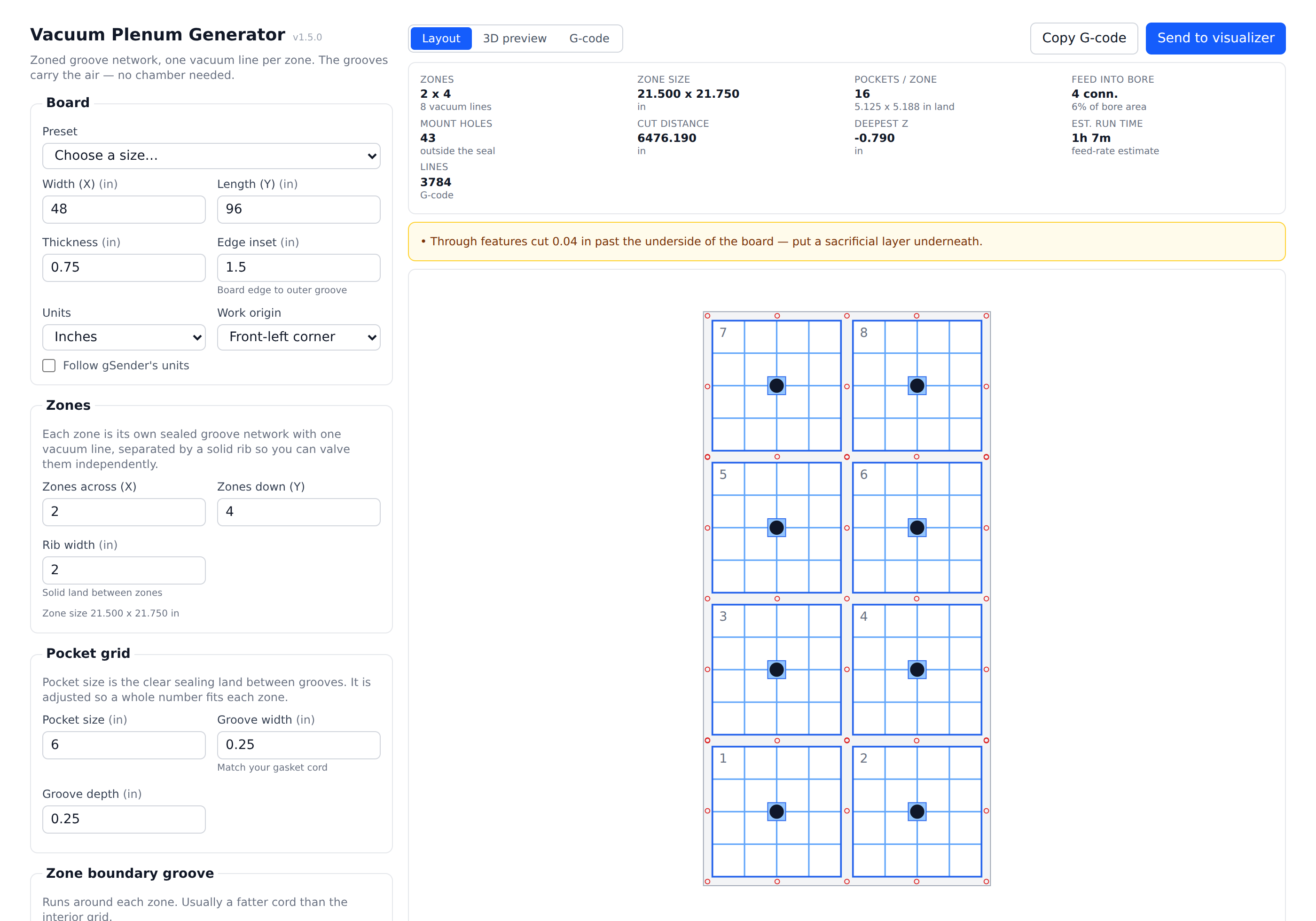

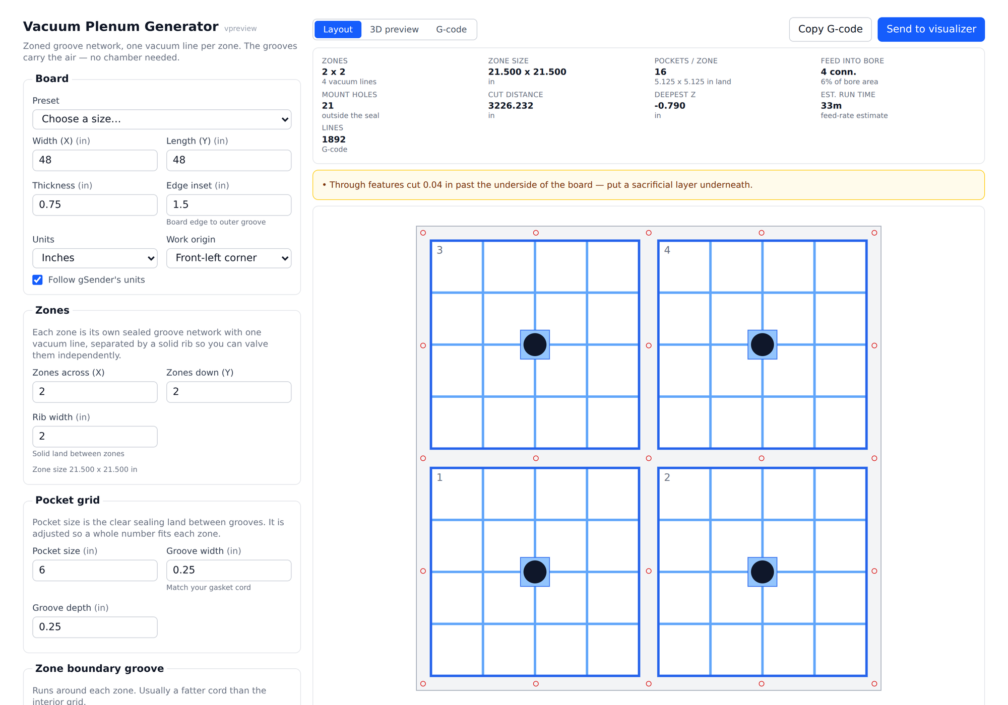

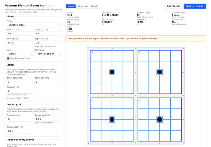

i would suggest you look strongly into 4x8 one. for sheet goods i think its a better choice as you can use full sheets of plywood and don’t have to break them down. you do need a vacuum table. you can get hurricane pump and build your own plenum. One guy who does cabinetry for a living uses 4x8 altmill with atc and vacuum setup. works pretty good. He is also working on plenum design plugin for gsender. I just tagged him here to weigh in @NickHB
Howdy, I got tagged here. Couple things right off the bat! I’m an affiliate so I’d be happy to get you set up with a machine but also I’m a cabinet maker first and foremost. Alex and a few others I stay in contact with have been people I trade info with back and forth and help where I can. I do my best to give what I take.

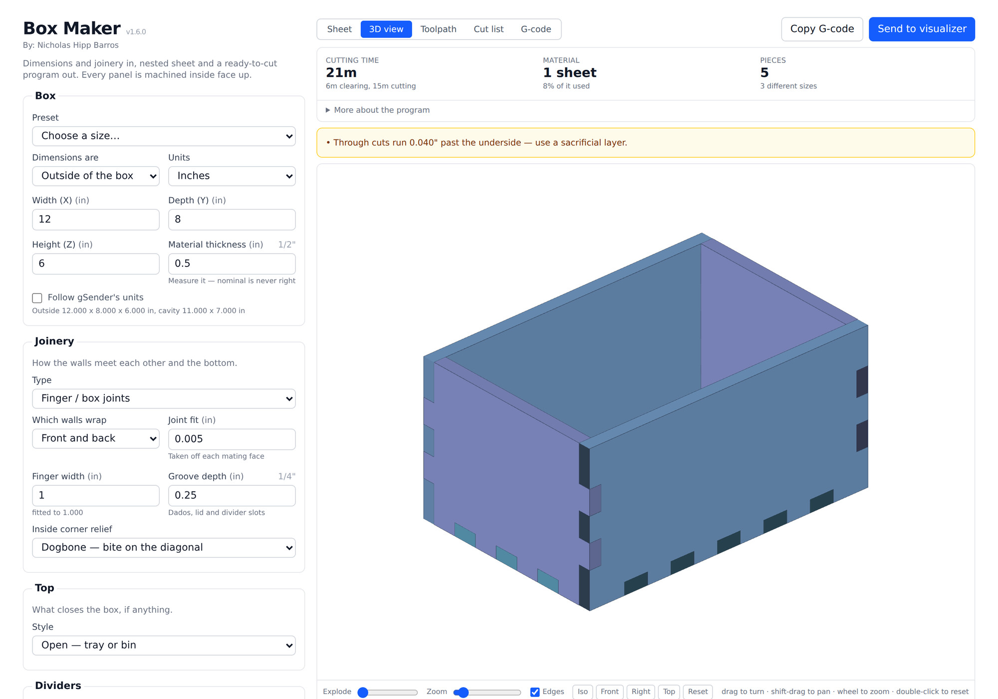

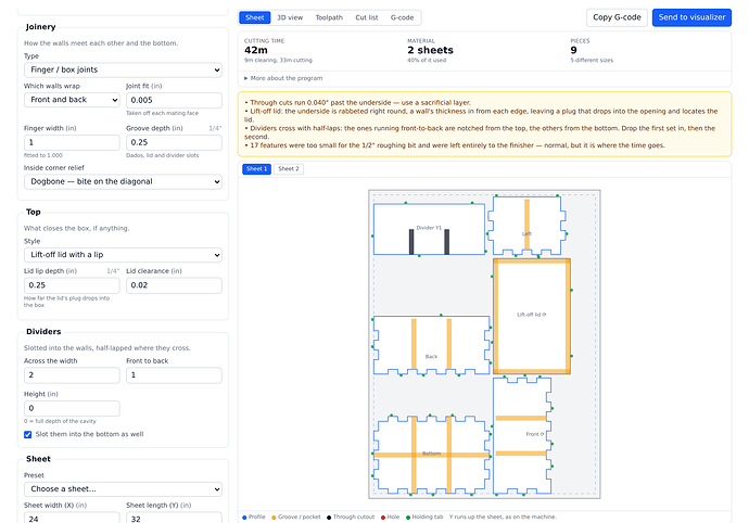

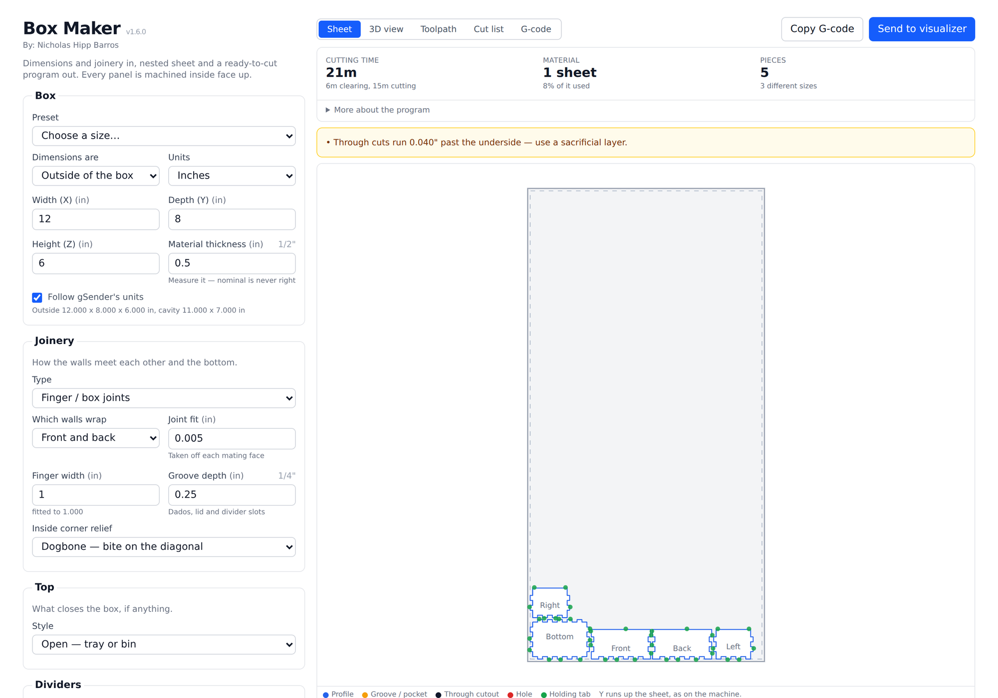

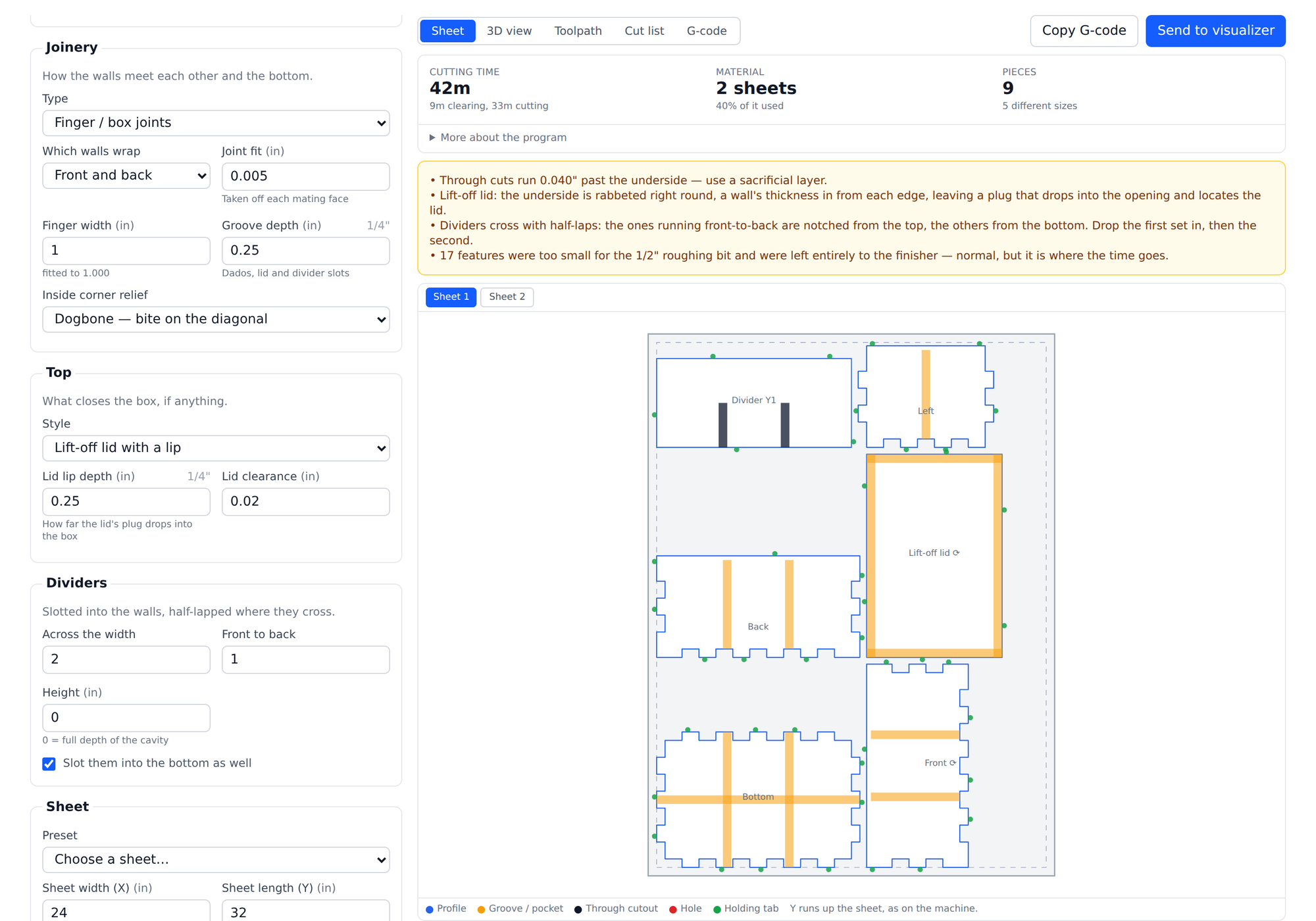

As Alex mentioned I’m working on a plugin for plenum design but interestingly Enough I’m also working on a box maker plugin for gsender. If you are familiar with maker case it’s very similar. I have attached a few photos for you to check out but look me up on Facebook Nick Hipp-Barros. I’d be happy to answer any questions you might have. The plugins are still very much in testing and debug phase so not quite ready for prime time but they are working.
