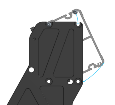

Dumb mistake. Just attached the Z-Axis and put the motors on when I realized I forgot to get the drag chain out of the X-axis assembly.
Is there a simple way to get it out without pulling both gantry plates- Can I remove one side only if I support the X-axis?

I see no reason why this should not work.

I was able to do this quite easily. Posting if anyone else makes my mistake.
  1. Remove x-axis motor
  2. Remove 2 bottom M6-35mm screws from each side of gantry plate (4 total)
  3. Loosen the 2 top M6-35mm screws at the top on each side
  4. Rotate the X-axis assembly backward using the top M6-35mm screw as the rotation point
This gave me plenty of room to remove the drag chains.
Reverse order to re-assemble.
