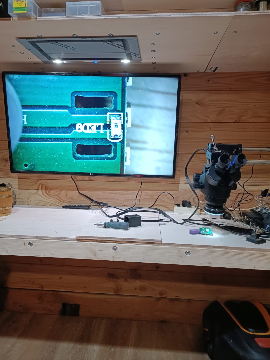

If the induct fan is to clear the enclosure from floating dust, may I suggest an out of the box solution that might work pretty well for a small enclosure.
A kitchen extractor.
I use one of these above my office workbench where I do some solder work and small paint jobs. They work well, are relative quiet, not that expensive, extract air over a wider range than a duct, have some filtering (foam stuff) and come with led lights which is nice.
I only use mine on the lowest possible setting for it only needs to extract fumes and it’s way to powerfull when in higher modus. (Long hair standing upright powerfull.)
If used in an small enclosed space, it will suck it into a (no where) near vacuum.
