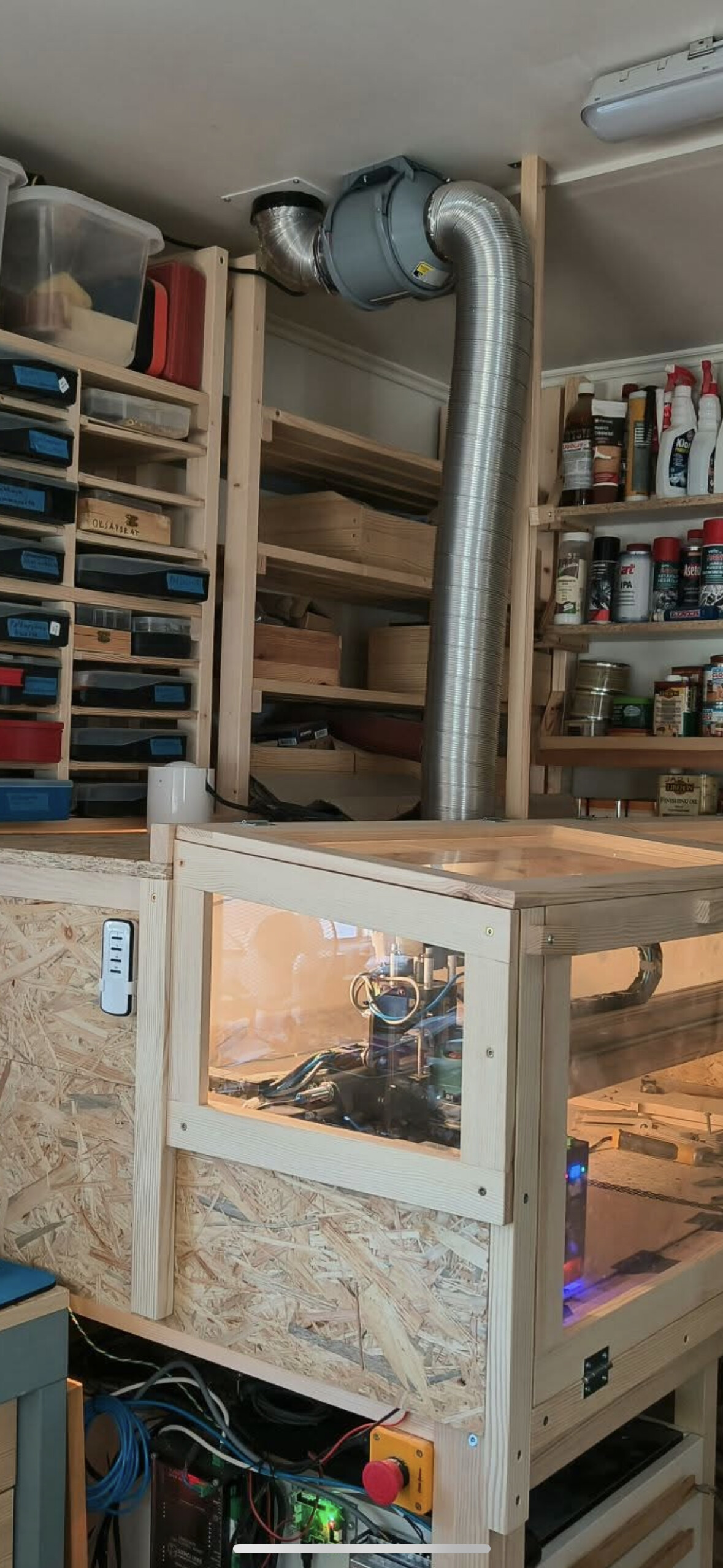

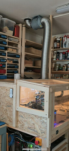

What does your setup look like to vent outside? I have an older house with a garage that is disconnected with a window directly beside my machine. I was thinking of building an enclosure for the MK2, attaching some kind of fan (inline or exhaust) to the window/exterior wall, and then connecting the enclosure and the fan with aluminum air duct. *Maybe I would even connect a cyclone dust collector between the two just to reduce chips moving through the exhaust fan. I think where I’m getting caught up is how much power (CFM) I’m going to need from that fan, and which fan is my most efficient and safest option (least prone to accidental fire).
Here’s an image of a setup that someone showed me on Facebook. Just looks like an inline motor fan with some flexible air duct.

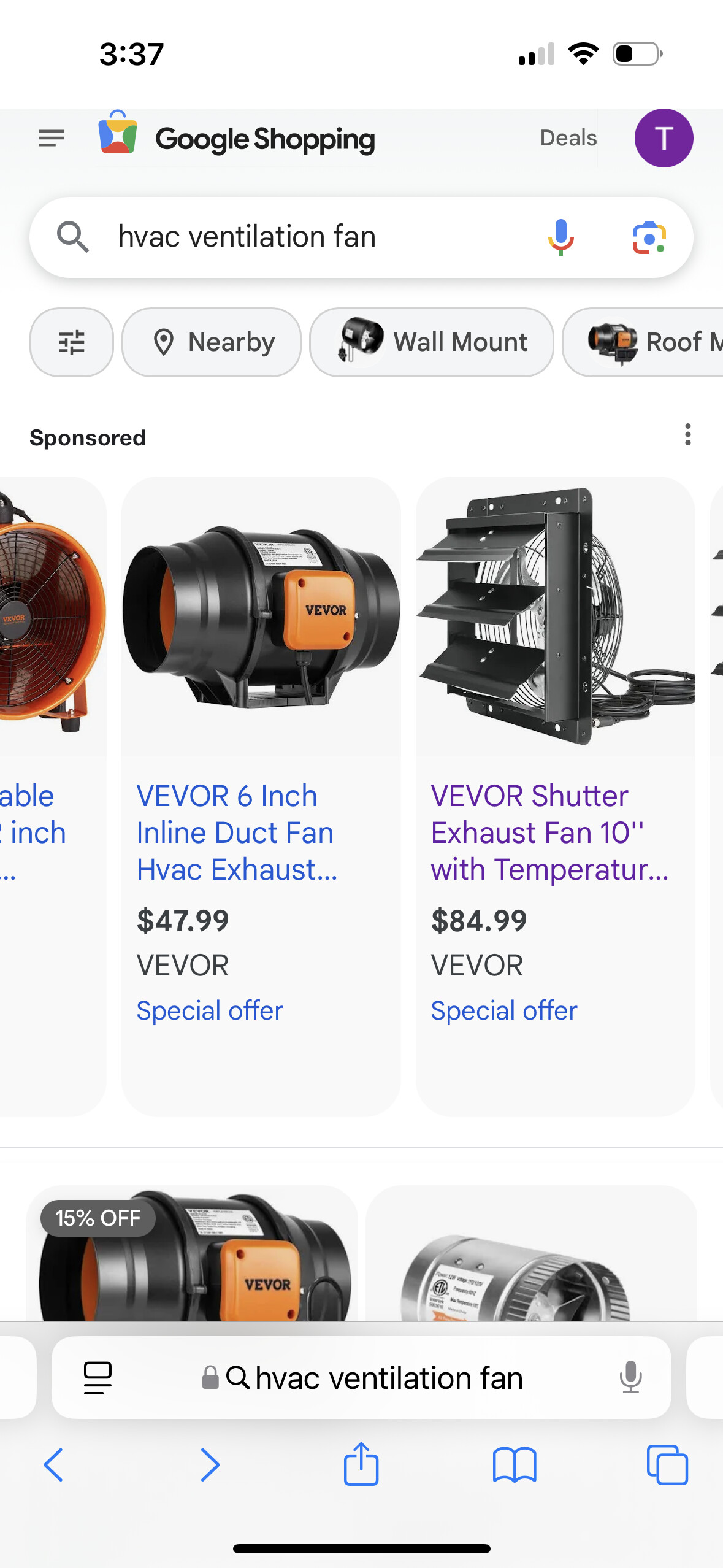

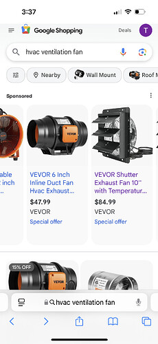

Attached are some images of fans I’m looking at online.
