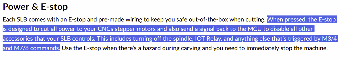

@ColonelClarence This section of the slb manual may address your concern.
“Each SLB comes with an E-stop and pre-made wiring to keep you safe out-of-the-box when cutting. When pressed, the E-stop is designed to cut all power to your CNCs stepper motors and also send a signal back to the MCU to disable all other accessories that your SLB controls. This includes turning off the spindle, IOT Relay, and anything else that’s triggered by M3/4 and M7/8 commands. Use the E-stop when there’s a hazard during carving and you need to immediately stop the machine.”
