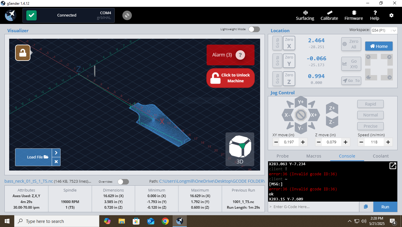

I’m chasing down some gremlins after converting to the SLB and gSender 1.4.12.
I am getting a couple of error messages that aren’t making sense to me. I’m sure I just need to be educated a bit better.
Error 1: G-code words consist of a letter and a value. Letter was not found.
Code cited: x286.228 y-8.939 z-0.771 i1.96 j-2.345 (all letters have values)
Error 36: Unused value words found in block.
Code cited: x291.074 y-4.334 (all letters have values)
When I look in the console display line I see “client !” and “client ~” injected into the gcode (see attachment).
My questions:
  1. Why the error 1/36 messages when my words have both letter and numerical values?
  2. What do the injected “client” values mean and are they related to the error codes I am getting?
SLB B5.0.5B
gSender 1.4.12
Thanks in advance,
James
@JamesORear What machine are you running?
What CAM application created the toolpaths?
What post processor did you use to create the gcode?
The lines that you have included are missing G commands.
Longmill mk2 w/ newly added SLB
Fusion using the grbl post processor
G1 and G3 commands were initiated multiple lines before the errors showed, they’re a long series of point coordinates
@JamesORear In your original post, you mentioned that the gremlins started after you installed your SLB. So, this same code ran to completion using the long board, correct?
If you post the complete gcode, there may be someone here who can see what is causing the errors.
No, this particular file has not run on the Longboard setup but is designed/tool pathed using our standard protocols as previous parts that have run successfully on the pre-SLB machine. There were initially a number of error codes because of new configurations I ran into (i.e. spindle now running on MODBUS connection, improperly connecting via the old grbl COM connection, etc) that were quickly resolved but these particular codes have me stumped as I have not encountered them on this machine or any of the others I run between home, school, and work. Again, I’m sure it is something simple that I’m missing.
This is the first 100 lines of code and both error codes arise in this segment.
errorcode_1_36_truncated.txt (2.3 KB)

@JamesORear did you wind up making any progress on this? FWIW I ran the sample code you attached on both a grbl and grblHAL setup and both ran without a hitch. The code looks fine to me too
It’s very odd for me to see an error 36 appear. Unsure if maybe you’ve got a loose USB connection or are running through a USB dongle maybe?
