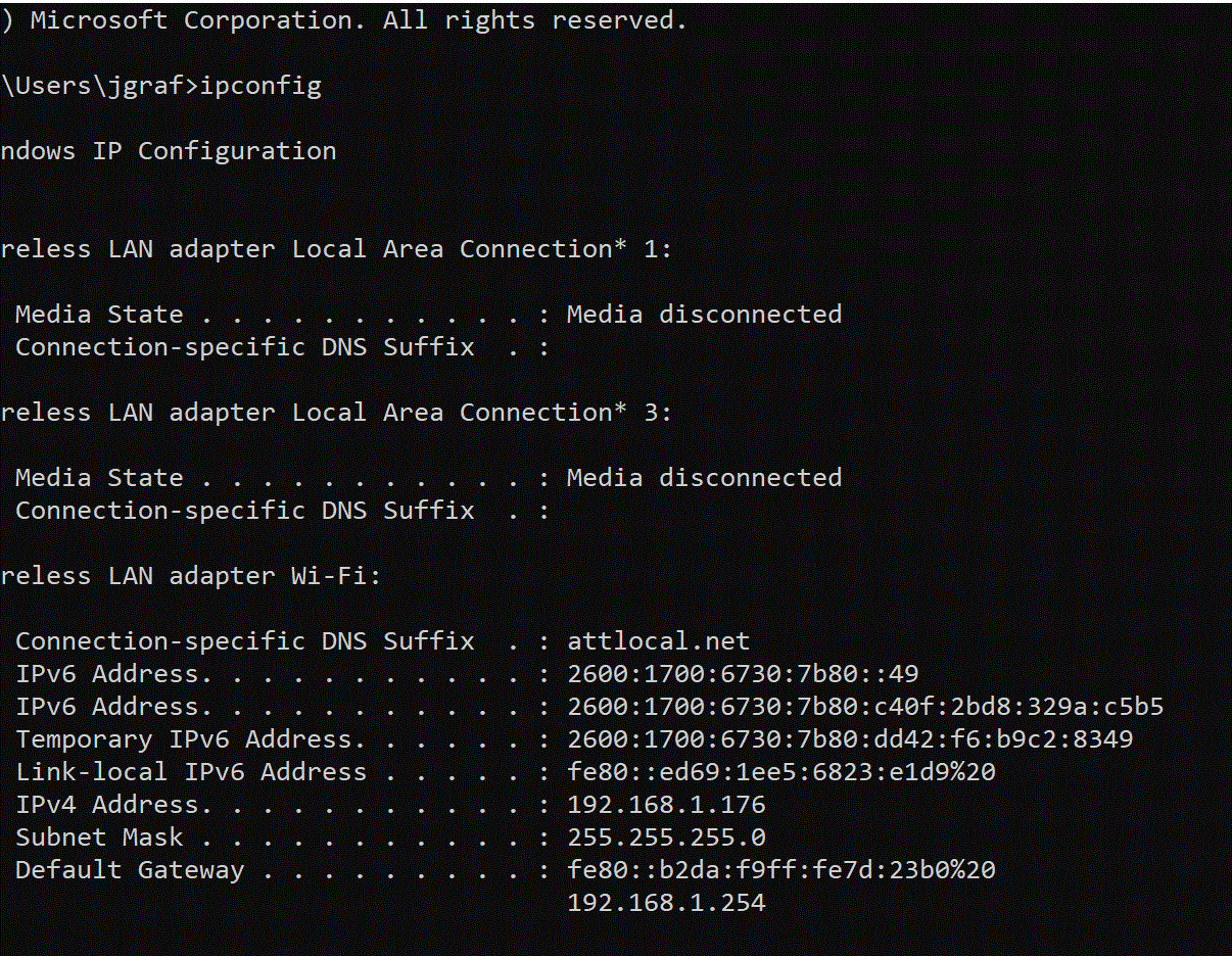

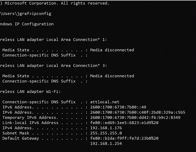

I was previously able to access using my ethernet port. I’m now getting the “Error opening Port” message when I’m connected through the USB. I checked the IPCONFIG which shows two addresses, I tried both to no avail. When I connect using the COM port my Auto Touchplate does not properly set-up. The one time it was close i ran the job with firewood as the outcome. What do you all suppose the fix is?

  3. What addresses did ipconfig show?

I’m using the IPv4.

In terms of the ethernet connection, you must ensure that the port you have set up in gSender is the same one shown in ipconfig. This, too, is set out in the manual. Note, too the the only tested method to connect with ethernet is to connect directly from the PC to the SLB using a static connection.
