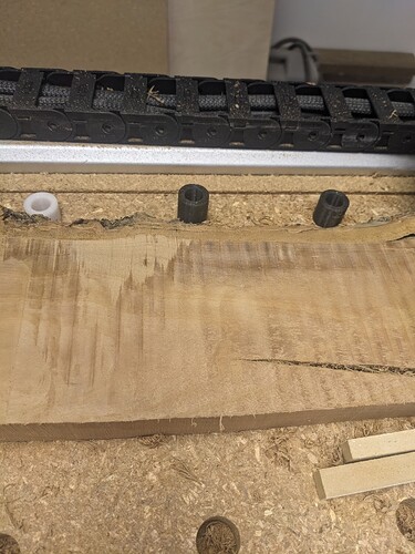

I have a chunk of cherry that is maybe 20 years old and has been gathering dust. It’s a plank maybe 2 feet long and less than a foot wide. It was cut from a round log on a bandsaw
 freehand. In other words really rough looking. I decided to try and make it semi usable by surfacing it. I have a 22mm diameter cutter with 4 carbide inserts that, although previously used, should be sharp.
I tried 17000 RPM and 20000 RPM with a cut depth of 1 mm and a step-over of 85% to get it done fairly quickly. I had a feed rate of 2500 mm/min on an Altmill. At both speeds, the cut surface turned out charred.
Since this is my first go at doing anything with cherry, I am curious if this is normal. Does cherry require some special setup as far as speed/feed/whatever is concerned?
After I had one side surfaced, I ran the second side through a planer and it came out without any charring whatsoever. I flipped it over to the charred side, ran it through the planer and it came out fine.

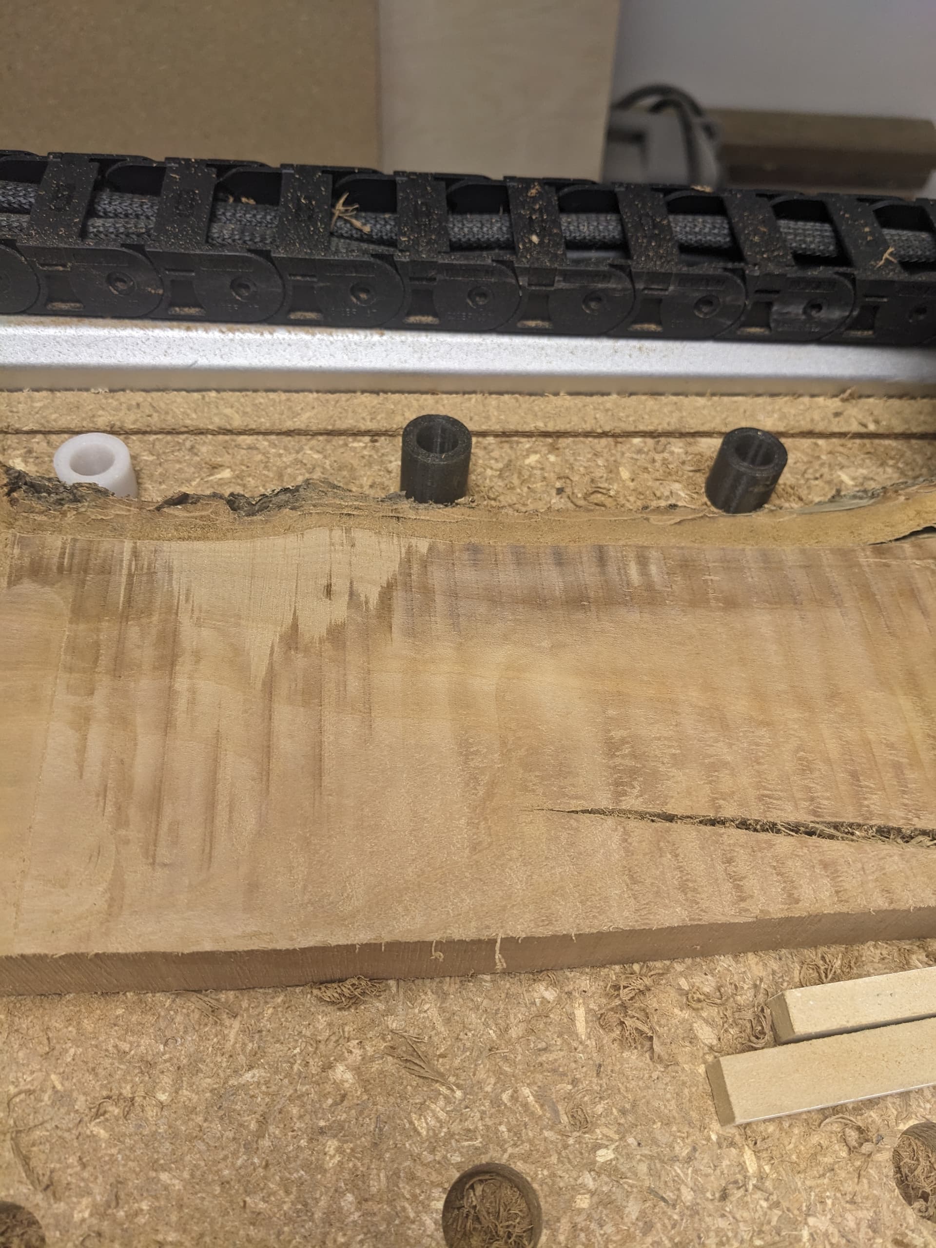

I have done another test at 10000 rpm and 4500 (holy crap) mm/min. . The tips of the carbide cutters had obviously gotten quite toasty from my earlier attempt. There are no charr marks as such. The wood discolours a bit and the level of colourization doesn’t seem to change any more (I varied the feed speed). The picture attached is with a feed-over of 20% (that didn’t change the outcome).
Note that the surface just below and to the right of the white post is the surface the bandsaw left.
It definitively is a feed/speed issue!

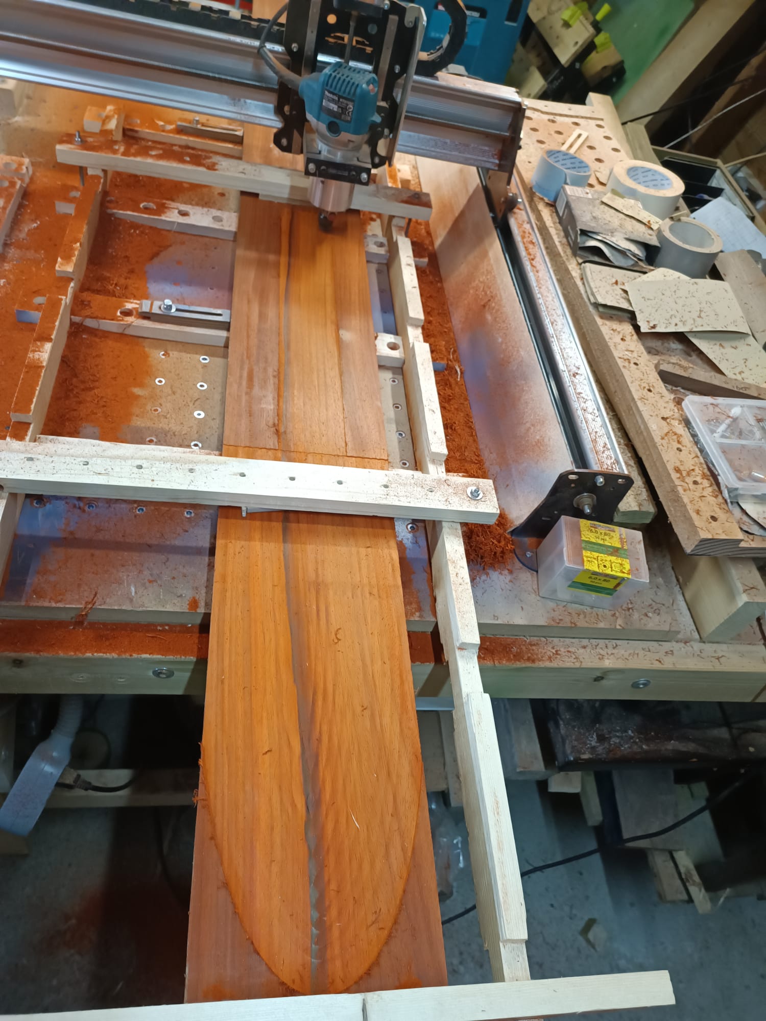

In this picture I am tiling a surface job on padouck piece. Clamp the stock down and surface a tile between the clampings, shift the piece and surface the next tile.
It takes time, but overall it’s reasonable accurate.
You can see a slight discoloration in the parts that have been surfaced, but that’ll sand out.
