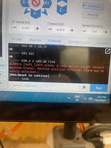

I am having the same issue in 1.5 version gsender. This sucks and needs to be fixed please

My fault. I’m using 1.4.12. I think I found the issue. Normally I have been running in inches. I switched $13 to 0 for metric. Then I had to set $132 to 220 mm for max z travel. Then it worked! Now I switch back to inches and I get the soft limit error again. G38.2 is telling z to move -189.28 in mm when probing for TLO on 1st tool. I don’t know how to change the G38.2 setting as it is not following any set parameters in firmware or preference. Trying to increase max z to avoid soft limit alarm. G38.2 needs to be changed somehow.
Update. When I switch back to inch I get soft limit alarm. I had to set $132 to 5080 mm to get it to probe since now it seems like G38.2 is using the 189.28 as inches but firmware takes the length in mm. Also now when TLO probing is complete the Z0 is way off. It is like 2 inches higher than my previous tool zero setting. I’m going back to mm to keep things moving.
Solution! After many painstaking hours learning code and macros lol I figured it out. Well at least to get my RapidChange ATC working. More testing needed with the gsender wizard. For me the solution was making sure to keep the “firmware” settings set to mm. If you want to see things in inches you can only change the setting to inches in preferences. There SHOULD be a major warning when changing firmware to inches, just sayin. All tool touch off and Probing seem to be calculating correctly now. Many thanks to Don G. At RapidChange spending hours testing with me. What a great crew over there. Those guys will bend over backwards to help customers.
