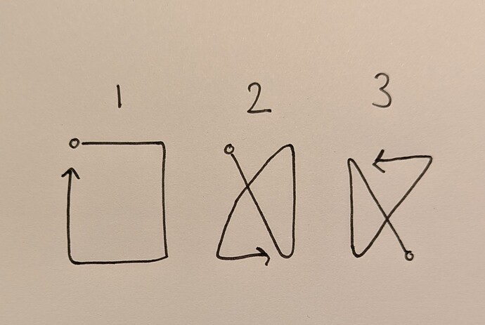

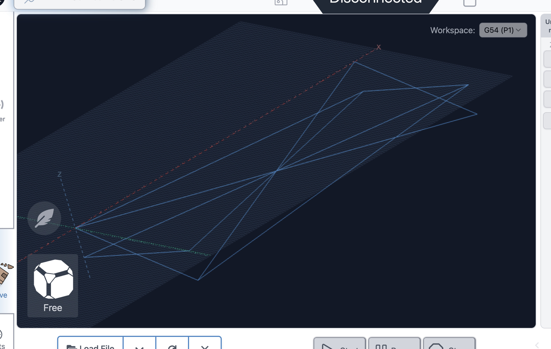

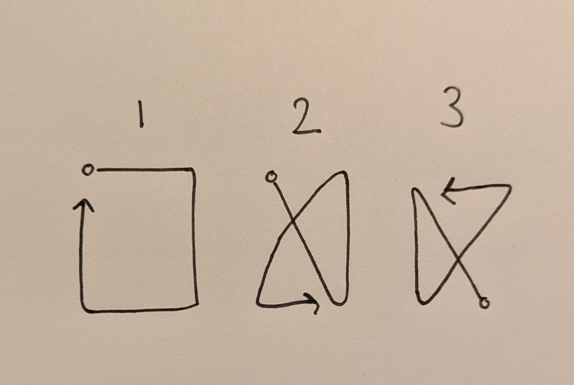

After a great little learning experience I was able to make a very complete break-in cylce file in my humble own opinion :smiley: Learned a nice bit of Gcode and grew some confidence in reading and programming it. I thought it might be nice to share it back here for others to find. Or tell this newby how I could’ve made it better or how much I’ve overcomplicated this part :upside_down_face:
It basically lets you test if all runs smoothly, at different speeds, and lets the machine smoothly break-in all the parts and redistribute oil/grease.
Runtime
The program takes about 15min (at an Altmill 2x4, on 4x4 it’s probably a tat longer) but you can run it multiple times if you wish to run a longer break-in cycle.
What it does
  • The machine travels through it’s (almost) full range of motion
  • It does so by following a pattern of linear and diagonal lines
  • It travels in almost any possible directional combination of motions of the axis
    • On each line it has traveled both ways and with the spindle moving up to down and the other way around
  • It does 3 cycles of this pattern at 3 different speeds, building up from slow to fast(er)
For visual reference, this is the pattern it runs through twice at each different speed:

The files
So I set this up and tested it for my 2x4 but figured I can just as easily convert it into a 4x4 version as well. But you’d have to do the check above to make sure that the Y travel actually is correct.
When you open up the files you find that there is a good bit of commenting in the file. Perhaps a bit (..a lot) more then necessary, but I forced myself to do it for all the lines as to teach myself to understand what I was actually telling the machine to do with each line of code. This also makes it easy to adjust the file might you find that necessary.
