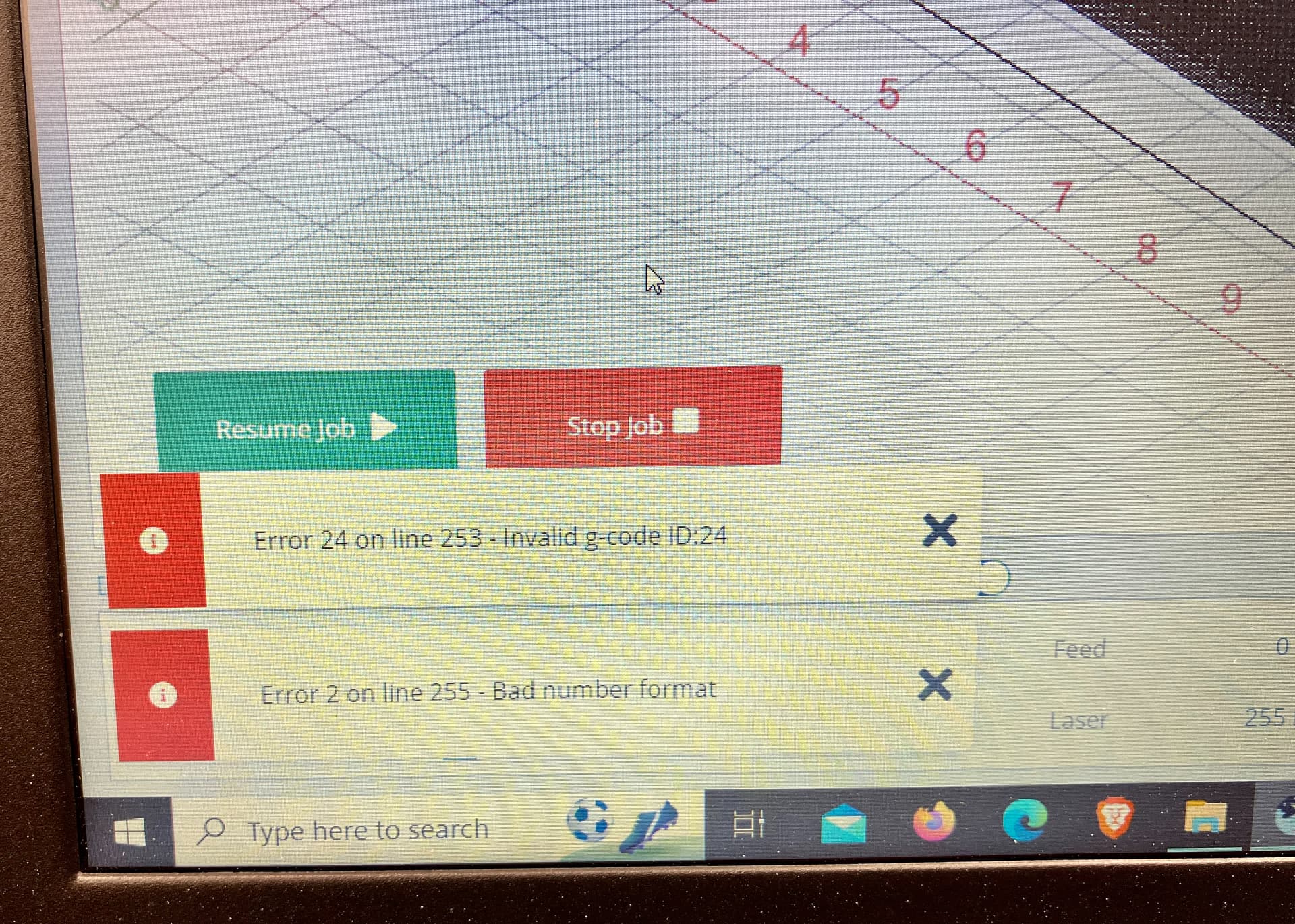

I never had issues with errors until the last update in G Sender. Not sure if settings changed or what. I’m trying to resurface my spoil board and sections keep getting missed then when its almost through it stops moving. Attached are some of the errors. Any Help WELCOME !!!
error in G Sender
And another new thing is it changes my work size into what seems to be interpreted as mm instead of inches because its like just under 2 inches instead of 49 :man_facepalming: I design it in inches in vcarve pro and my g sender is set to show in inches. Would I not use the grbl inches post processor??? When I use the mm one it shows up correctly but then was not cutting correct tho. I’m really confused whats going on :confused:
The controller natively works in mm. Setting your post processor to GRBL mm instead of inches doesn’t mean you need to change units in the design or CAM process, everything should automatically calculate itself on the back end.
Can you post your gcode here?

What post processor are you using? You’re not specifying a unit, so it’s reading in mm. That said, you have movements over a meter in length.
Are jog movements correct? Can you post your grbl settings?
Not sure yet about the errors, but looks like it might be communication issues.
