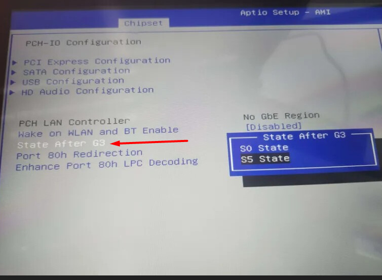

I’m in the process of commissioning the 4x4 Altmill and so far the assy. and initial movement is all good. Now I’m waiting on a spindle (theoretically here Sat).
Anyway, my question here is this: does anyone know how to set the bios on the gControl pc / tablet to boot when power is applied (no fiddling with the down facing button). I want to have the PC and gsender controller come on together via switched power strip.
In my experience there is typically a setting in bios that determines how the system is to proceed when power is initially applied. Generally the choices are [off|on|last state] or similar. In this case, I was unable to find anything that looked familiar but I eventually found the following (seemed a long shot and did not work)
: Access bios by repeatedly hitting del; Select -ADVANCED; Select-SUPER I/O CONFIGURATION ; Options here are- ā€œRestore AC Power Loss By IOā€ - Options are Last State / On / Off .
I don’t know what ā€œSuper IO Configurationā€ is good for but thought it looked promising. At this point I’m stymied by the lack of information on the bios (American Megatrends (AMI) bios v.5.27 (on the one I have)) that would indicate if it’s even possible in this case.
Is there a technical resource for the guts / nitty gritty of the gcontrol bios?
Silver bullets are welcome, I’d settle for witty banter too.

I don’t have a gControl and I’m not having an easy time finding a manual although I did find one for v3.x.x. However, I did run across an article that said some settings may be hidden.
Press the ā€œAltā€ and ā€œF1ā€ keys to unlock the hidden settings on the AMI BIOS. If nothing happens, try pressing ā€œShiftā€ and ā€œF1ā€ or ā€œCtrlā€ and ā€œF1ā€ instead.
Worth a shot maybe?
Worth a try … let you know
thanks
Specifically, my understanding is that you want to change S5 to S0 in the bios in state after G3 to change the behaviour from ā€œStay off until button pressedā€ to ā€œPower on as power is restoredā€
