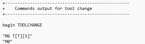

I did some changes on the post prosessor,
I did not change the speed on the different tools when using it.
So i added the
“M6 T[T][S]”
“M0”
[S] will save the new speed for the according bit.
M0 will pause the machine so it can speed up again,
Sure i want a command that pauses the machine for 5-6 second so i dont need to use M0

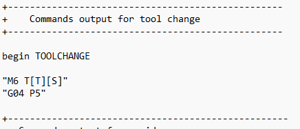

Can I use “G4” ?
Did a test here Changed the M0 to G04 P5
And that worked great, then my spindel has 5 second to spin up to rate before continue the job.
Stephens_Special_Toolchange_GRBL_IMPERIAL.pp (6.4 KB)
