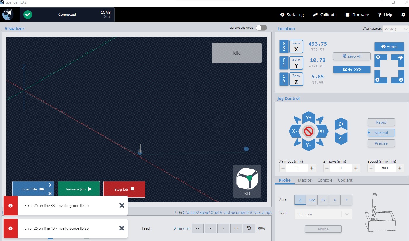

I can get something similar to happen, without any bad gcode. I think it’s a gSender bug. Here’s the setup.
  1. Create gcode with M06 (tool change commands) in it.
  2. Set gSender to handle tool changes via code.
  3. Put a pause command “M0” anywhere in the second code block in gSender.
  4. Run. I get the error as below.
If I use pause for how to handle tool changes in gSender there is no error. If I do not put a pause command in the second block, there are no errors. Even if the only command in the second code block is a pause command the error occurs.

OK, this is just getting weirder
 If I add the G4P0.1 command to wait for a tenth of a second after the M0 pause command, I do not get any errors. BUT, it skips one corner of the square that is getting cut in the gcode right after the tool change. See the gcode I attached earlier. Just the initial corner is missed. Like a part of the gcode got skipped over. I tried increasing the wait command up to a second and it was still occurring. Still, no issues are seen if the M0 command is not included at all in the last code block.

Any confirmation if this is still happening as of 1.0.2? I am unable to recreate it with M0 in either pre- or post- hooks. We made some changes in 1.0.1 to address it.
Cheers,
Kevin
Yes, it still happens for me.
This is the gcode file (From Carbide Create) Lamp1_gSenderTest.nc (26.1 KB)
Here’s the errors:
Here are the settings for tool changes:
If I just remove the “M0” command the errors go away.
