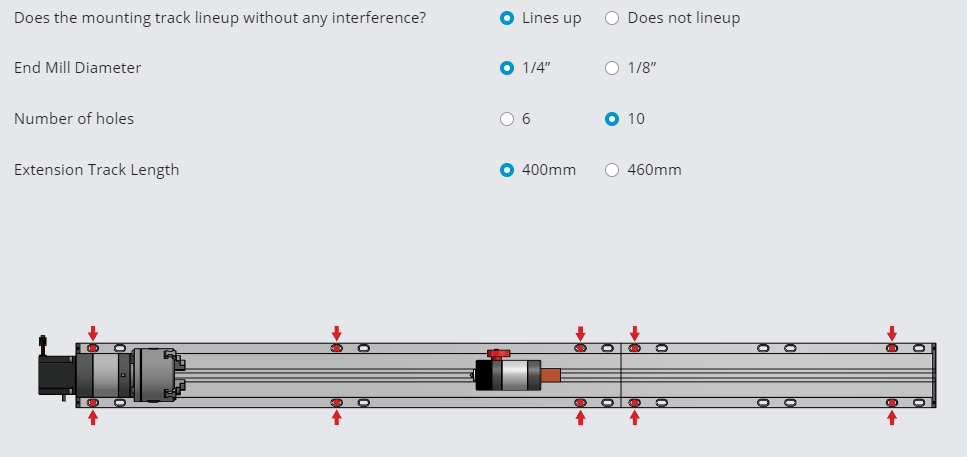

Quick release, mostly to support new Vortex tracks and the upcoming 2x4 AltMill
  • Added new machine profiles for Altmill 2X4
  • Added support for new rotary track options

@KGN Can you explain for simpletons like me what ā€œrotary track optionsā€ are, please?
The rotary mounting tracks - the extension track has a new pattern so there needs to be a toolpath to support it.
@KGN That makes perfect sense. Tks, Kevin.
