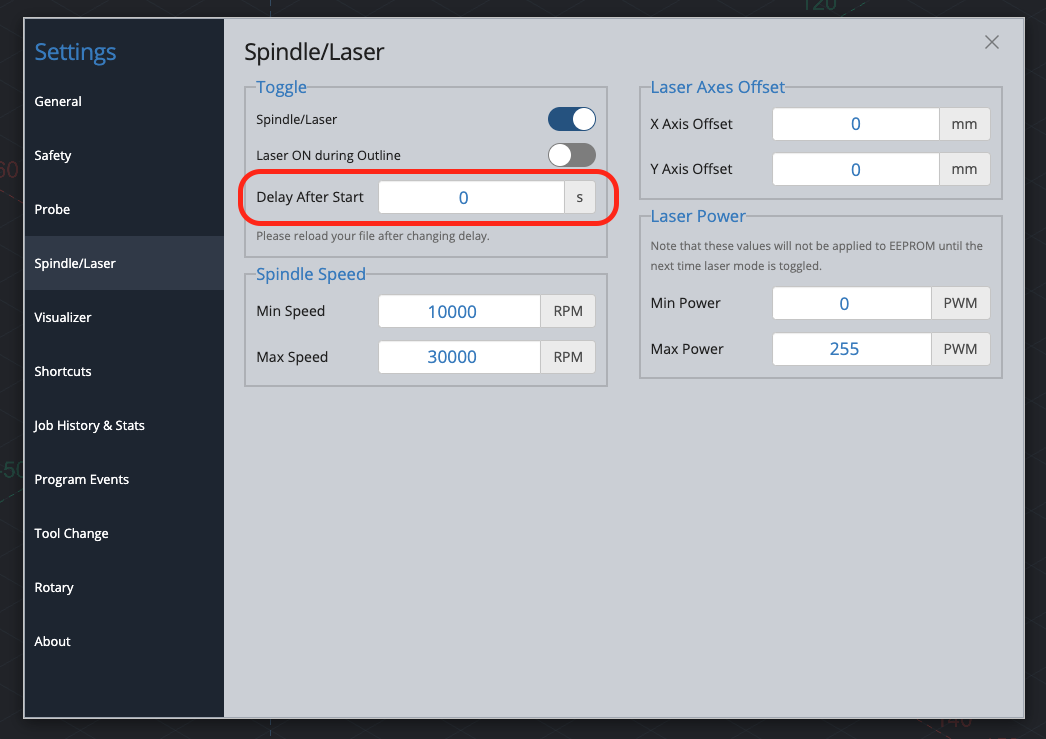

do i understand this correctly ? if i add 5 seconds, this moves the machine after that time?
if that, it’s awesome since i have a spindle that it is configured to spun up over 5 sec
That is correct, this adds a delay to the spindle turning on at the start of the job.
For clarity, this is in the spindle table within the settings now:

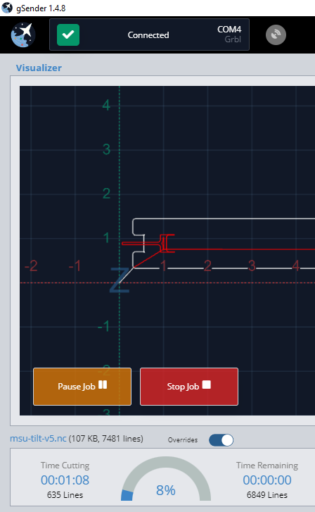

Hello!
Had ā€œEstimated Remaining timeā€ issue over the week-end.
I ran multiple variants of the same project using GSender 1.4.8 and was getting a Zero duration job, the job was around 10 minutes realtime.
See ScreenShot below (shows 8%, but 0 time remaining)
Then, wanting to see if it was related to the .nc file and/or the Gsender version, i ran again using Gsender-Edge 1.4.0 and di not get the issue.
The 1.4.8 release notes state ā€œbetter estimated remaining timeā€, don’t know if my file is a edge case…
Here is the .nc file, if it helps (Created using Carbide Create v6)
msu-tilt-v5.nc (104.9 KB)
Hey friends, quick release with correct time conversion for time remaining and a few other changes.

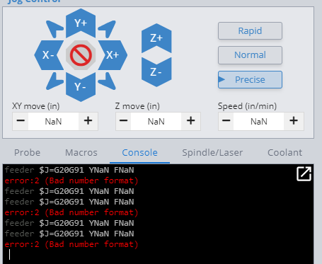

Go one strange behaviour today…
Used 1.4.9 a few weeks ago with no issues.
When i started my session today, GSender would home, but no manual jog was possible.
Looked at the console, and sawt his error message:
ā€œBad Number Formatā€
It is then that i saw that my XY Move/Z Move/Speed values where NaN for all three presets.
I re-entered the values and all was resolved.
Do not understand why those values may have fly away…
Verified GSender-Edge instance (one at a time) and it was good (running 1.40 i think)
Hope this helps somebody that my encounter this error message!
