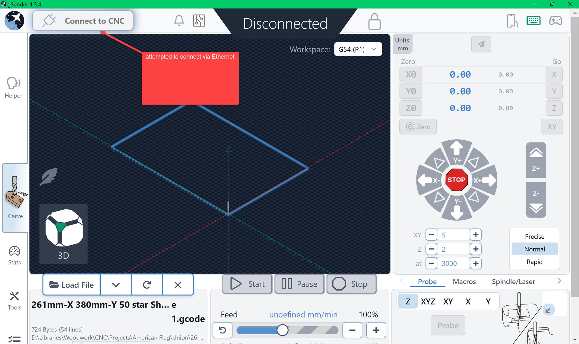

I’m going in a huge circle with this issue and know not what to do. I’ve had success with gSender 1.5.4 connecting to my laptop, but I was getting a huge amount of random “Port Disconnected”. I was using a USB connection. I setup the Ethernet connection and made a 20-minute cut successfully.

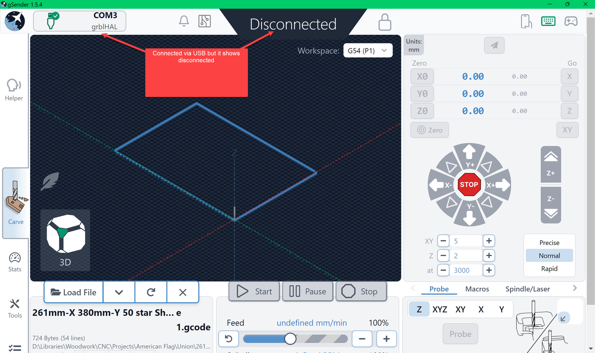

Today, I was going to make a cut, but now I cannot get gSender to work with the Ethernet or the USB. I had ordered and received a high-grade USB cable and was going to test it. Following is what I see when I use the new USB cable.
I switched back to the Ethernet and see the following when I attempt to connect.
I rebooted my laptop (Win11) and tried the two different connection methods (Ethernet and USB), and get the same failures.
In the recent past, I was able to connect and cut with the USB or Ethernet connection.
I upgraded to 1.5.7, and it is making a run without issue. I’m connected via the high-grade USB cable.
