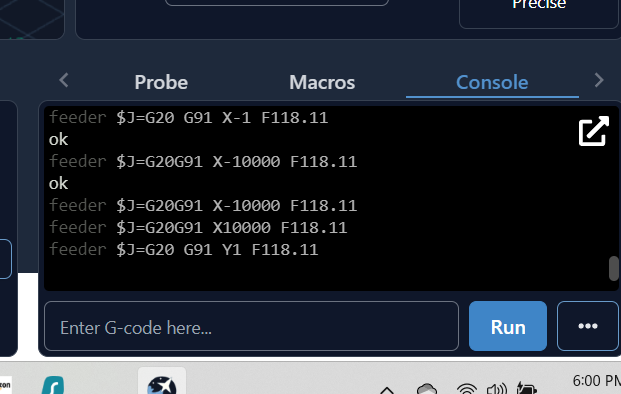

Hi Chris, the new release hasn’t resolved the jogging problem on my system. When i first open gSender I can only jog the spindle a few times in any direction before it freezes. This normally coincides with a change in the gcode seen in the console screen. Ive attached a screen shot for you to see. When it jogs correctly the code is $J = G20 G91 X-1 F118.11 (i work in inches), When it freezes the code becomes garbled $J = G20G91 X10000 F118.11 and the X value is now at what I assume is the maximum. Even trying to jog in the Y direction is frozen despite showing the correct format for the gcode. The only way to get the system to work again is to reboot gSender but the jogging will just freeze again at some random point in any direction. This was also reported in the 1.5.0 thread from a user using a different computer, different OS, different CNC, etc so it is very unlikely that it is anything but an odd bug in the software.

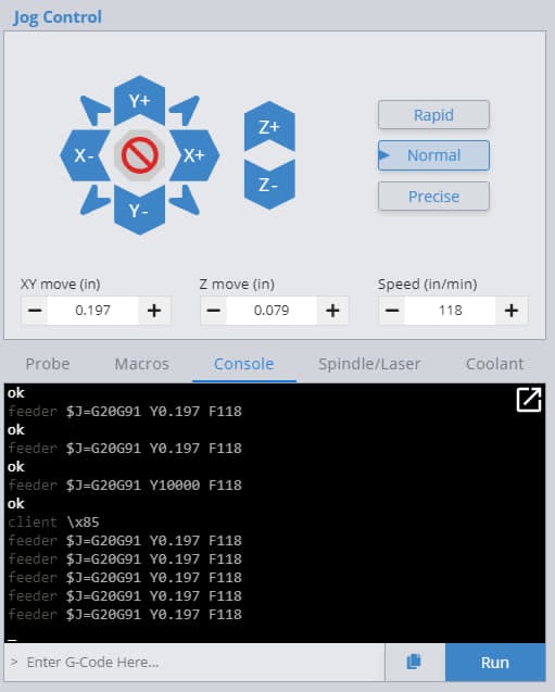

I’m having the exact same issue. I home my machine, and can jog around a little bit before errors sometimes. for several minutes of just testing the jogging, sometimes within only a few moves. I thought it was related to the 1.5 update, so I uninstalled it and went back to 1.4.12 but still had the same issue. I also tried the 1.5.1 which hasn’t resolved it.
Currently I’m back on 1.4.12 and its affected too. Perhaps I need to do some form a clean removal. I only used add/remove programs, and then renamed the gsender folder in %appdata%
Every time it becomes unresponsive there is a jog command telling it to move 10000 inches.
Once that is sent, I’ll get a client \85 reply and then even though the next jog commands are sensible, there is no ok response in the console and jogging wont move until I disconnect/reconnect.
