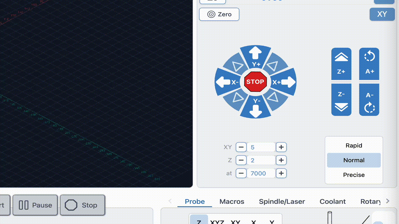

Hey Trig, I think I’ve found something out. Mine seemed to stop working randomly, but it turns out if I didn’t click fast enough it would thing I’m holding the button and try to do a continuous move. Whenever this happened it would stop responding to future commands. I was able to replicate this by purposefully clicking and holding the button. Whenever I did, it would send the G20G91 move command with the value of 10000 and then always fail to followup or respond afterwards until reconnecting to the cnc.
I found a workaround and wonder if you could try to see if it’s true for you as well. Go to your Gsender settings and change it from inches to mm. Then try to do a continuous move while pressing and holding a jog button. You should notice that the jog command changes from G20G91 to G21G91 (since you’re now in metric), and at least for me will do a proper continuous move and continue to work afterwards. I don’t know if this is related to some unit conversion that is happening behind the scenes or what, but for the time being I’ll just work in mm.
Hey Twistthem88 (great handle) I just read your note and will try it out shortly and will let you know the result. Thanks!
You absolutely nailed it my friend. There is obviously a bug in the conversion code that crashes the system when it has to convert too quickly. The code then becomes a mix of a G20 command and metric units! This should be something that the gSender people can track down quite quickly, there must be quite a few people who want to work in inches who are affected by this bug.

@tme I can see your issue is the same as what I noted for @Tig and @Twisthem488 above with the 10000 inch jog movements which is causing your jogging to not work. We’ll have a fix for that out in 1.5.2 which should be released tomorrow, then you can let us know if you’re right as rain again!

  • Continuous jog without soft limits now sends more sane values when jogging in Inches across both controllers (used to be 10000)

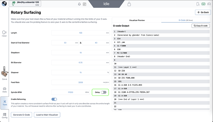

i can confirm that spindle delay does not work in the latest versions 1.5.1 1.5.2 it worked before in 1.4x

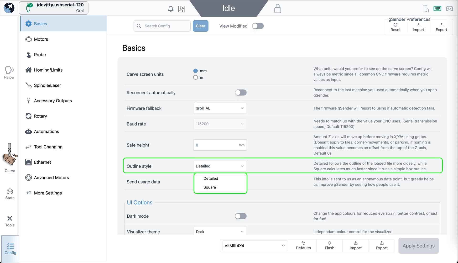

  • Outline Mode Options: Choose between Detailed (original toolpath shape) or Square (bounding box) for outlines:

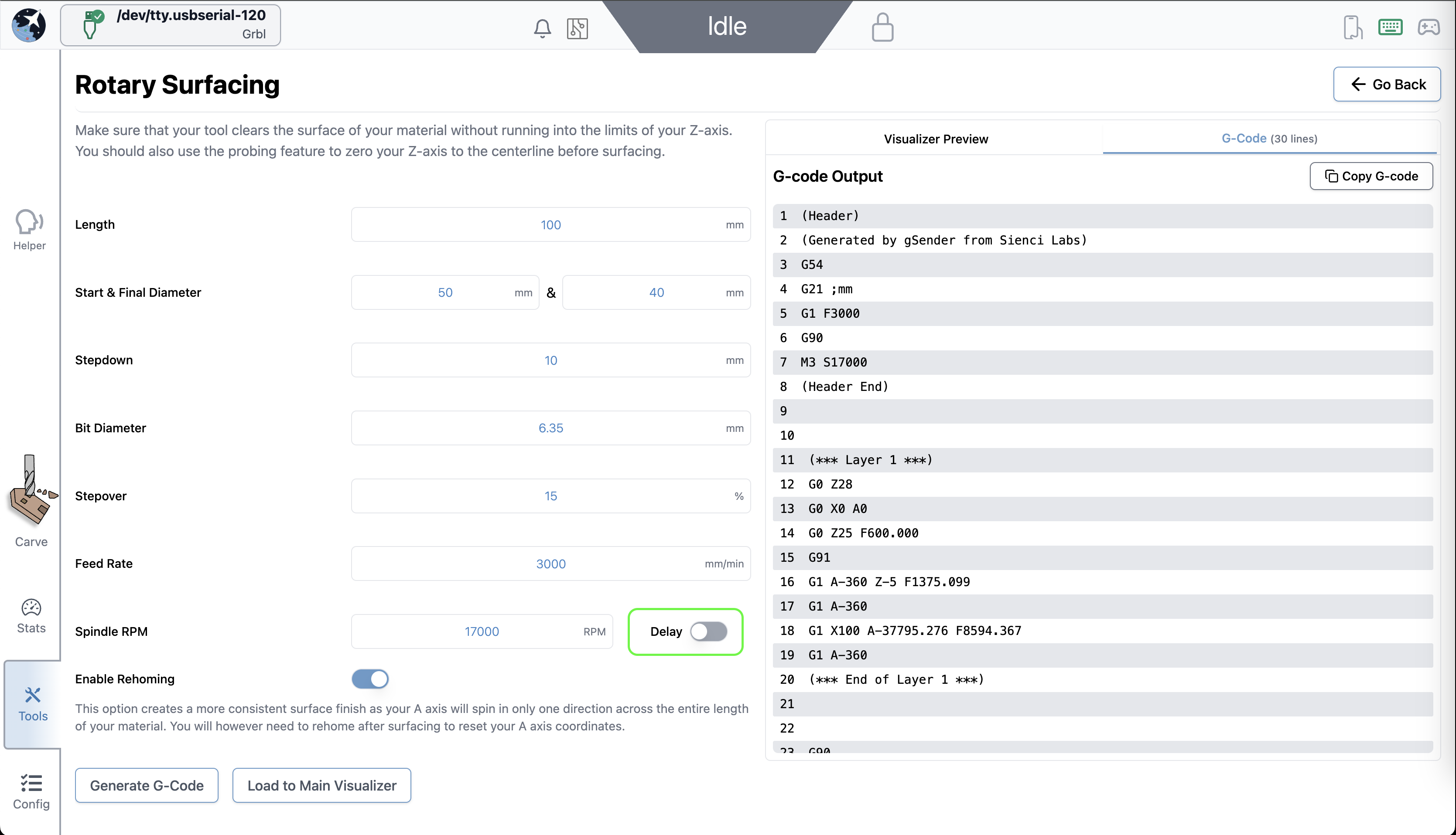

  • Spindle Delay for Rotary Surfacing: Added an option to fine-tune spindle behaviour:

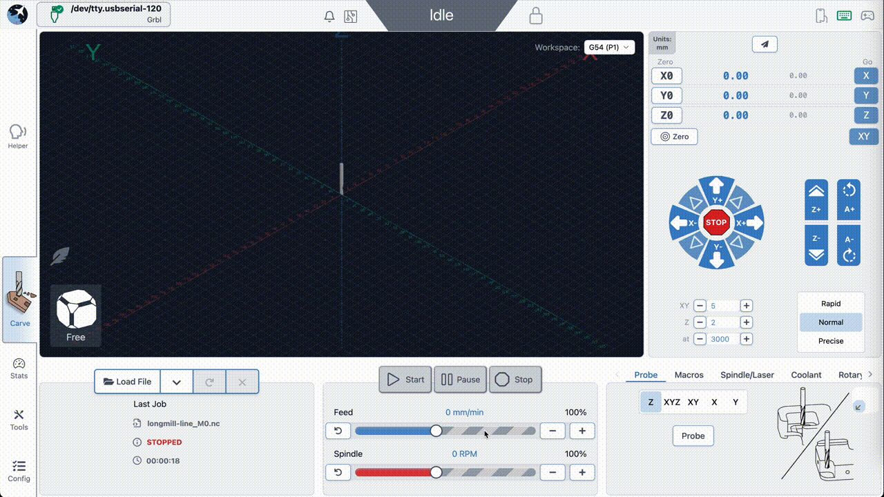

    • Reintroduced plus/minus buttons for jog feeds/distances with more intuitive behaviour:
      • Screen Recording 2025-08-05 at 6.34.53 AM
