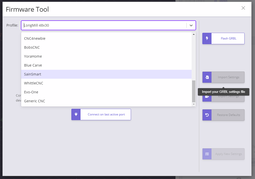

I have a Genmitsu 4040 pro cnc (SainSmart company ), and when I try to connect gsender to it, the connection dialog box shows connecting but never does connect. It does show connected to the com port without a problem, so the USB cable is being recognized by my W11 laptop.
I have no problem connecting UGS or Candle, and I don’t have either open or connected when I try to connect to GSender.
I’m new to this so my troubleshooting is a bit limited in terms of experience.

I ran into this also, and found that gSender would finish connecting after I manually triggered an endstop. Not sure why, or how to get around it? But that has been working for me.

I did it manually. The Z end stops are the easiest to access. Just reach in, and give it a tap for a second or 2. It doesn’t care which one to finish connecting, and access the motors.

Have you flashed the right machine settings into G-sender?
Never mind… In see this is an old topic. Did you sort it out eventualy?
Hello Eddie! The problem was trying to connect to a machine that simply wouldn’t recognize Gsender, or more likely, Gsender didn’t recognize the machine. Either way, I initially resolved this by using an app that was very basic - Candle I believe - but lacks the features of Gsender.
