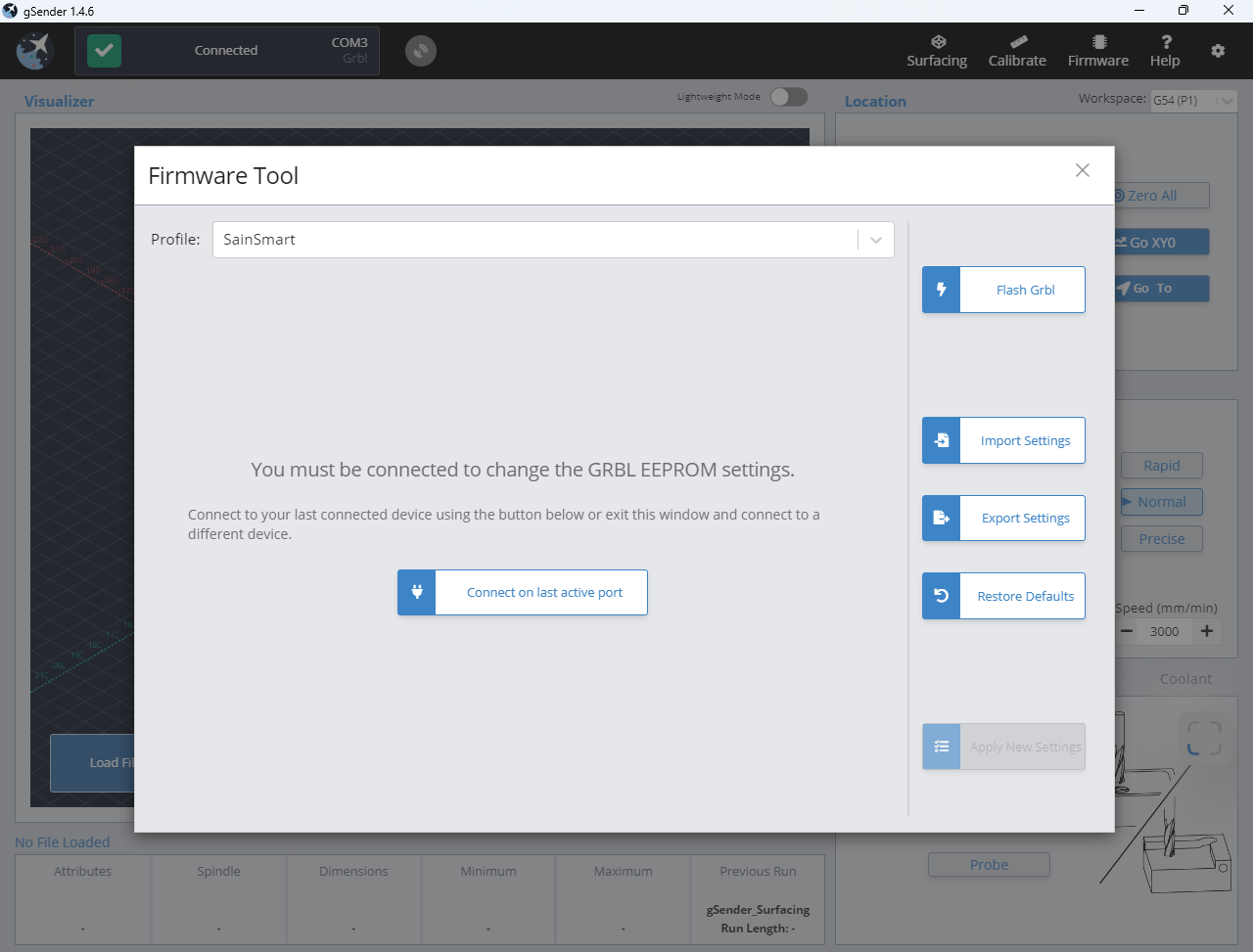

Obviously this is not a big deal but the first thing I do when I turn on my cnc is to home. My current work flow requires I go into firmware, then manually click connect to firmware, then homing is enabled.

Thank you for the response. I am running a Genmitsu 3030. gSender version 1.4.6. Happens every time I start up, very reproducible.
First screenshot is on initial start, I manually have to connect to the printer via dropdown (another step I am assuming can not be automated)…note that the homing is NOT present:
The only way for me to get it to appear is to click on firmware and then click the presented button :

I think this is more a long-standing issue with non-standard startup messages. You should be able to type ?? in the console to get it working correctly but it’ll require some changes to startup logic on our end for vanilla grbl long-term - basically we don’t send the $$ command until we see a startup message from the controller, and if that startup message is too different from what’s expected (IE doesn’t match regex) it won’t automatically send the command.
One helpful thing would be to share what startup message you get on connection. EG:
Ok…so ā€œreconnect automaticallyā€ is working to connect to the usb controller automatically but the firmware issue is still occuring.
@gwilki : I am not attempting to do anything with my firmware other than have gsender recognize that I have endstops on my machine and allow me to use the homing functionality. Clicking the that firmware button is the only way I have found to do this.
@KGN : Please forgive me if I don’t understand your question. Below is the output of console on boot and after I enter $$. Entering $$ does indeed provide me with the homing button. However, if I shutdown gSender and restart I am connected to the controller automatically but again without a homing button. Please let me know if I can give you any more information.

When you first connect, what is the message in the console? Don’t send anything. Just copy the ā€œwelcome messageā€, which is the first thing you’re controller reports to gSender.
This is what is present in the console after a fresh reboot of gSender with auto connect enabled

Huh, do you just not have a startup message at all? Even if you soft-reset? Interesting - we’ll see what we can do in that situation.
I’m working a little blind here…I don’t see anything that resembles a reset button. There is a reload icon on my offline controller…when I select that it sends the following…
client ?
<Idle|MPos:0.000,0.000,0.000,0.000|Bf:35,254|FS:0,0|Pn:RHS|WCO:-80.000,-140.000,-75.346,0.000>
Grbl 1.1f ['$' for help]

This reloading, resulted in me having a homing button…me not having to click ā€œConnect to firmwareā€.
However, I tested again…once plugging the machine in first (usb), then starting gsender…this is my normal work flow and resulted in the original issue (manually having to connect to firmware). The second test, I started gsender first, then plugging in usb…in this scenerio I had to manually connect and it resulted in the same issue.

It might just be your grbl is compiled without a startup message which is an edge case we’ll need to handle - I see arm32 in your screenshot which leads me to believe you’re not running a vanilla GRBL/arduino setup.
