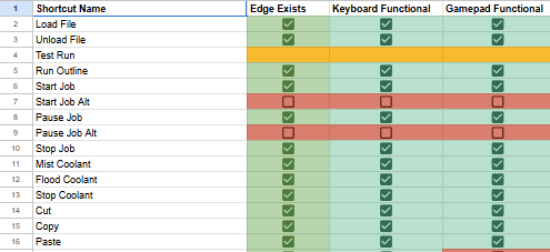

@chrismakesstuff OK, I just ran most of the shortcuts. To remind you, I am running a Mk1 with the SLB connected via ethernet.
Connection was good. GUI worked fine.
  1. all the ā€œzeroā€ and ā€œgot to zeroā€ shortcuts worked. Note that the heading for Go XY needs to be fixed.
  2. Jog X and Y in both directions does not work. The movement starts with a series of jerky movements,then it runs smoothly. However, releasing the keys does not stop the jog. It continues until the gantry hits the stops or the GUI Stop button is clicked.
  3. There are no Jog Z shortcuts.
  4. Pressing shift+1 to jog A+ does not jog. It puts the machine into Hold.
  5. Pressing shift+2 to jog A- does nothing at all.
  6. All the speed shortcuts work.
  7. Load and unload job work.
  8. Start, Pause, Stop and Outline do nothing.
  9. All the F key commands to open pages work.
That’s as far as I got. I didn’t test the others yet.

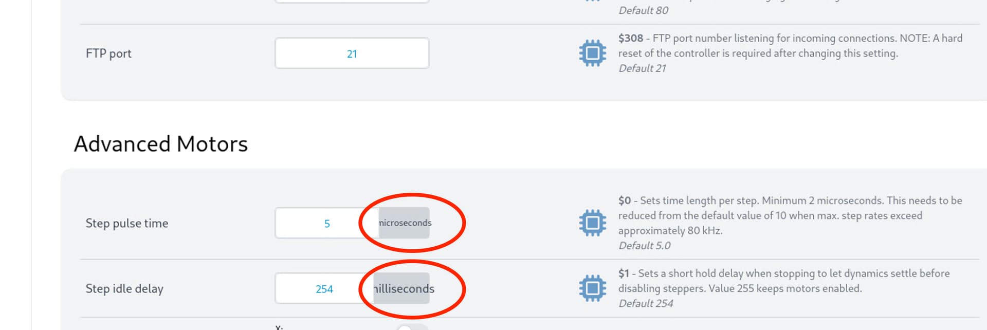

I did miss one font/spacing issue in the firmware description area. Screenshot attached.
@chrismakesstuff OK, I just finished looking at the remaining shortcuts.
  1. I locked the machine with the etop. Unlocked the estop. GUI showed locked. Shortcut $ did nothing to unlock it.
  2. I’m not sure what a soft reset is, but % appears to do nothing.
  3. The cut, copy, paste and undo shortcuts are the same as the standard windows shortcuts. I didn’t test them in gSender as it was not clear to me what I was supposed to be working with. Meaning, how does one select something in gSender on which to perform these action?
  4. I don’t know what the shortcut key for toggle shortcuts is.
  5. Realtime report does nothing.
  6. Clear errors does nothing.
  7. Acknowledge tool change is irrelevant for my setup.
  8. I don’t understand what toggle virtual stop means.
  9. Switch workspace mode seems to do something, but I’m not sure when or why I would ever use it.
  10. As I reported previously, the shortcuts for selecting speed modes work well. However, even though the screen display changes from mode to mode, the actual jogging speed does not. So, with precise selected and the jog rate of precise showing on screen, the machine actually moves at the same speed as when selecting normal or rapid. FWIW, this makes using Edge5 a non-starter for me, since, when trying to slowly lower the bit to get it close to touch plate, I use precise mode. However, in Edge5, there really is no precise mode.

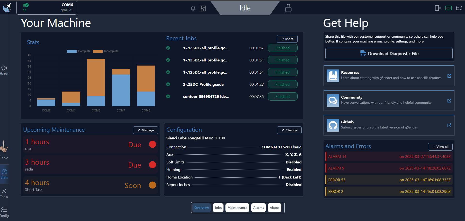

I like the new design! I spent some time clicking around but haven’t run any jobs yet, will post if I find any issues doing so.
Longmill MkII 48x30 with USB SLB connection and Closed Loop Stepper Vortex plugged in
Issues seen in 1.5.0-Edge-5:
  • Config > Spindle/Laser, Advanced Motors, More Settings heading highlights
    • Right side menus change but heading highlights do not go to selection
    • Highlighting animation stops prior to actual selection, depending on direction
      • On Probe > click Spindle, highlighting stops on Homing Limits
      • On Automation > click Spindle, highlighting stops on Jogging
  • gSender does not reconnect automatically on startup if SLB is already powered up
  • Vortex is attached, have not tried disconnected yet:
    • ā€œRotaryā€ tab was already enabled, disable does not hide tab
    • ā€œNewā€ tab is a duplicate of ā€œRotaryā€
  • ā€œSpindleā€ tab was correctly hidden by default, but subsequent disabling does not hide
  • Rotary GCode visualization looks different/minimal vs. gSender standard release

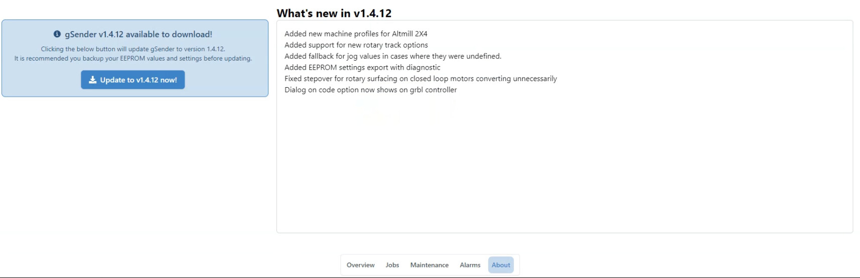

Update prompt now has patchnotes for the next version before you update:

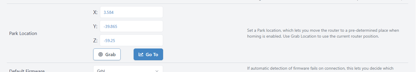

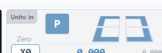

You can configure a park location to move your router to consistently at the click of a button:

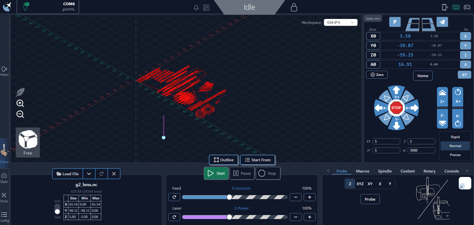

Hello again,
Seeing so much great feedback, tests results and upcoming stuff in this thread had me going back to Edge 1.5.1 EDGE 5 this morning for an additional overview.

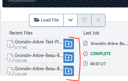

I noticed the ā€œQuick loadā€ buttons (Not sure of the actual Trademark name) …
Do actually load the job, but the visualizer is not updated with the file design.

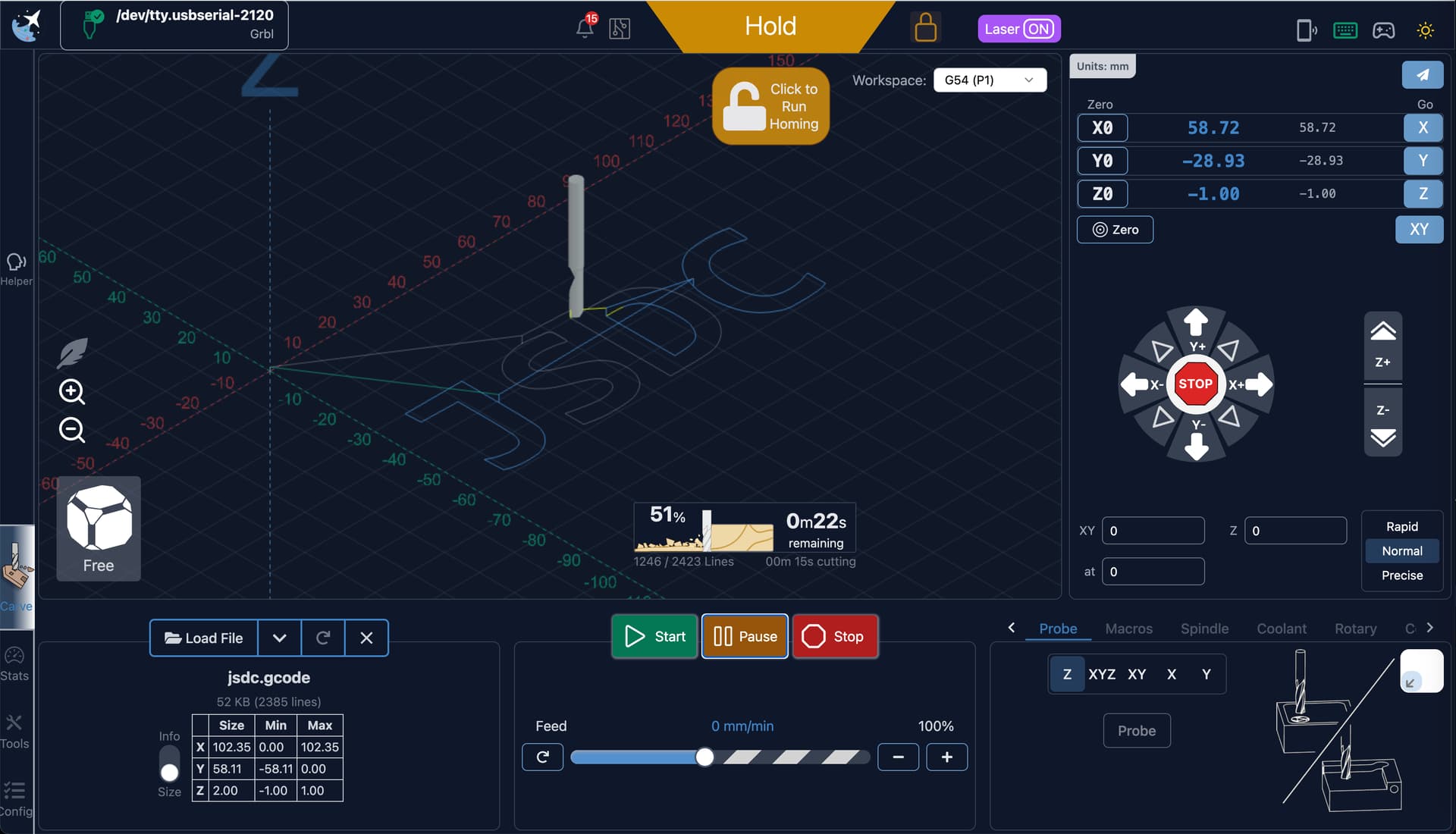

  • Single click jogging is fine at any speed setting, but press & hold seems to move at Rapid - even on Precise. Quite a surprise when trying to fine tune the bit for Z-Probe on the Vortex!
    • That may be what gwilki was seeing and KGN was referring to as being a focus
  • Searching in Config immediately locks up the whole application once you start typing in the box, forcing a quit and restart.

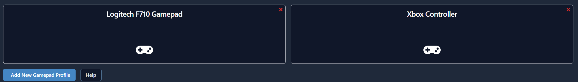

I have had issues with Gamepad analog joysticks, not recognizing Y axis but it’s a generic device and trivial to the overall functionality of the software.

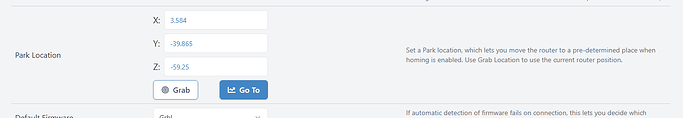

Park Mode
We’ve added a new functionality for machines with limit switches and homing enabled called Park. This function lets you configure a set location, and pressing the new UI button will safely move the router to that location. There’s a number of possible use cases (for example, setting the location close to the front for bit changes or near the back to move the router out of the way to clear your workpiece) and we’re hoping it’s a nice convenience for most users.
You can find the functionality on the main UI near the rapid position buttons if you have homing enabled. The behaviour is to move just below Z max height, move to the configured X and Y, and then finally move down to the configured Z location.
The park location itself is set in Config (Basics → Park Location) and has convenient buttons to both grab the current location and go to the set location to verify it’s accuracy.

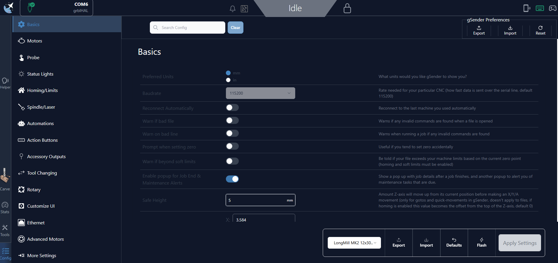

Long asked for, we’ve added Dark mode to the gSender UI.
You can toggle it on with the click of a switch in Config (Customize UI → Enabled Dark Mode).
While there’s still a number of readability tweaks we’re planning to make, we’re very happy with the look and feel of this and hope it becomes a popular addition to the software.

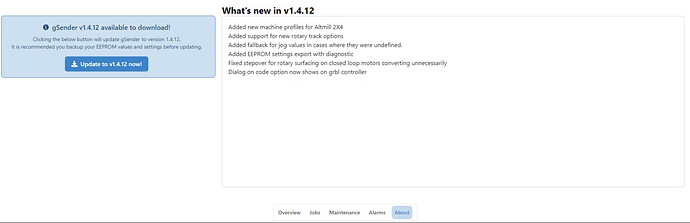

gSender Update - more info available
We’ve made some tweaks to how gSender informs the user when an update is available. On top of our beautiful bouncing boy on the logo informing you when a new version is available, clicking that now takes you to the about page, which now includes Patch notes from the new version so you can check what’s changing before you update.
On top of that, we’ve added a percentage indicator when downloading so you know how long you have left.

  • Macros running state and animation returned. Editing and adding macros should behave the same, closing the modal.
  • Added numerous missing config options
  • Updated some config behaviour to hide options based on other selections
  • Added Default Firmware, which is used as the fallback controller option in cases where connection cannot determine which firmware it is connecting to.
  • Numerous jogging behaviour and jogging area look/feel changes.
  • Jog values again editable
  • Added missing jog config feedrate options.
  • CW, CCW for spindle commands have been renamed to For and Rev in several places for consistency with most VFD labelling.
  • Consistent look/feel on units in Config area.
