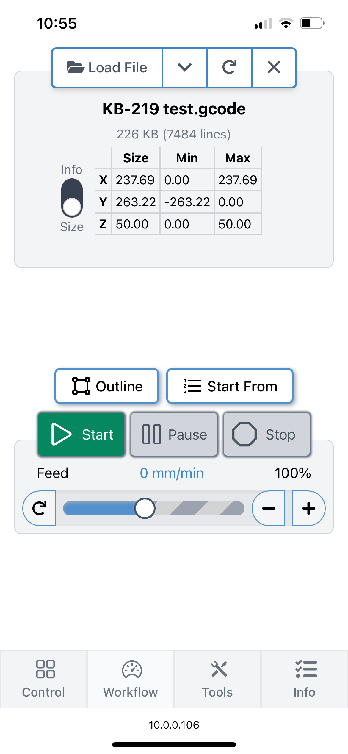

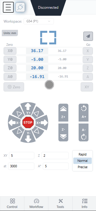

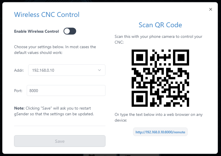

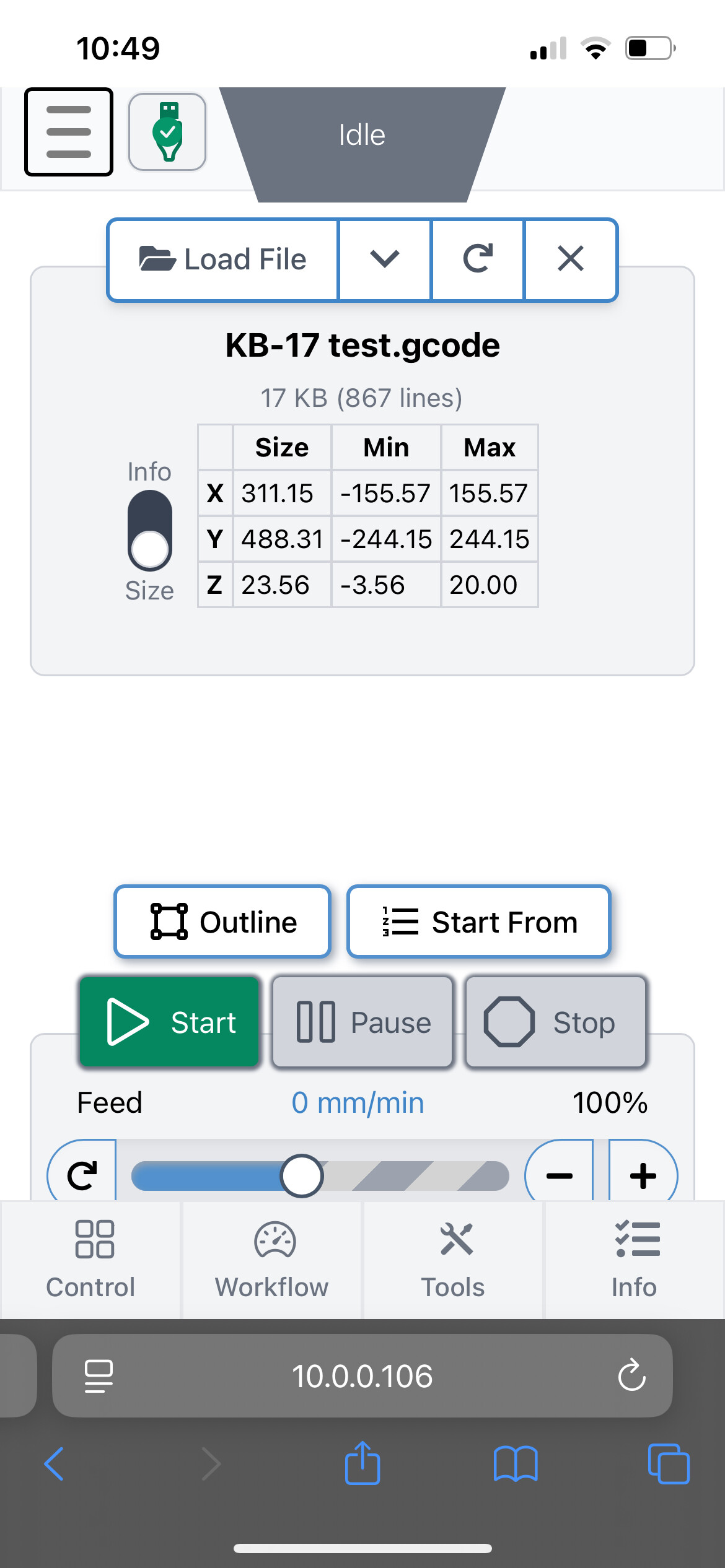

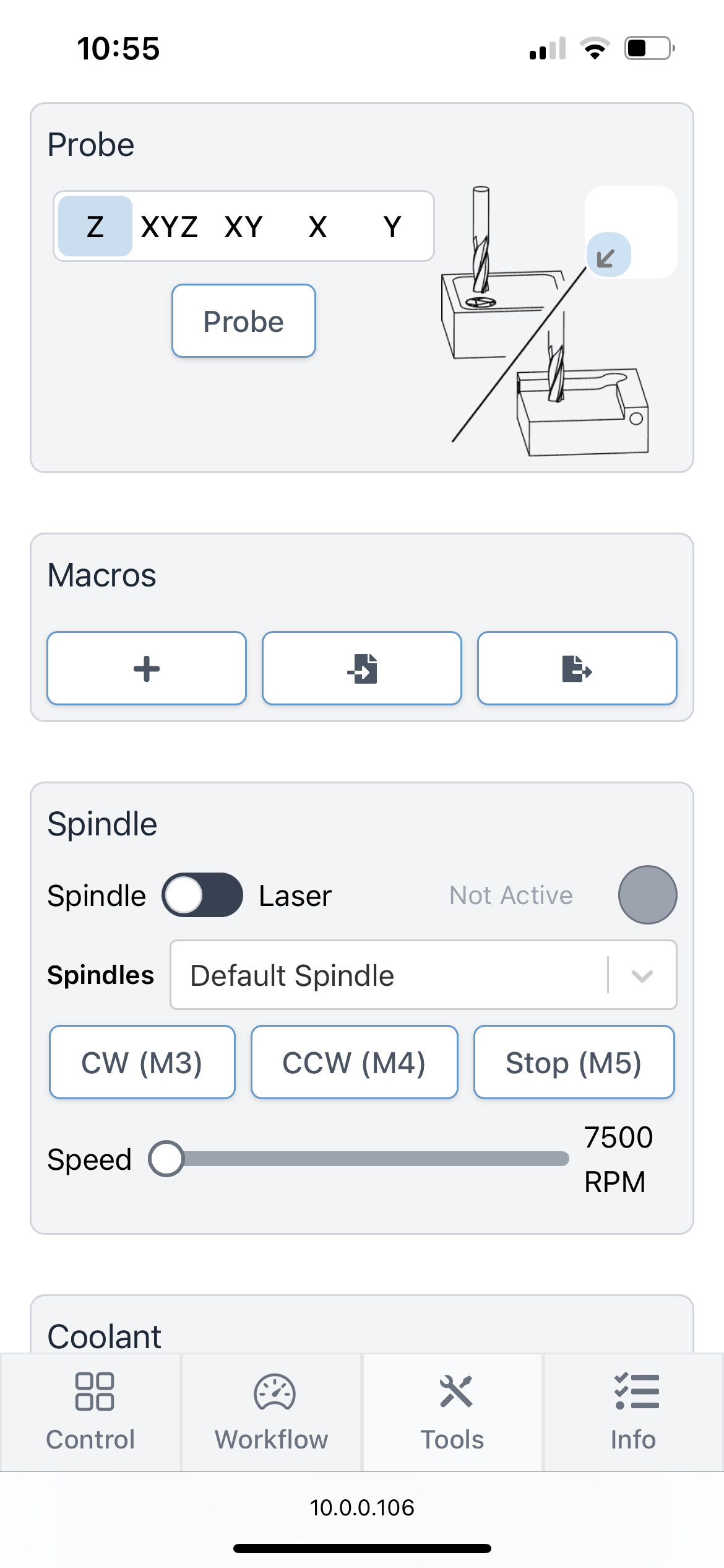

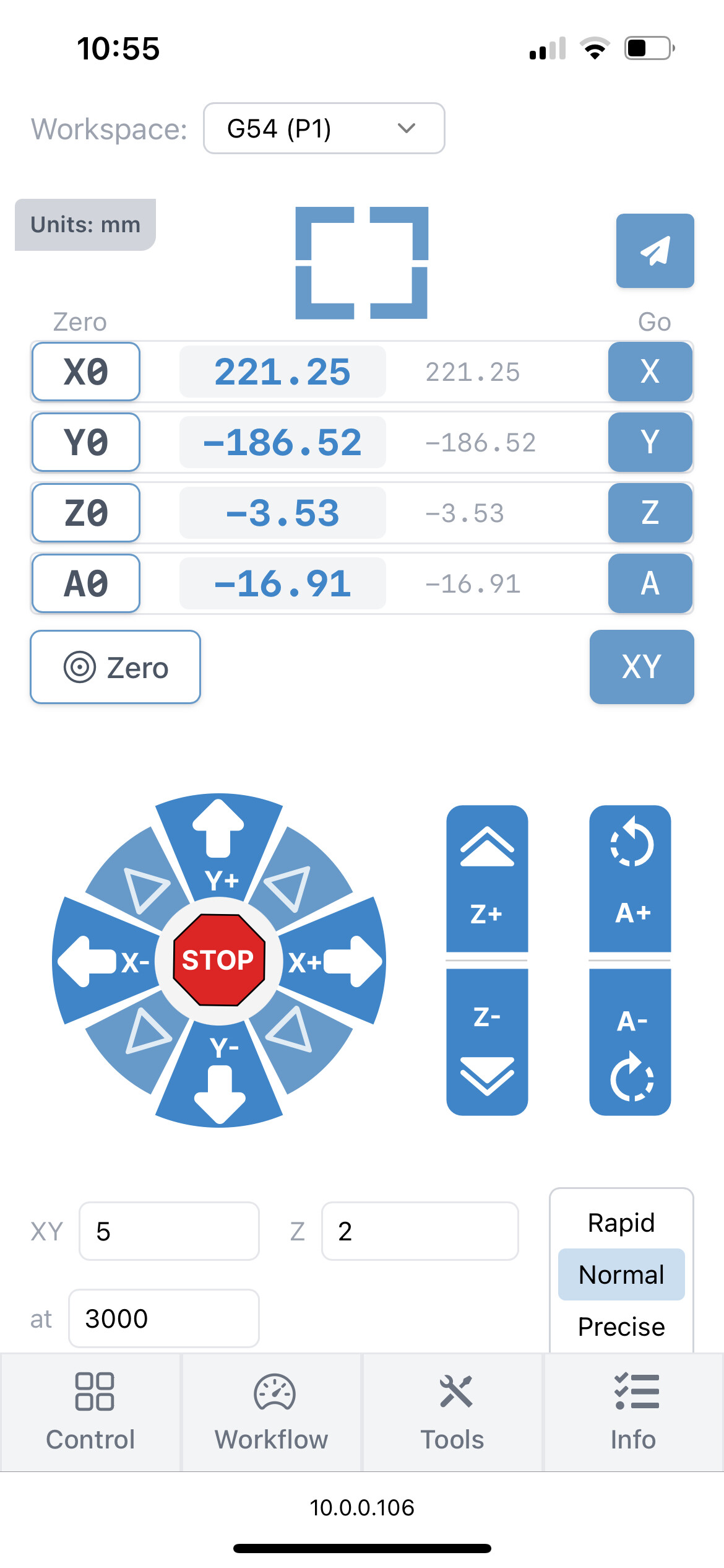

Updated Remote Mode/Wireless CNC Control
Remote mode (now known as “Wireless CNC Control”) is back and better than ever! We’re exposing more functionality and will continue to expand this in future Edge releases. We hope that by splitting up functionality into navigable pages the user experience will be improved and we’ll have a much more usable remote interface on the phone. The plan is to get configuration, stats and remote tool changing all present in a future build.
chrome_kOKnAMW3M1
You’ll notice that the phone interface is now located at a separate link, “/remote”. The QR code has been updated to link to this for easier navigation.

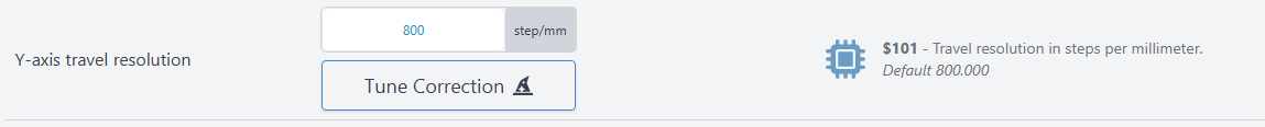

Even more Config Updates
Some sections now have relevant pins and functionalities available on the config page so you can test as you configure.

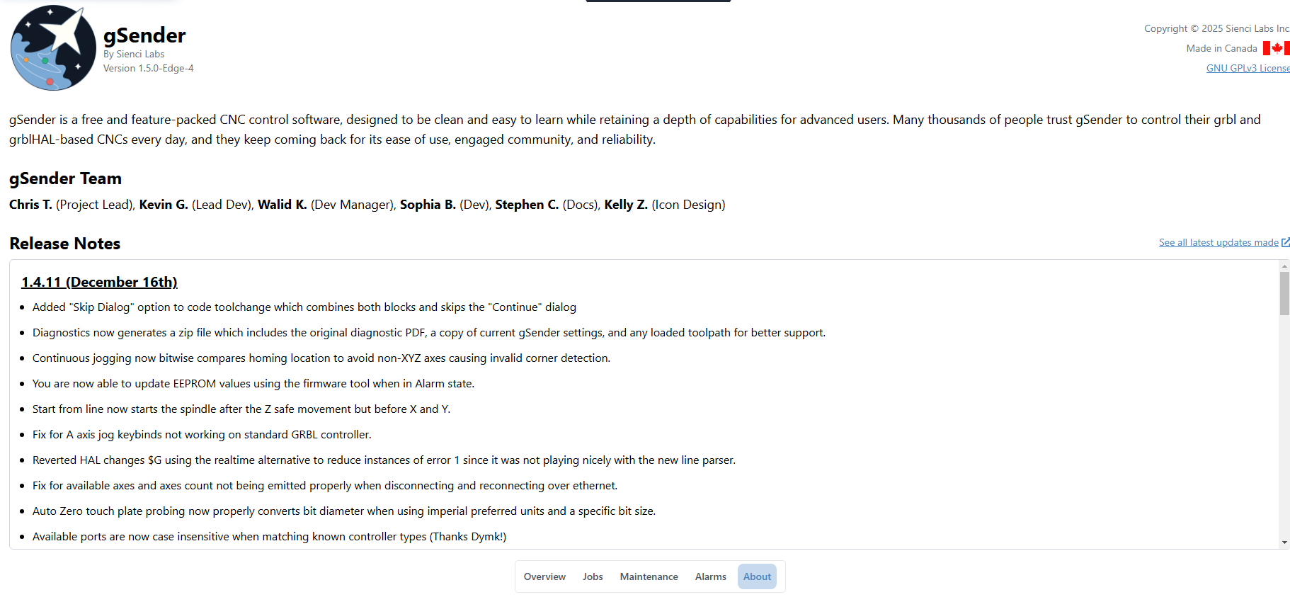

About Page
You can find this again in the Stats section. The plan is to also include update information here, so you’re able to see what’s new in updated versions of gSender before actually updating.

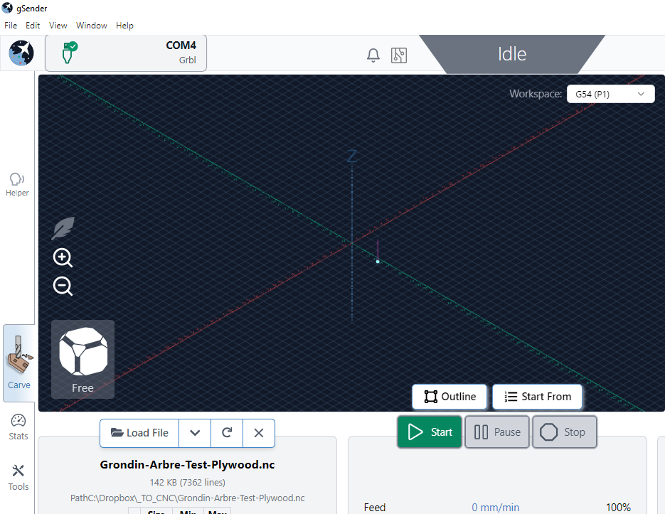

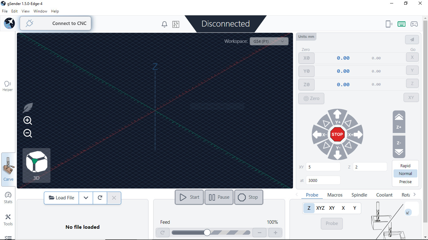

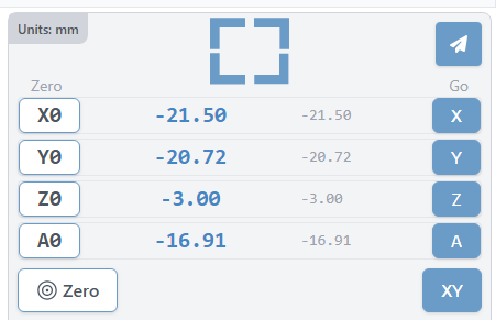

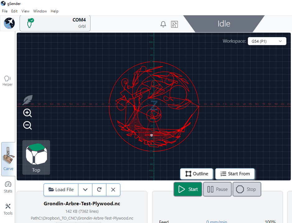

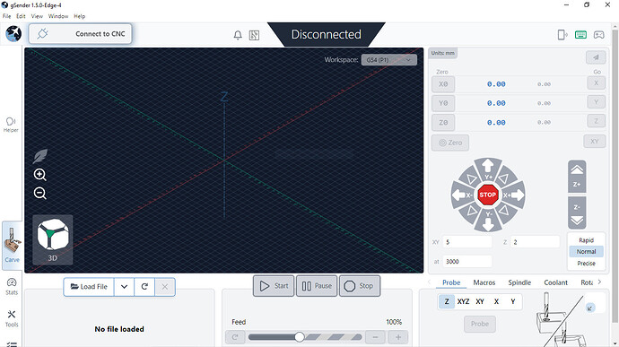

OK, I’m sure this is a stupid question but where is the Home button?
Hello!
Experimented this morning with new version:
I do have the same “Where is the Home button” Question
Also, i do not see the “Test Run” button (Or maybe it is now done at loading time) (Configurable?)
Here is what i encountered:

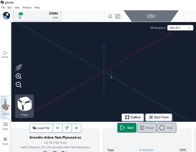

After loading my file, i placed the visualiser the way i wanted:
…but then remembered i wanted to test the “standard” tool change wizard, so i went to the “Settings” Tab, changed the setting and came back to the “Carve” tab and although the file was loaded, the visualiser did no longuer show the file preview.
After a few manipulations (reloading the cut file each time) i saw that it does the same thing when switching to any tabs outside of the “Carve” tab, and then back.
Once i arrived to the “tool change” Popup, i noticed a Typo in the message:
Note: This is my first time experimenting with the “Tool change Wizard”
I then read the message a few times…
The next step i wanted to do was to rezero the Z axis with new Bit.
I was unsure which button to choose. I picked “Closed Window” and then got back to the GSender GUI with accessibility to the job & zero tools, great, but was no resume, just start… At this point, my job seems mid-way cancelled… :frowning:
So the “Close window” was a “Cancel job”?
So i really seems that i should have picked “Resume Job” to jog/zero, then resume?
Is it me (newby to tool change) or the message or buttons require a bit more explanation?
Additional infos:
Also, tested in Laser mode, saw the “LASER ON” state on op of the screen, I think it should be more visible (or RED, or blinking)
Also, My Laptop is running at a 1366x768resolution.
The new GSender look, forces a vertical scrollbar on the right.
I do not know what would be Gsender’s recommended minimal resolution (Or Windows Scaling) (I am running WIN10)
See below the screengrab with the Windows Taskbar hidden (I prefer it visible) but prefer no vertical scrollbars, if possible.
When the Windows Taskbar is visible, the X/Y/Z “Precise” button is partially chopped off.
Aside from these reports, i really like where GSender is going…
Great job…

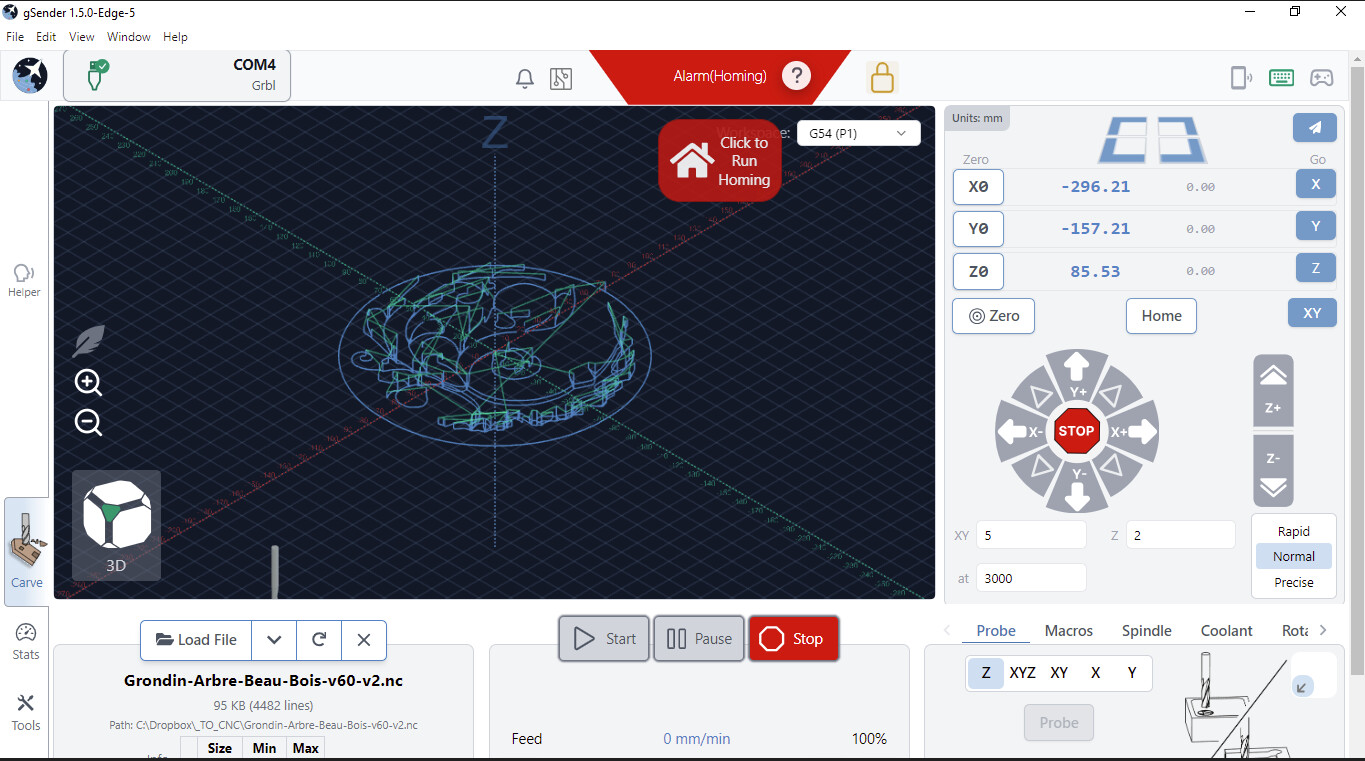

So…still no answer on the Home button?
Hi Martin, we’re looking into it, in the meantime you can try messing about with some settings, or send “$h” in the console and that’ll perform homing for you :+1:

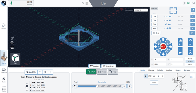

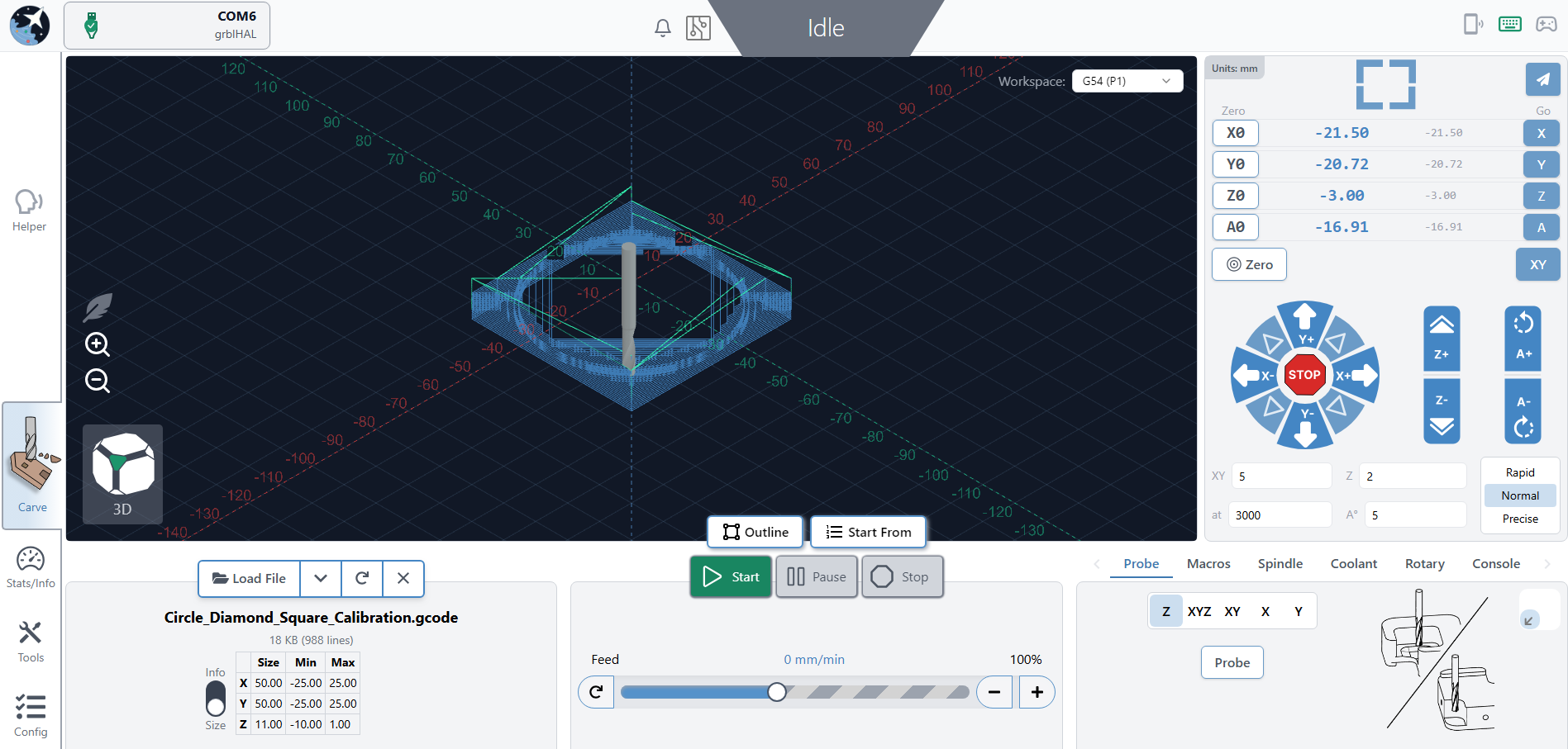

I tried this new Edge 4, and whilst I like the UI layout etc., there is an issue that bugs me. The UI is much, very much slower to respond than Live 1.4.11. It is most noticeable in watching command text appear in the console tab - it takes 8-10x longer than Live. Clicking a button like Flooding is such a long lag that (in a noisy workshop where I can’t hear the pump start) I end up re-clicking several times before I realise it is just very slow to respond visually.
I haven’t run a JOB as yet, the few things I was doing I didn’t want to risk using a beta app for, but the staple commands like Homing etc seem to work OK.
MacBook Pro Intel Core 7 3.2G, 16GB RAM, so not a ‘recent’ machine, but equally still fast. Controller is an up to date GrblHAL on Teensy 4.1 with BOB into a ShapeOKO 3XL with permanent 4th (rotary) axis
There was an event emitter leak in the visualizer that has been fixed - this should address the performance degradation on the carve page in the next build.

  • Fixed home button not showing when it should have been

  • Fixed visualizer unloading when swapping between tabs

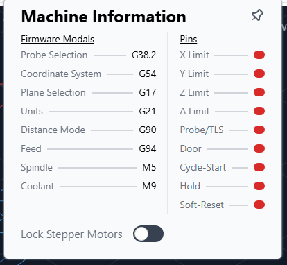

  • Lock Stepper Motor toggle has made a re-appearance in the Machine Information area

Confirm on my machine that the laggy/slow UI is now back to full speed. I noticed that the Z-axis jogging shortcuts are now missing - is that intentional (I hope not!)?
The Home button is back on 1.5.0 Edge 5 !!! (Just above the MOVE buttons)
At first, i was also looking for the UNLOCK button… But it was just above the Workspace Selector.
I can also confirm that the Visualiser now stays loaded even if you leave the “Carve” Tab.

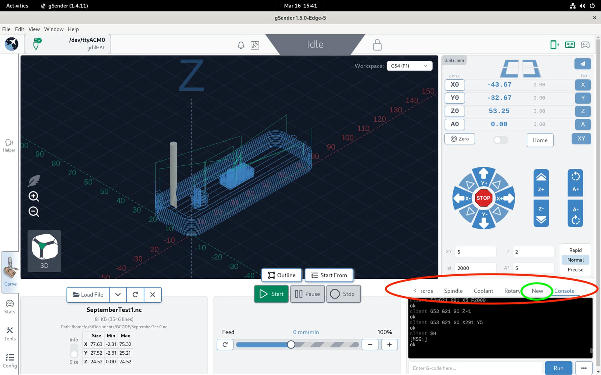

I had a chance to install Edge-5 and poke around while attached to my SLB-powered MilkCr8 CNC. First impression: I like what I see! It’s really come a long way. Today I just tested basic machine movement, and poked around the menus. Nothing blew up, so that’s great! I did have a few comments and one question.
  1. Is there (or will there be) the ability to “pop-out” a larger console window?
  2. There is an extraneous menu titled “new” in the lower-right area (with macros, console, etc.)
  3. I was pleased to see the issue (at least on Debian Linux) with the file open dialog hiding behind the main window has been resolved!
Pop-out console should return next build, it’s done but not quite in time to get merged in for Edge-5.
