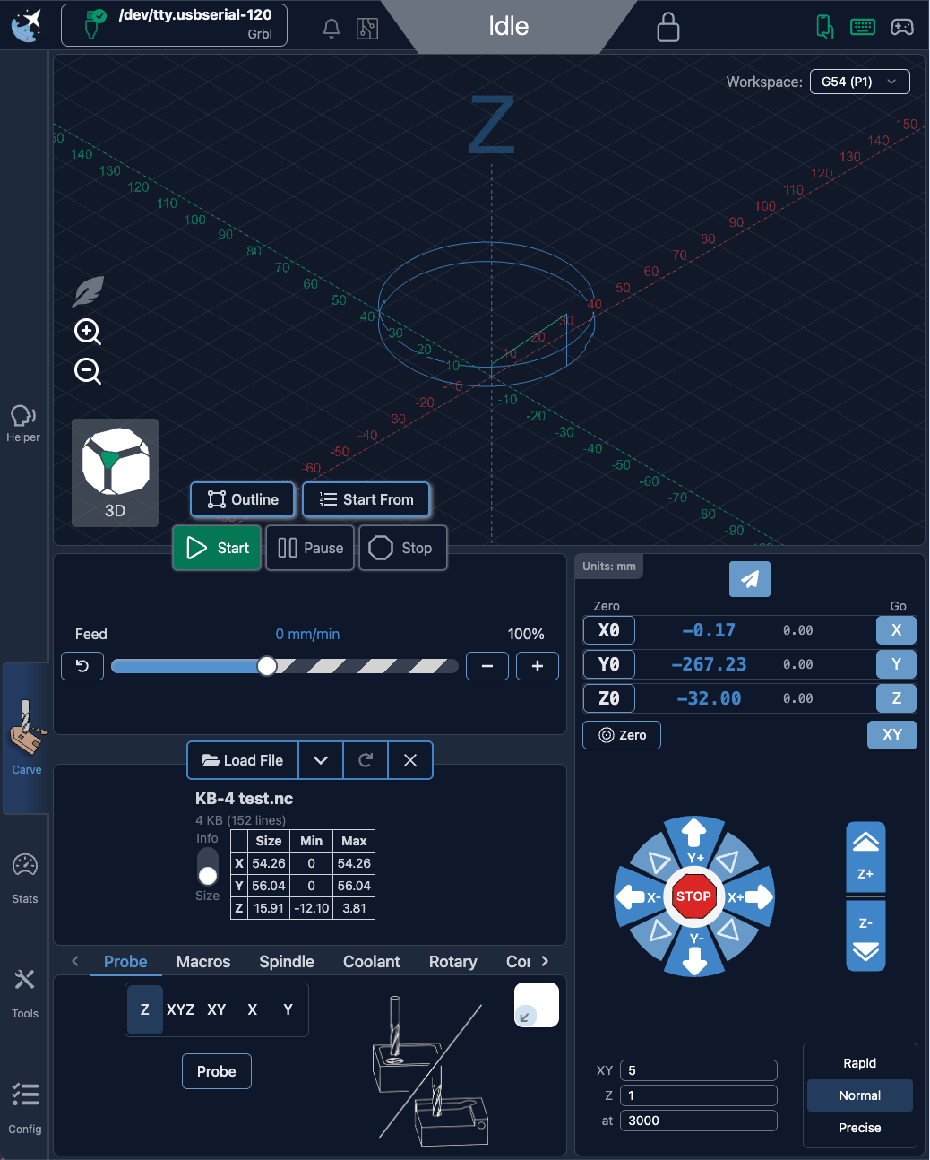

gSender 1.5.0-Edge-7 looks good at first glance, various UI improvements. Running on my house Mac (no CNC connection) so can’t do much beyond browse the UI and menus for now.
Opened a gcode file that has rotary (A-axis) and the visualiser has not populated - might be because I have no machine connected. However, a warning popped up saying ā€˜file contains Rotary, you must enable Rotary mode’ - I cannot do this, nor do I want to. My machine is permanent 4-axis, so there is no valid swapping of Y axis to perform A function - that would in fact be harmful to my machine.
[Edit: hadn’t noticed ā€˜feather mode’ in visualiser was on. Turned this off (greyed out) and the 3D file opened without giving the above mentioned error]

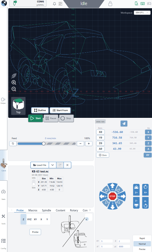

I will install this -7 Edge on my workshop Mac tomorrow and see if the same behaviour is there with the CNC connected (grblHAL, USB connect, Franken-OKO, permanent 4-axis XYYZA with proximity sensors on XYYZ and A, self-aligning YY during homing, spindle, coolant/mister)
@AndyCXL FWIW, I have the Vortex closed loop version on a Mk1 with the SLB. In gSender, I do not use rotary mode. I use 4 axis mode. Like yours, my machine has all 4 axes live all the time.

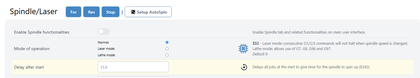

Does Edge have the ability to turn the spindle off when you pause a job? will the spindle startup again when the job is resumed
You can do this in Pause/Resume automations (in both Edge and main) with the caveat that pause events change pause behaviour (we can’t simply immediately feed hold because we need to be able to send the event code so it stops sending but completes the planning buffer vs holding immediately if there’s no event)

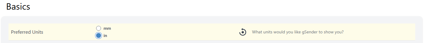

Maybe I am missing something. What is the reason that there is not a toggle switch to change between inches and mm on the main page where the visuzalizer and jog dials are? It seems that you still have to go to the settings page to do that.

Yes switching mm to inches is in the settings this is how we’ve always had it for gSender, is there a reason you’re thinking it makes more sense on the main page?

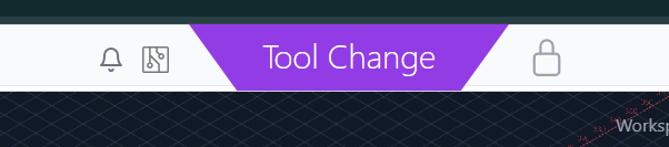

Tool Change fixes and alterations
  • Passthrough option works again
  • Skip Dialog option added to config and now skips pause modals on top of combining code blocks without a modal
  • Re-ordered strategies
  • Added Tool Change state to UI to match SLB LED

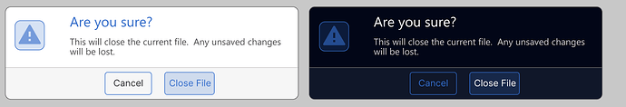

  • Close file no longer notifies twice

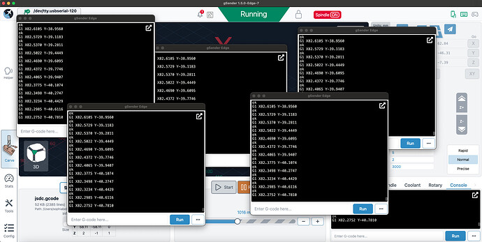

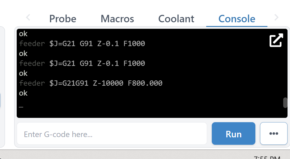

Huh, I have the opposite problem here: the jog input is so laggy it often thinks it should do a rapid when I only want a single click (e.g., manual probing). After crashing the tool into the workpiece on probe too many times I finally gave up and got the sensor probe working today. Hopefully the sensor logic is less non-deterministic…
Anyway, at least on precise jog it would be great if (a) gSender only ever emit single steps rather than continuous jog, and (b) if the output was formatted the same-ish in the console, and I guess included the continuous jog stop?

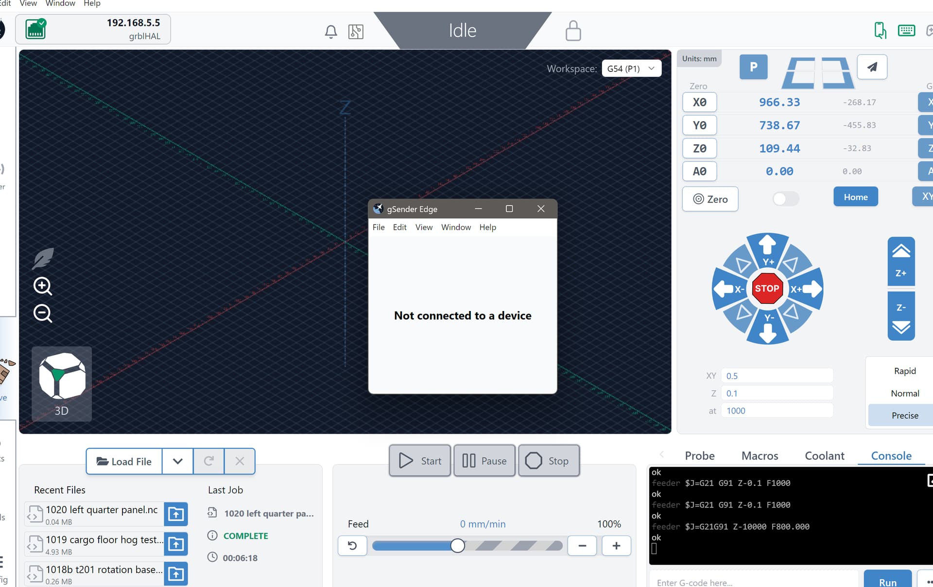

And while debugging all of this, the pop-out console in gSender 1.5.0 Edge-8 doesn’t seem to work here:
Not sure why the console window has the same menu bar as the whole app…
I’ve seen the same failing pop-out behavior with Edge-8 on Debian Linux.
