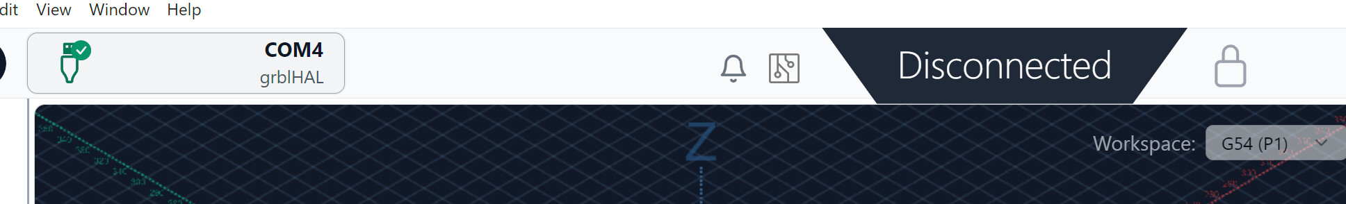

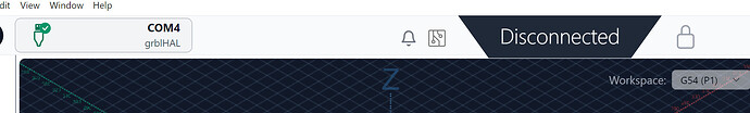

  6. If I switch the controller off while gSender is connected, the “status trapezoid” recognizes this and shows a state of Disconnected, but the connection
 menu thing still thinks it’s connected to the controller. I then have to disconnect my disconnected sender before I can reconnect it again. This seems to be the case independent of USB or Ethernet.

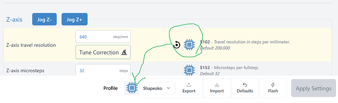

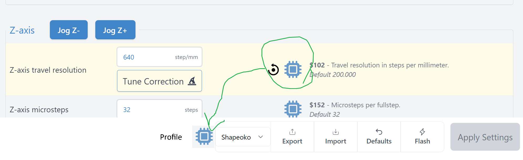

  8. Thank you for fixing the paper airplane button, it now opens the Go To Location flyout. Based on this, I might suggest to make the paper airplane button white, and the Go! button in the flyout “will do a physical thing” blue. Also dismissing the flyout without doing anything here has a bit of animation jank in the fade for some reason.
  9. The Non-default config toggle is great, but still shows a lot of grey (not “changed yellow”) sections. If the “chip” icon in the config list is intended to indicate a profile setting, it would be great if that were tied back to the profile selector to make it clearer that this is what’s going on.

  8. I like your suggestion of putting the chip at the bottom to tie them together, I’ll think about how we could make that work. I think the issue you’re seeing of grey sections showing ‘might’ be fixed on the next build, but if not then let me know that it’s still not working and I’ll see what else we might be overlooking.
