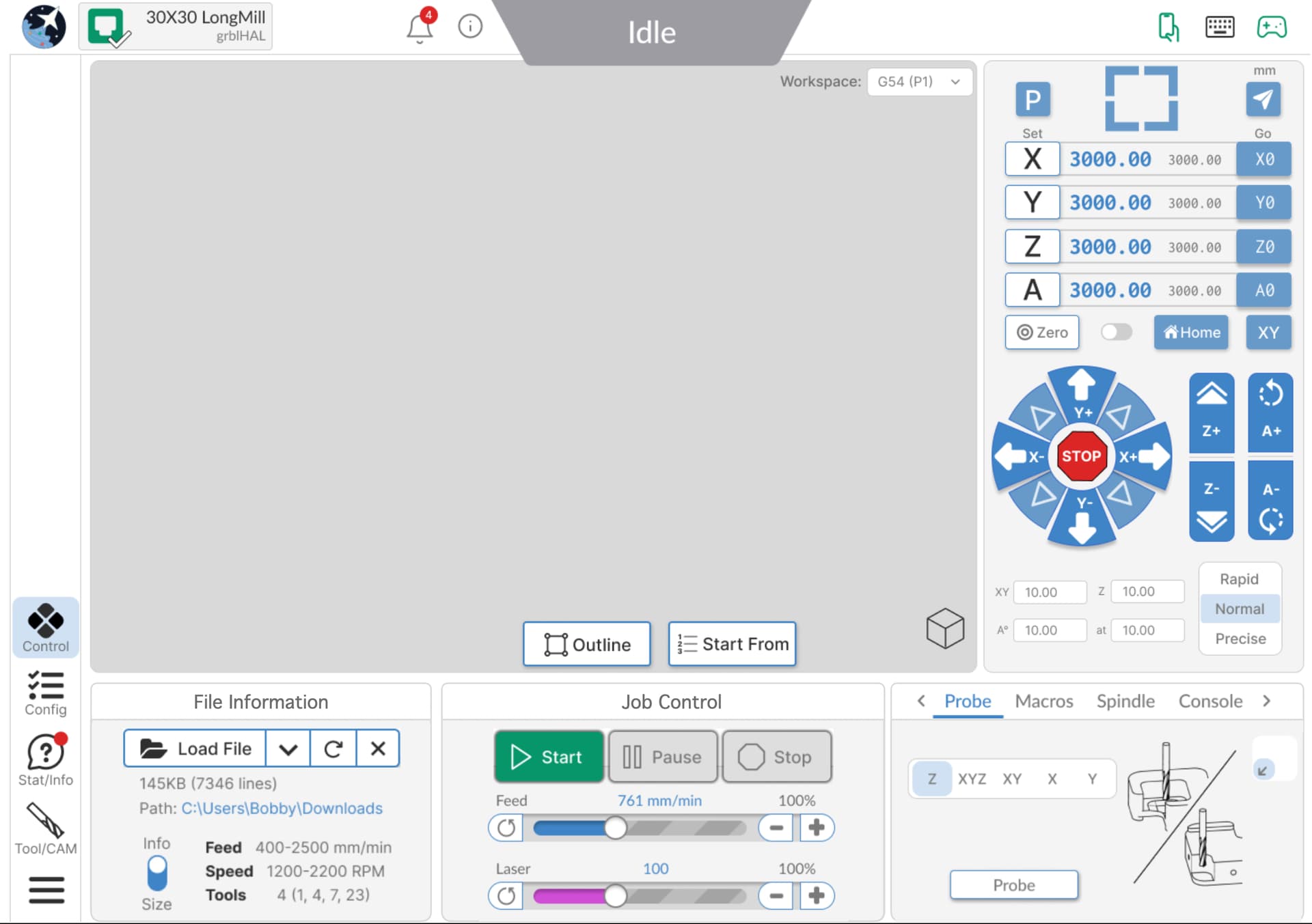

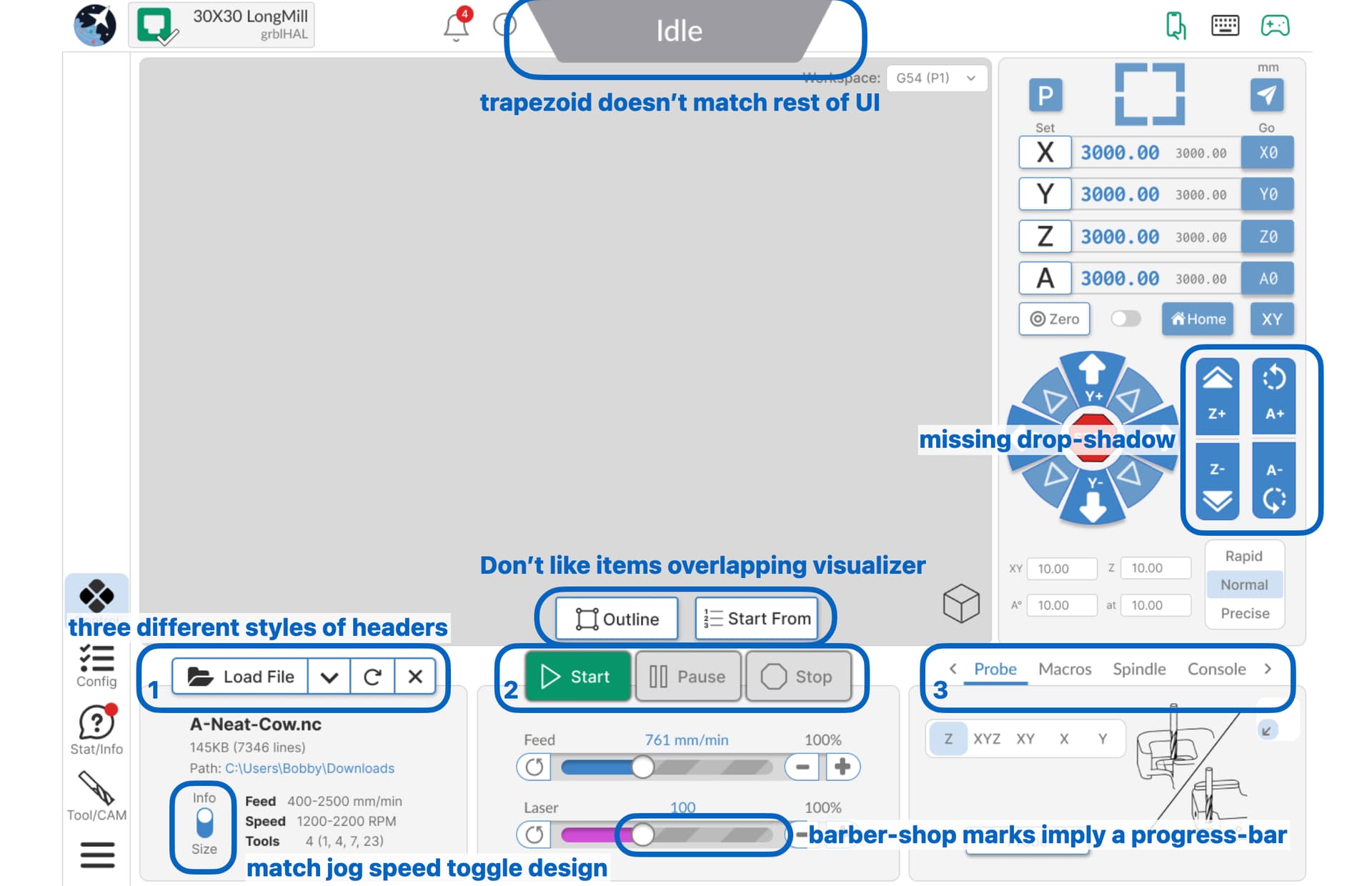

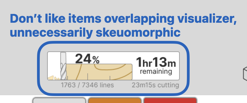

Here’s my feedback (annotated images as well):
• I really don’t like items overlapping the visualizer, and I’m not a fan of the ā€œprogress plywood.ā€
• The status trapezoid doesn’t really match any other icon, I’d make it a big rounded rectangle like other icons, or integrate with the machine box that says ā€œ30x30 Longmillā€
• The Z axis and A axis jogs are missing drop-shadow, but I imagine this is still a WIP.
• There’s three different style of headers - I think they’d benefit from more consistency. I also think headers 1 & 2 should be inside the boxes since they are controls within those sections, while header 3 selects between windows for that section. My 3rd image has an alternate concept (I recognize I cut off the file name, I would adjust box layout or shrink visualizer ever so slightly, I didn’t quite get the fonts right but hope you get the idea).
• I don’t like outline/start from sitting up in the visualizer, they seem more at home within File Info or Job Control.
• I think having probe, macros, spindle, and console all in one box is a lot. It could be possible to combine File Info & Job control (ensuring all controls are always accessible) to give space for another section (maybe even give the user customization over what items are in that box?
• For the info/size toggle, I’d try to match its style to the jog speed toggle.
• I don’t really like the feed override sliders, they look like progress bars. Maybe have some indicators for max/min to give a sense of scale? If you drag it around now you need to watch the percent value change, but you could put tick marks from 0-200% and make it like a thermometer.

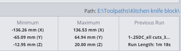

Is there a potential to have a small timer shown on the interface with the total run time?
I like that gsender tracks finished jobs to track maintenance schedules but it would be nice if this total time was seen without having to go look in menus for it.
Thanks for considering this thought.
@spcnc Are you looking for something other than the one that is there now? This screencap is what appears after every toolpath/file. You can see that there is a ā€œrun lengthā€ item
Plus., if you enable job end popup, you will get a popup showing the elapsed time of the job that you just ran.
The interface/home screen shows the run time for the current job.
WithIn the setting there is a ā€œJob Stats and Maintenance Remindersā€ screen. Each of the maintenance reminders have a total run time to the next maintenance.
What I was asking is for a clock with the cumulative run time of all previous projects since the last maintenance reminder was reset to remind about maintenance.
Interesting idea, I’ll note it down @spcnc
