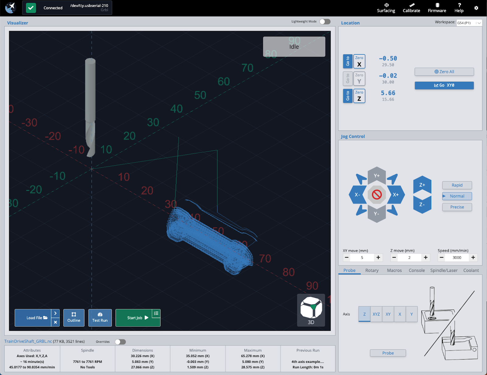

Fantastic!! Will download and start testing.
For the log, my hardware is:
  • ShapeOKO 3XL with HDZ upgrade, inductive proximity sensors
  • Teensy 4.1 on Phil Barret’s break-out board
  • Self-made rotary 1.8deg/6:1 belt/Rotary axis (identical to the Sienci proposed setup)
Grbl HAL 1.1f configured with
  • XYZYA (5 axes, with Y ‘ganged’)
  • Inductive proximity sensors on X, Y, Z and A to permit homing
  • Homing and Soft limits enabled
  • Considering dual-Y sensors with Auto-Square (have the bits, but yet to be installed)
$I+ report
[VER:1.1f.20220325:ACC/HALTEENSY4.1]
[OPT:VNMSL2,71,1024,4,0]
[NEWOPT:ENUMS,RT+,HOME,ES,TC,SED]
[FIRMWARE:grblHAL]
[NVS STORAGE:*FLASH]
[DRIVER:iMXRT1062]
[DRIVER VERSION:220325]
[DRIVER OPTIONS:USB.2]
[BOARD:T41U5XBB]
[AUX IO:4,3,0,0]
gSender running on Apple Mac Catalina (MacBook Air 11, Intel i7, 4GB, Intel 3000 graphics with 384MB)
Principal linear project CAD/CAM: Autodesk Fusion 360 on Apple, with Neil Ferreri’s PP with tweaks
Principal rotary project CAD/CAM: Vectric VCarve Pro on Apple, with Neil Ferreri’s PP with tweaks (iMac Intel Xeon, 32GB, Radeon Pro with VMware Fusion running Windows 11 X64, also MacBook Pro M1-Max 32GB with VM Fusion running Windows 11 ARM)
First test results:
  • Install .dmg - success, however first run froze at splash, force-quit and re-run snapped into life. Saw the same ‘first freeze then OK’ on iMac/Intel Ventura 13.2.1
  • Select Connect HAL machine, connected first time and recognised the HAL welcome signature - success
  • Import settings - failed, but a different list of parameters might be the root of this. Set my defaults by hand and all good. Noticed new entries for Rotary axis in shortcuts.
  • Check machine dimensions correctly read from GrblHAL - success
  • Import macros - success
  • Open linear (XYZ file), check visualiser - success
  • Open rotary (XZA file), check visualiser - partial success. Large dimension file not showing full model. Smaller dimension gcode version of same CAD model shows in full. Some sort of clipping seems to affect the larger dimension visual (I can provide zips of both if requested)
3D Large Finish 8thBN.gcode.zip (434.0 KB)
3D Small Finish 16thBN.gcode.zip (160.3 KB)
  • Home machine (XYZ) - success
  • Home rotary (A, using my $HA macro) - success
  • Move rotary and set zero using Rotary tab - success
  • Move rotary and Goto Zero using rotary tab - success
  • There is no ‘Home Rotary’ function (not presumed to be a feature of the plain vanilla rotary machine? Would be nice if this were a setup option to enable if hardware supports it) EDIT re-running this over lunch, it seems I didn’t get the full screen layout on the first run
 Now there is a quad of homing icons XYZ and A, all of which work - success
  • Noticed very right side of screen is ‘off screen’ even in full-screen mode. Screen is 1366x768 MacBook Air 11”, 4GB RAM, 384MB graphics Intel HD “3000”
  • Move rotary and check stats show position on Rotary tab - success
  • Run linear air job (same as used above) - success, including starting spindle (VFD analogue not ModBus)
  • Run rotary air job (small file used above) - success. X, Z and A moving, Y not moving - which is correct
Not tested - turning on ‘Rotary Mode’ in rotary tab, as I believe this hijacks the Y axis, if I have read the story of development so far, and my machine has a permanent rotary/A and doesn’t need this (nor do I want $ settings being made accordingly - however, having the various testing function available for permanent rotary setups could be useful)
Still to test: Surfacing function, probe function, checking other rotary gcode files to see if any common factor exists behind the clipping noted above
Observations:
  • Some issues with importing defaults, but I think I have seen this before with the ‘live’ gSender import/export and it looks like the same code has carried over to this Alpha (not sure if this is a bug, or a deliberate ‘JSON is different’ protection choice)
  • Rotary tab ‘arrow’ icons do not easily convey movement direction, might be better if the arrows were curved to indicate forward (top fwd) or backward rotation
  • In surfacing tool ‘widget’, cut depth field defaults to 1mm. Editing this by overtyping results in field value flipping to 0.001 and no attempt at overtyping differs from this. The only way to choose, say 0.5mm, is to select only the first 0 after the decimal point and overtype just that one character
  • In surfacing tool ‘widget’, there is no ‘depth per pass’ option. Maybe it is not required, but equally it is not obvious that what is set will be a single pass - reading the gcode ‘layer comments’ suggests the author expected multiple passes to be possible
  • $$ console command to show all $ settings does not include A axis (103, 113, 123), whereas ‘live’ and ‘edge’ do show these
  • Keyboard shortcuts for A+ and A- jogging don’t appear to be working. I have a self-made jog-dial pendant that emulates a keyboard and sends these shortcuts and all work except A+ and A-. Manually typing them doesn’t work either. Works in ‘live’ and ‘edge’
  • Home ‘all’, equivalent to Grbl command $H is not an available icon any more. It is in ‘live’ and ‘edge’, and its absence is not ideal for me. I do like the separate X,Y,Z and A homing buttons, but I would prefer to retain the ‘home all’ too.
A very promising start, and nothing I would call blocking or serious found to date. It is worth noting that I have been using gSender ‘live’ and ‘edge’ with my HAL installation for a good while, and aside from the connect signature recognition (corrected in this Alpha) and the keyboard shortcuts on A, there have been no real issues.
