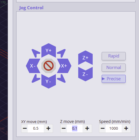

GSender jog goes fast baby, real fast
Which is a good thing with my brand new Altmill. But how do I make it jog slow?
I can use the incremental precise or normal buttons, but can’t I also set 3 different jog speeds?

Hi Rob,
I zero my Z mostly using a light behind the bit and creap down. I am still using an old render of g-sender and I can type in how large a single step is on every axis. I bet that function is still there in newer versions and if not, that’s a shame.
Whatever you type in the lower boxes, will be your new step size.

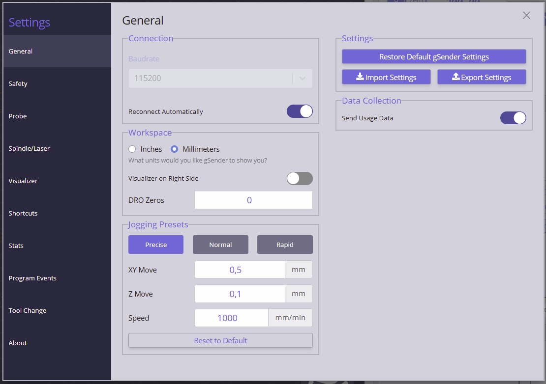

To adjust the speed settings:
Yeah it’s still there. I just did it, and you know what?
I’ll just do things a little different than I used to.
Let’s call this solved.
