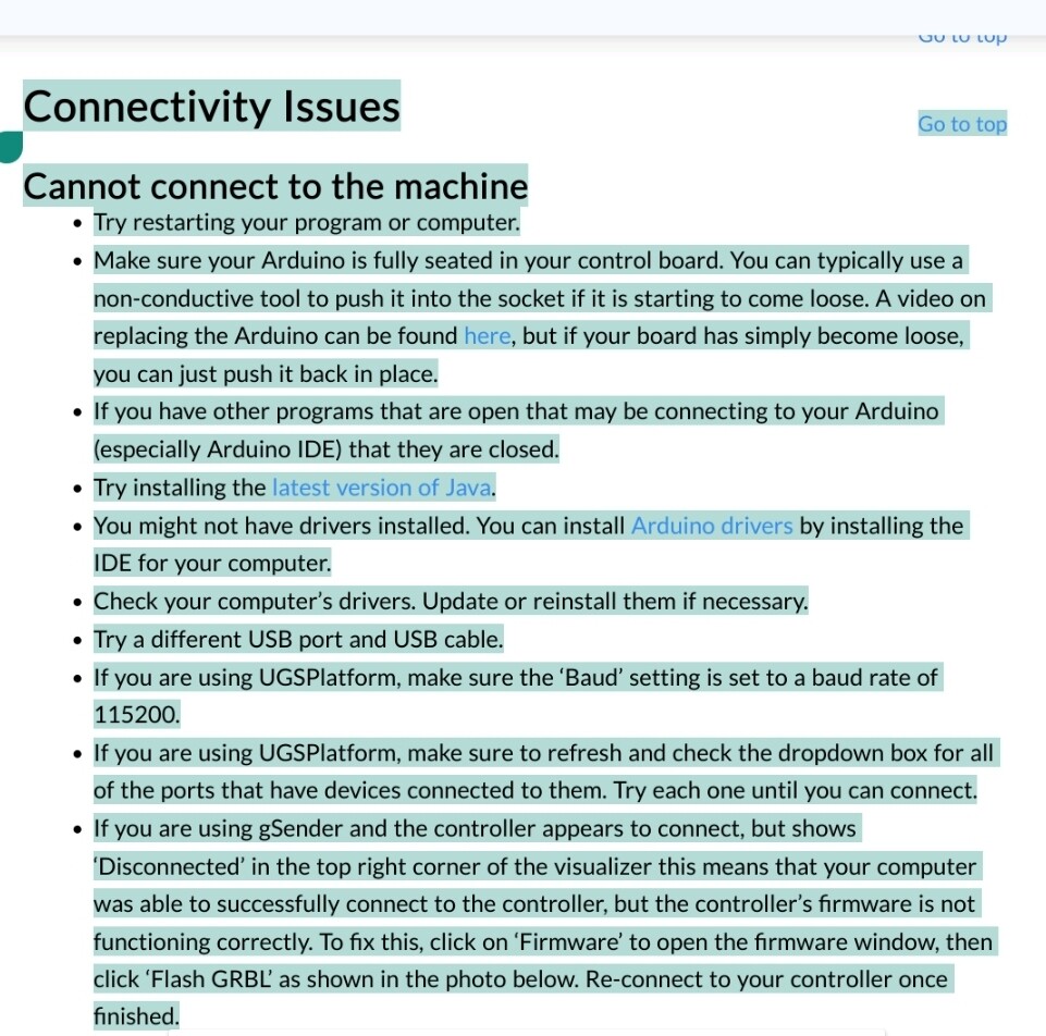

Everything worked fine a few days ago. Went to use it yesterday and it cant find my port that my longmill is connected to so i can’t connect. I dont know if it is the computer or gsender or the arduino board. I dont know were to start to fix the problem. Any help would be appreciated. TIA
A good place to start is checking of the solutions on the fixes page sienci hosts.
@Djohn If you are running Windows, if I were you, I would start by seeing if windows sees the com port in device manager. If it does, you can look at what @Spamming_Eddie suggests. if it does not, the issue is not gSender related.

Are you running the Long Board or the SLB?
If you are running the long board, I would ensure that the Uno is firmly seated on the board. If that is not the issue, I would suggest that you load the arduino drivers from here
https://docs.arduino.cc/tutorials/generic/DriverInstallation/
Windows should do this automatically, but sometimes things glitch.
