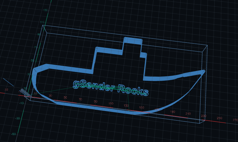

This is a extremely basic demo plugin I made to test out the system implementation. It’s a very basic CAM tool - that lets you easily configure and generate a toolpath for a sign to cut.
After setting up your CNC, there is a large context switch for new users to have to design something to carve, export it, open it and setup to carve. This is meant to close that gap - what if you could easily design something quick and easy to carve at the press of a few buttons within gSender without that context switch.
3d Printing has Benchy, this has Sienchy.
This is a very good option if you want to test how plugin install works in gSender.
Usage
Most of this should be pretty intuitive, you can type specific values but the default buttons are generally easy enough to use - pick a shape, font, text, carving options, setup and move your tabs and you’re good.
Here’s a guided process of my making by boat - ready to carve in 30 seconds:
