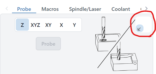

@webbit_NJ it’ll now help even more that for a while now, gSender has had the feature built-in to rotate the corner you want to use your touch plate on so that it’s more versatile for different setups, just click this button here!
