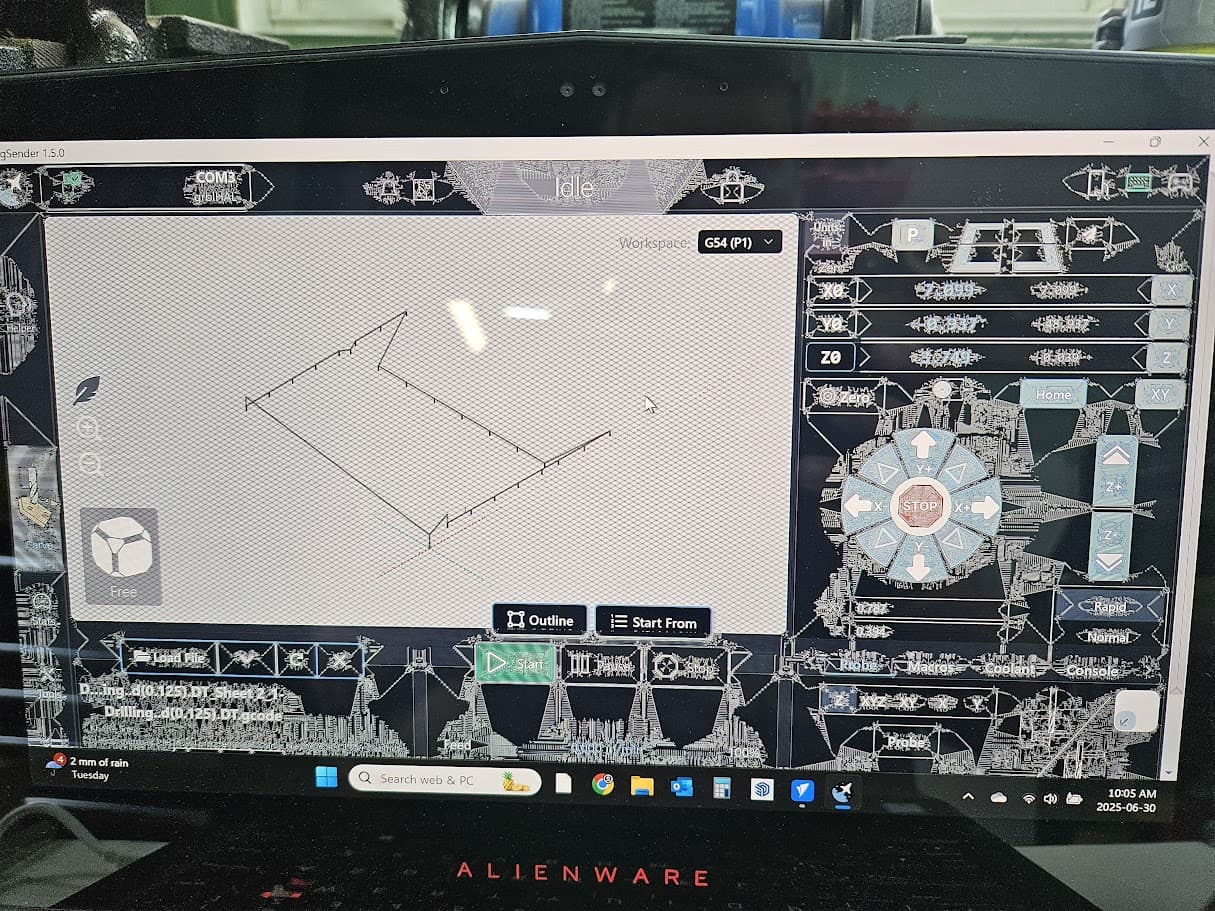

Does anyone else see this video refresh issue in GSender 1.5? It was also doing it in 1.4, but not as severely as this. I’m using an older Dell Alienware I7 laptop. All my drivers are up to date with Windows 11 Home edition. No other software on this laptop is doing this issue.
This looks to be an Electron specific issue related to hardware acceleration - most of the instances I see seem to be related specifically to VsCode, Postman, and Slack, other commonly used Electron app.
https://stackoverflow.com/questions/60015048/electron-apps-weird-graphical-artifacts-glitch
Past updating your drivers, we’d need to look at making a way for you to disable hardware acceleration, which would have knock-on effects of making the visualizer unusable.

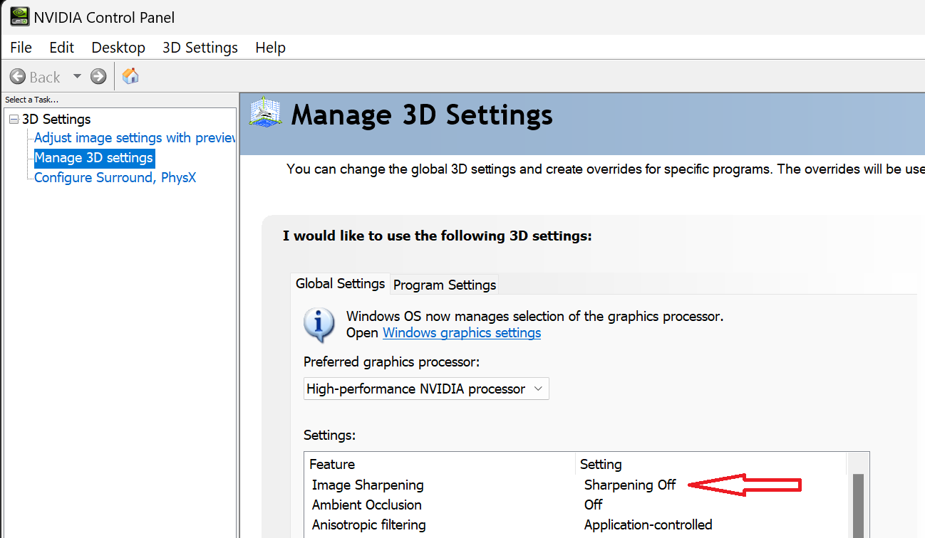

Thank you for your reply. I followed the link you provided and found this procedure. It seems to have fixed the issue:
Just for future reference, if you happen to have this problem and you’re running an Nvidia GPU, go to the Control Panel → Manage 3D settings and either 1) look for Image Sharpening in the Global Settings tab and turn it off,
I hope this helps the next person who comes across this issue.
