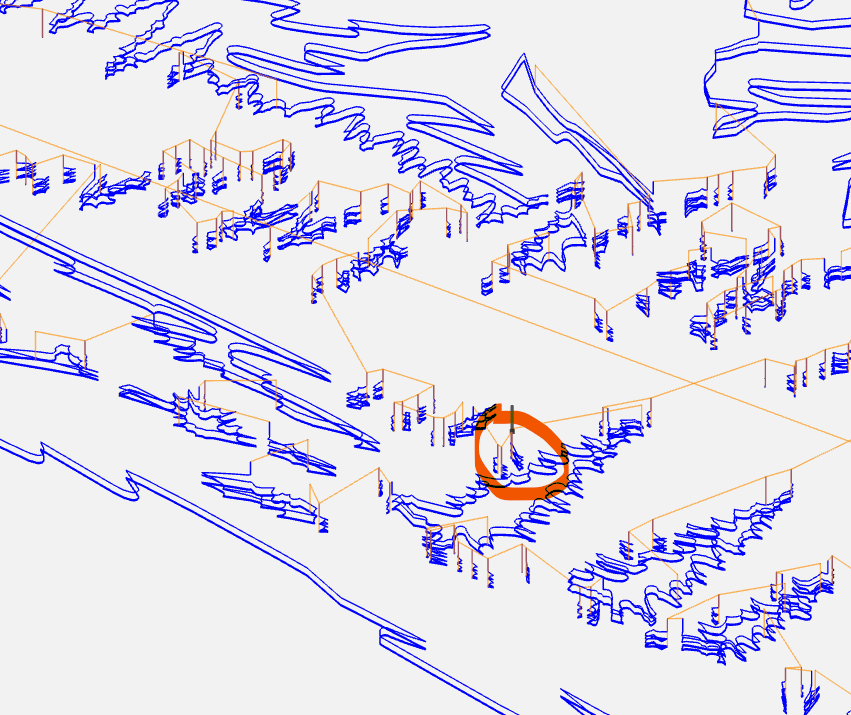

Gsender unable to progress past specific code line

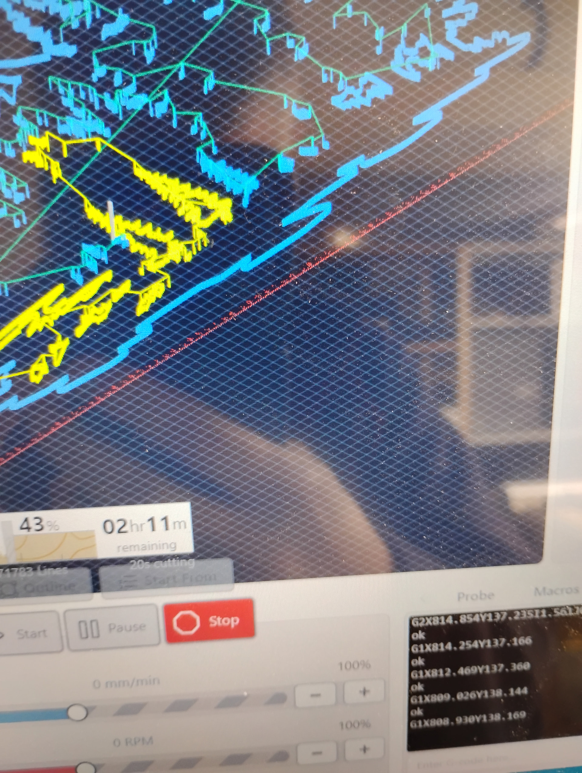

Ran it twice. Seems to stop almost at the same location.

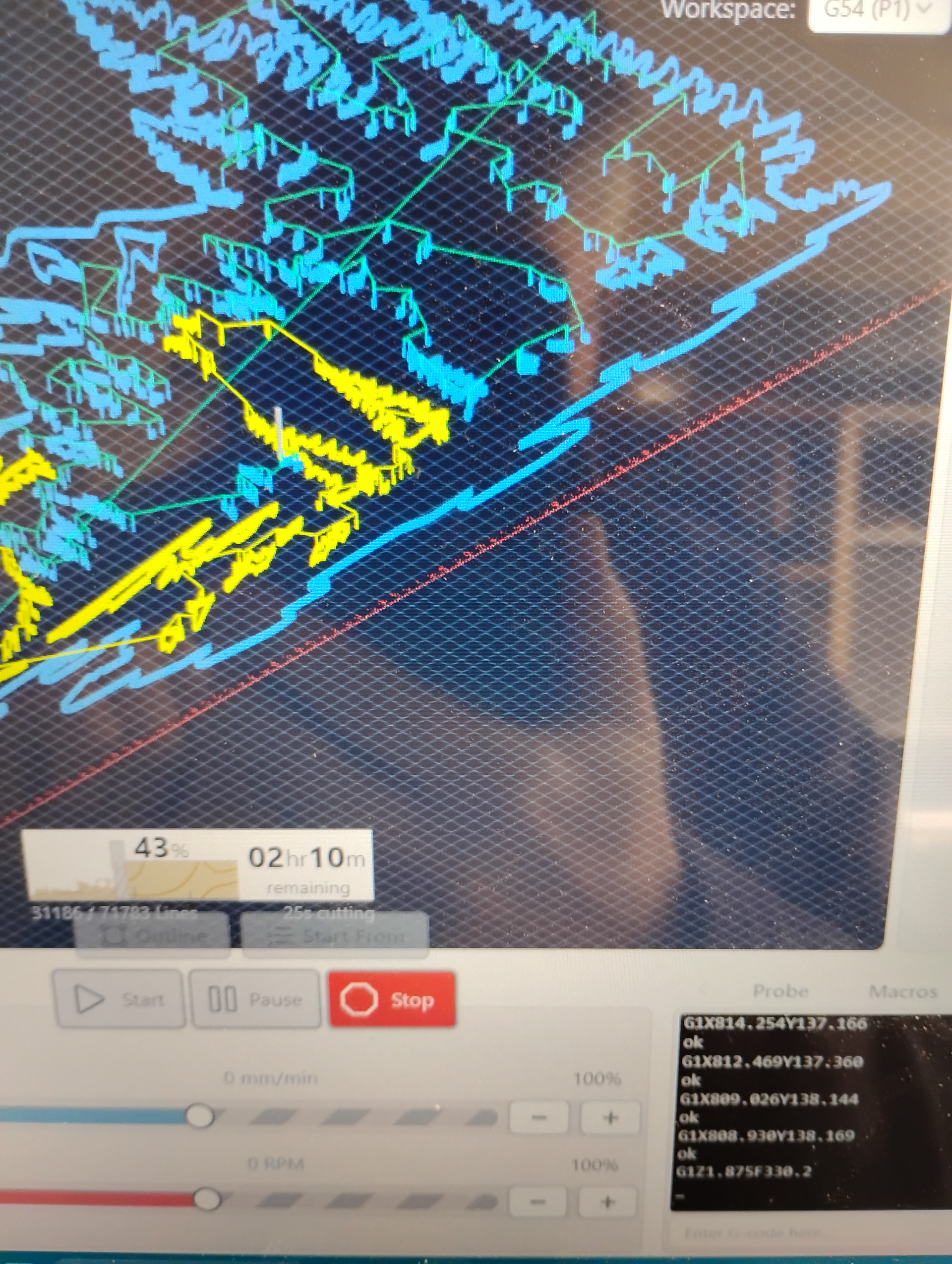

@Greener @gwilki Nope, same thing. Although I think it said line 31198 for the resume this time

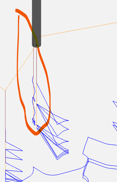

This was an interesting problem. After downloading the file and running it on my 4x4 Altmill, it stopped right in the same place as you said. I looked at the code and agree with the others that its not a code problem. I know I always shake things up a bit on the forums because my solutions seem unusual lol. When I first opened up your file I noticed that your bit was set up in inches but your project was set up in millimeters. I know this shouldn’t matter but when I checked the exact spot which was causing the hold up I noticed it was a very small even sliver like cut.
So what i did was simply change the job to inches and re-calculate and it worked perfectly. I know this shouldn’t matter but I was thinking because the cut was so small gSender might be having trouble trying to convert an infinite number. Either way for me the job ran great after that tweak.
@Karver_One Good work. There probably is a small movement that simply can’t be handled properly.

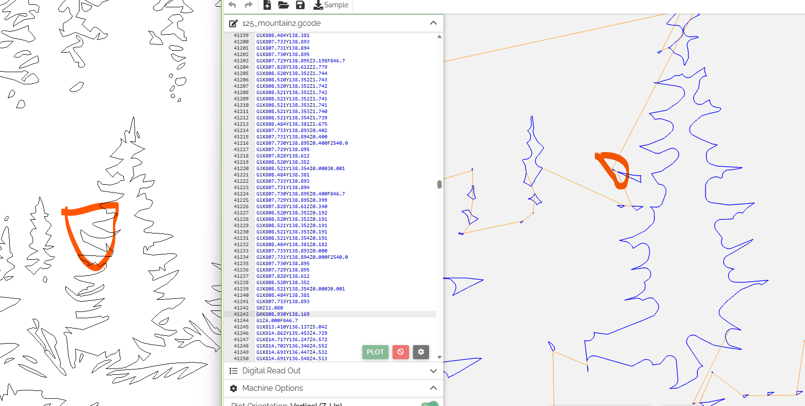

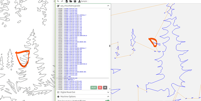

I edited @gwilki 's second file (which I confirmed I wasn’t able to run), and removed lines 41180 to 41243. That’s an almost vertical cut with very small XY movement.
No problem running it after that.

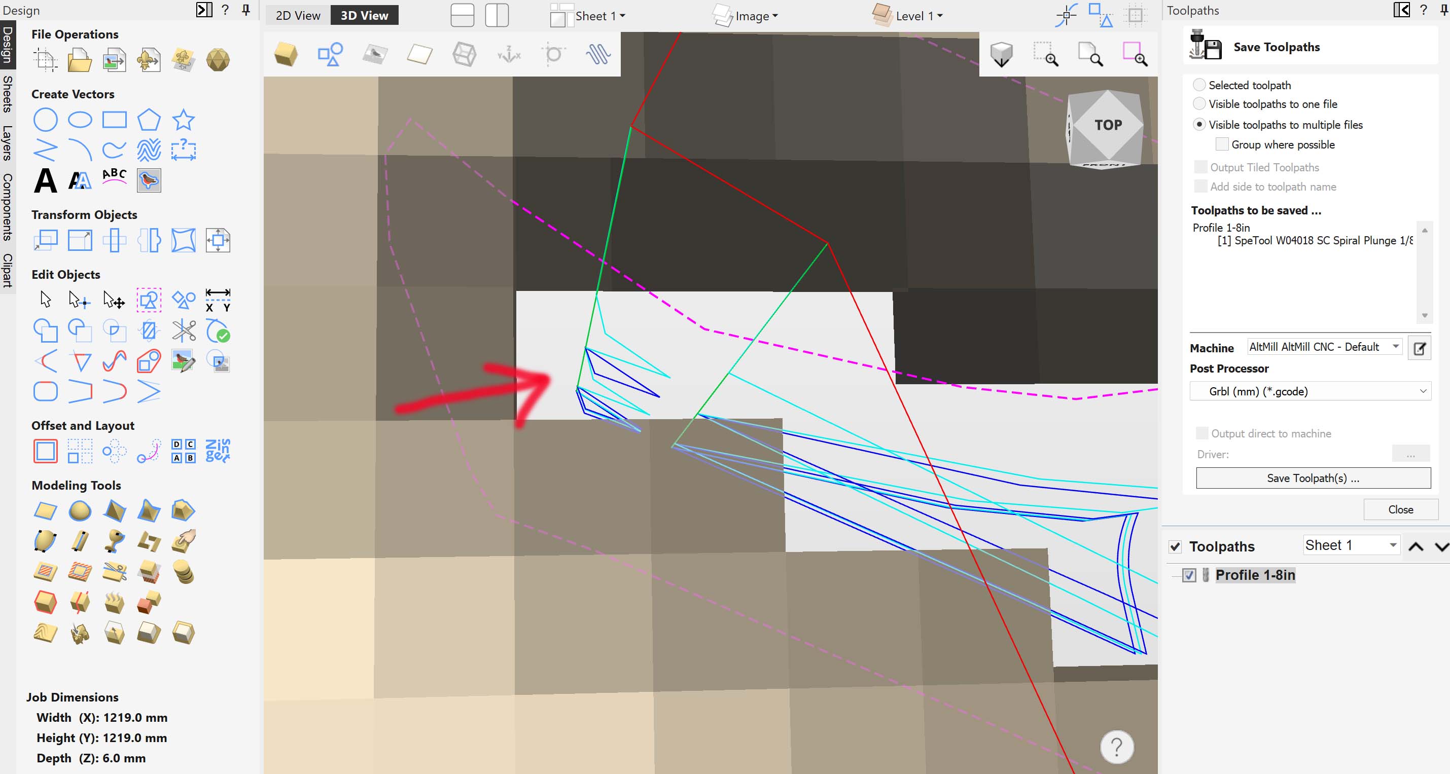

@Greener If you delete those vectors from the Vectric file, the g-code you generate should be good.
@Greener Scratch that. Those aren’t stand-alone vectors in the original file. The small cuts were likely created because the tool you are using is too big.
So just for kicks, I ran the 1/16" g-code file that you provided and it runs fine. It does not contain that small movement
