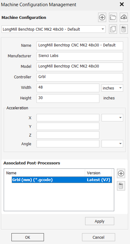

@Greener What post processor are you using in the CAM application to create the gcode?
Using vectric v carve. I believe this is the info that you’re looking for but I could be wrong. I did recall seeing some issues related with inches post processor and it looks to me like I’ve got it set up for mm.
@Greener That is the correct PP for your machine.

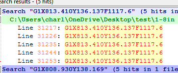

@Greener I can’t find G1Z1.875F330.2 in the 1/8" g-code file. The one just before that is found in multiple places. Can you upload the actual g-code file that you used? It might be more useful than the vCarve file.
FYI, Notepad++ is likely more useful than Notepad to analyze a text file.
1-8in Profile cut.gcode (1.6 MB)
I will check out notepad++, can’t say I’ve often had to really analyze text files all too often and if that’s in the cards it’s often outside my skill set and understanding lol. Attached the file that I used.
@Greener Notepad++ is free and well known. And it will display line numbers, which is useful when referencing, well, line numbers.
@Greener @Chucky_ott Tks for the pic. It makes sense now. I didn’t understand that you were not running all those toolpaths. I couldn’t figure out why you were not just doing it with the 1/8" mill.
I took your gcode and found in notepad++ that there are 537 instances of that line in the file. Why one of them would cause the file to stop is a question beyond my meagre knowledge base.
I’m sorry that I can’t be of any help.
@Greener Much better. That file has 537 entries with that line :frowning:
But
G1X808.930Y138.169
G1Z1.875F330.2
are at lines 31233 and 31234 respectively
Line 31235 is
G1X813.410Y136.137F1117.6
which doesn’t seem to be a problem to me, especially since it exists in 2 other locations before that line number.

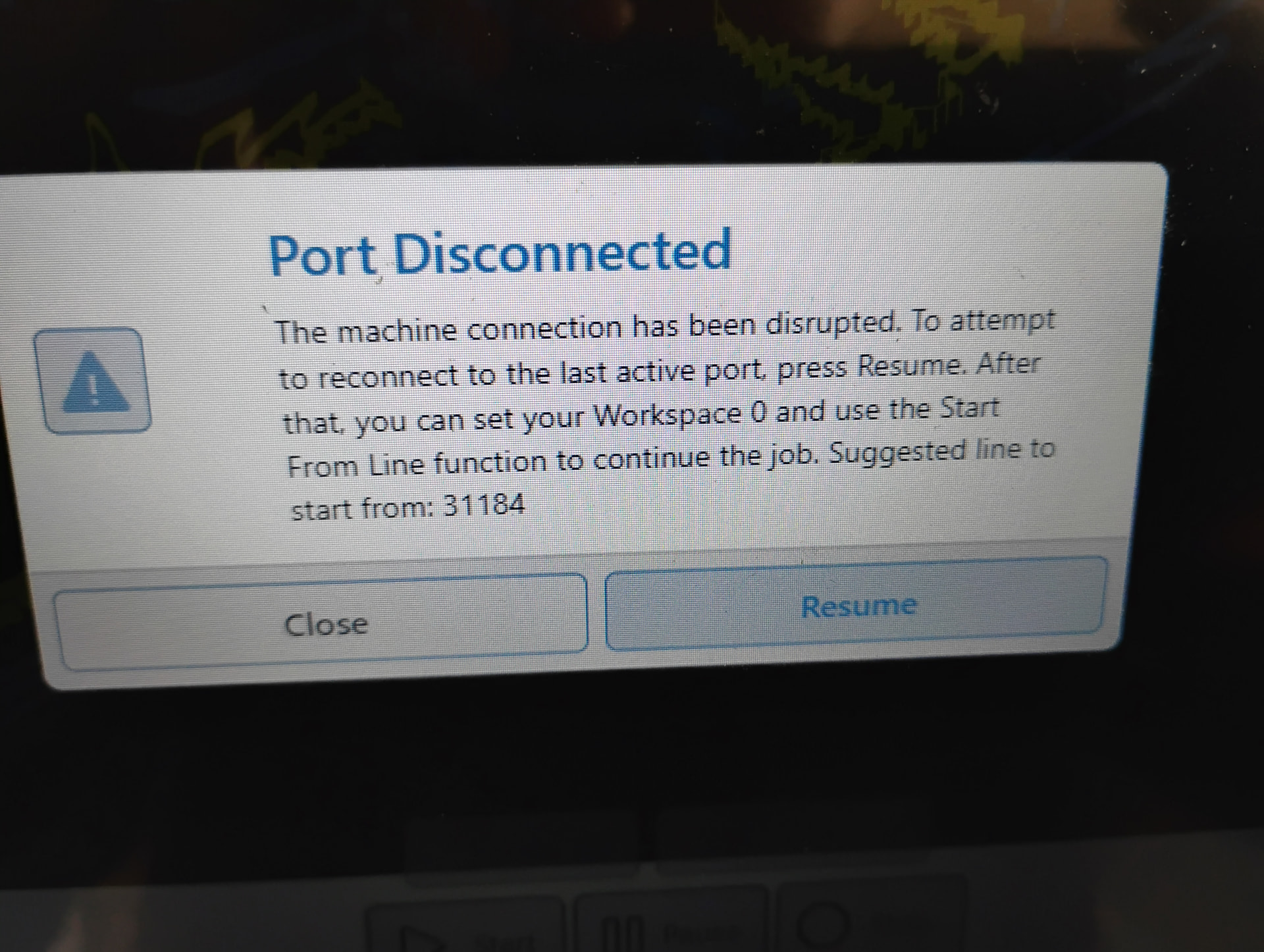

@Greener I just enabled that option on my Altmill. Seemed to run fine but then stalled. Finally got a " Port disconnected" error with a start from line 31184.
And only way to reconnect gSender was to power cycle my SLB.
